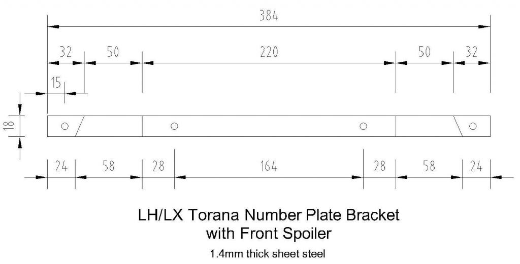

OK, here goes my contribution for 2013.
After seeing a number of different methods of mounting the front number plate with a front spoiler, I've measured and included here John Wilson's bracket. The new spoiler that I bought, I chose to fill the hole up, so have included a picture of another front spoiler destined for Yella (a work in progress) to show you where the holes are located in the spoiler. Enjoy.
Apologies in advance for a post of substance. Hope it is of use.
Rana on!

Yella, I have been making and selling these for years now, but as per the originals

Cool, good to see one fitted. Someone just asked once, and I promised to measure and draw it up. Just delivering on that promise.
The slots look good. How much you selling them for Red? Would prolly be heaps easier than making one up.

Mmm, since I have two, I might just drill another hole and cut the slot. Don't know what I will do with the older looking one. Spare.

looks like a good fit i got a number plate bracket of a gemini and mounted it hanging from the bumper so it doesnt touch any paintwork

Why can't you use the original plate mounts on the nose cone??
#16 _trna76hb_
_trna76hb_
Posted 13 January 2013 - 04:52 PM
As the number plate tabs get bent back or cut off to fit the spoiler
Ian
#17 _Yella Fella_
_Yella Fella_
Posted 13 January 2013 - 08:04 PM
^ Normally just bent back.

I do have the dimensions for the bracket somewhere on my pc I could supply you. Might be quicker to make it up yourself.

I'd guess that this is the image that Brad is talking about...
Number-Plate-Bracket-Model-zpsb86bc47c.j
I'm sure it came from this forum but I can't remember who to credit for it... so thanks to whoever created/posted it originally!
#25 hanra
  • 10,832 posts
Posted 11 July 2020 - 09:56 AM
That’s the one! Cheers.
