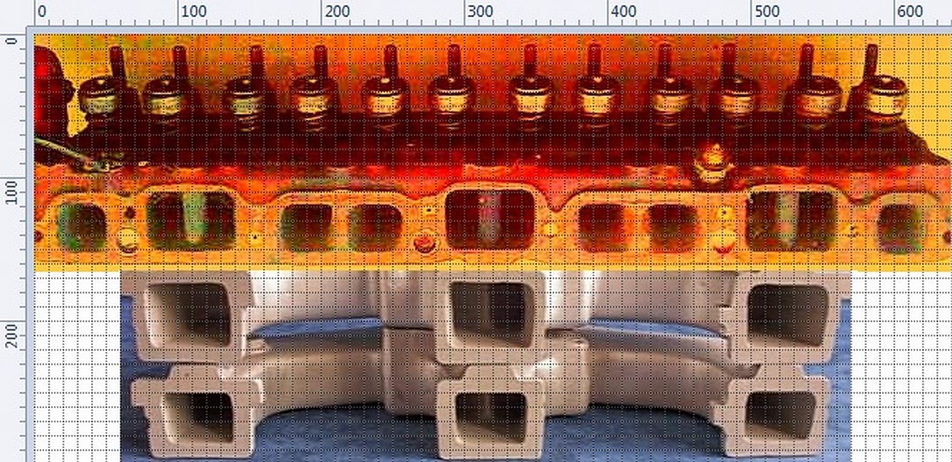

The new set-up will be the wildest from 44cc to possibly 31cc chamber later to create 14:1 compression on E85:-
http://www.gmh-toran...ng/#entry895204

Have you had that head on a flow bench yet Dave?
#36 N/A-PWR
  • 9,650 posts
Posted 14 April 2016 - 10:24 AM
As soon as she gets polished up DJ,
 I promise to have her tested Mate. :)
