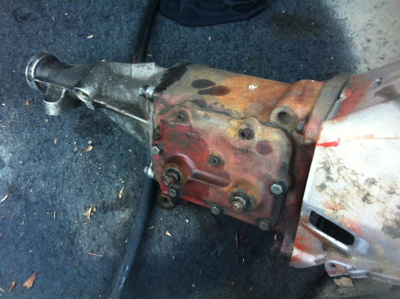

Pic of box would be good?

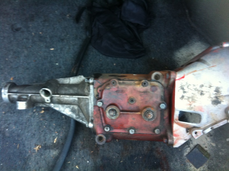

here a pic of the box
https://cache.gmh-to...zps397bfb8e.jpg
https://cache.gmh-to...zpsc1f7d93b.jpg
#33 TerrA LX
Posted 18 March 2013 - 07:02 PM
Looks like an aussie box to me.

Yep, it's an Aussie M15, it didn't originally come in HRs.

Probably an old HK or HT box too, not sure when the smooth case finished. If the box is OK it is a good one to use too as you'll be turfing the input shaft and cover for hopefully a later neoprene seal style, those early ones are a PINA as when you park on a steep hill nose down they spew oil out the front seal.
