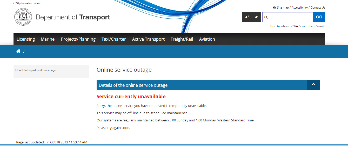

Tried to get a permit to take her for a bit of a spin but....
So, took her for a quick spin round the um...back yard, and very happy.
