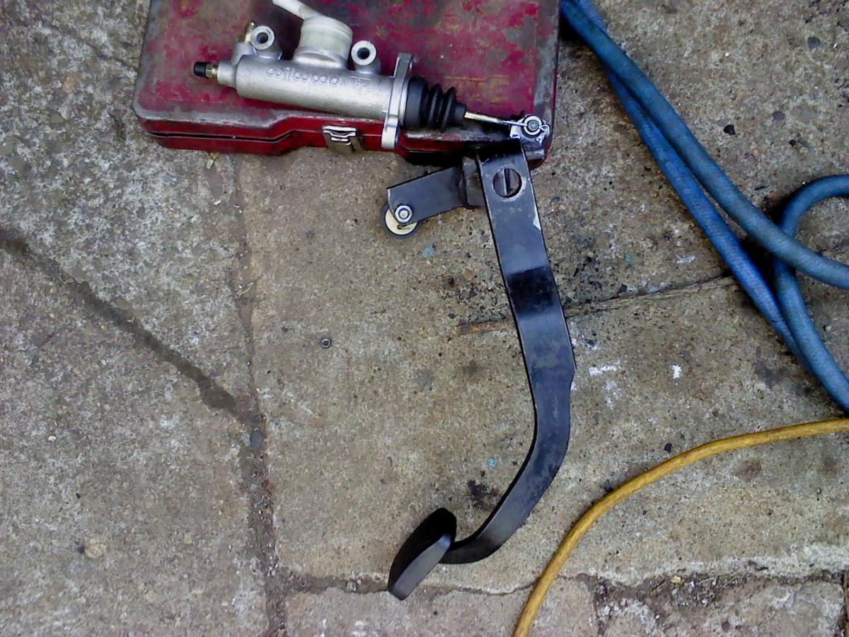

Yeah I wanna do it under the dash using that Wilwood master - I know that the 3/4" master that came with the box is the perfect unit, but I need to convert it to suit a remote setup (with the hose coming into the top) and don't want to buy the whole kit just for that one bloody part.  :mellow:
nemo355v8 has paved the way on this one.

http://www.summitrac...s/wil-260-10264
No need to buy the entire kit.. :)

I actually had went into the shed to look because I thought I had a spare myself I was going to offer you (I gotta post a little box over to my mate in a week or so anyways) I couldn't find the one I thought I had, so dug up the link instead. (I had ended up with a wilwood master cylinder like that in with a bunch of other junk I had bought somewhere or other.)
I used a factory late Camaro reservoir on mine btw...mounted nice and all.

Heath I just used a BA Falcon master cylinder assembly, all mounted under the dash. Used the late commodore reservoir on the engine bay side. It was a simple conversion and the clutch is very progressive and light. I have concentric throw out bearing also

Hi Heath, i made up my own under dash clutch cylinder using a toyota cylinder on my lx gtr hatch build.
There are a few pictures about 1/3 of the page down on how i done it which help with a few ideas on how to mount yours.
