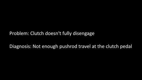

I cheated with the master cylinder Heath. I removed the peddle assemble from the BA peddle box. It was an easy fit to the Tornana and only had to extend the length of the pedal to line up with the brake pedal. As you say it light because I extended it giving more leverage, but I knew the ratio would be right because its sized to the concentric bearing system. Take up point is 60-70% of the travel from the floor(perfect).

Thanks Lenny. The pedal weight basically just ~ comes down to pedal ratios and master size. If you used a really long stroke you could make it feel a bit lighter.
By shear coincidence the lads at BOM have just tackled their version of this problem in the latest installment of Project Binky... with a uniquely "Nick" solution!

Andrew, I did watch that latest episode of Project Binky - one of very few forms of mental relief at the moment hahaha. I must admit I have not yet studied what Nik did there, it gave me a huge laugh but I had my own mechanical problems sucking up my attention so I didn't spend more time on it. I cannot quite understand if you have the same pedal movement and need the same hydraulic effort (displacement + pressure) how you can radically lighten the pedal input, unless you're playing with the curve so it has better leverage where the pressure plate needs the most force applied. I need to study it more or have someone explain that to me.
