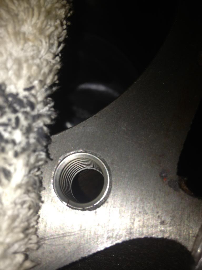

that looks like a broken heli coil in the bottom section of that hole to me.

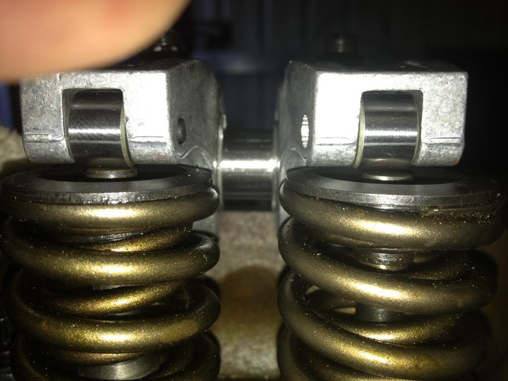

Thx for all the replys guys it has been really helpful, just a quick update on the issue. The thread dmg was from previous builders but my bad in not noticing it b4 hand. There was no sign of thread material on the head bolt once i pulled it back out and my diagnosis is that it was a helicoil that wasnt installed properly. Anyway i put a new 1 in and the head torqued up ok, so cool bannanas!
Although threww my new adjustable street terra rockers on and the clearence between the spring retainer and the outer edge of the rocker is super close. Any major issues with this? I knew i might need to take a bit from the underside of the rocker but anything else i should be aware of? Also i had to throw two spacer washers under the rockers and had to adjust them all the way out to get the right preload. Length of push rod? or is this ok?

G'day mate,you need to check all clearances between rockers ,retainers  and pushrod cups . The pushrod length may be a bit long due to block and head machining  but if the roller contact patch  is somewhere near the centre of the valves and everything else clears (including the rocker cover) then it will all work ok.

A paper clip is good for checking any potential issues with binding on the valve train.

Sorry mate what clearances am i checking for at the pushrod cup?

thx mate, paper clip bout as close as ya wanna get? Mine might be a bit closer than that! :)

You can measure your paper clip? They are usually about 40thou, you don't want to really go under that unless you are super confident there will be no issues.

Ok , When the valve is at max lift check that the pushrod is seated in the pushrod cup insert in the rocker and that the pushrod is not touching the rocker .A paper clip clearance will be more than enough .You need to check this and ensure the roller tip contact patch is near the centre on every rocker .

^ and check for spring bind while your at full lift.

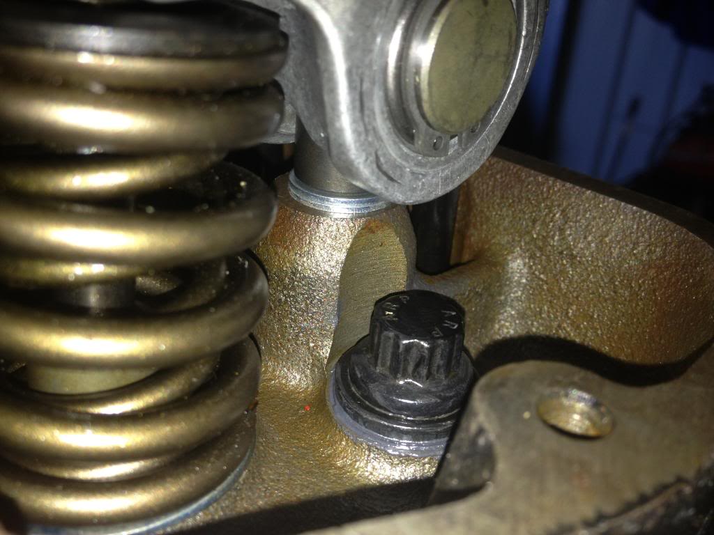

something seems wrong there...the grub screw poking out the top of the rocker lock nut is odd..and i see you used ARP supplied bolt washers?

The Grub Screws are on their last thread, need shorter studs, or wind the barrel nut higher.
rockers arnt adjusted up mate, bought shorter trend rods today and was able to cut down to 1 spacer and wound the grub adjustment rite down to less than half way. And yeah i did use the washers mate, no good?
hi matt...all good with the rockers then..yeah as i said in a earlier post that i used the ARP bolt set on my 308 an found using their washers made the bolts about 10mm shorter than the original Holden head bolt..at least on all the long ones so i didnt use them.
