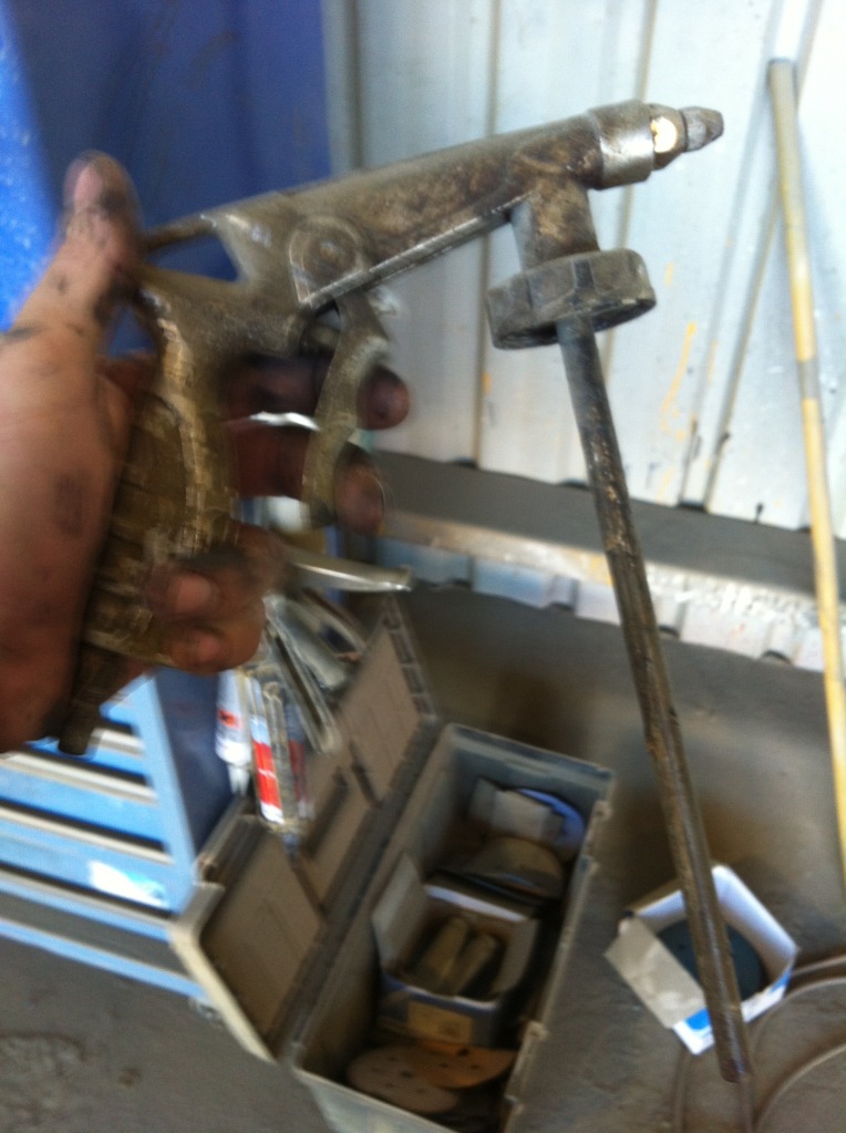

2mm wont move body deadner or the like.
Just use a body deadner gun?
#4 _Bomber Watson_
Posted 09 August 2013 - 02:38 PM
61855F6F-70B9-440C-BA62-AF80994B0D25-209
Had this at work for 5 years or so think it was about $60.

Thanks Bomber, learn something new every day.  Never sprayed body deadener, or had the need so far.

Yeah 5kva would run one but prolly wouldnt start one.
Considered looking for a second hand petrol compressor?
Anyway, TBH no idea about the beaver type things, house paint is pretty thick, so look at whats required thinning wise to spray it through them, if no thinners is required they might be ok.
THAT SAID, If i was in your position i'd just use brushcoat body deadner. Brush it on, all done, i have a compressor, and a body deadner gun, and plenty of power, and i still brushed it onto the floor of the last car i cleaned up due to being to lazy to turn the compressor on and then have to clean out the deadner gun.

And you will need a compressor just as large as you would need to paint a car to run a body deadner gun...
