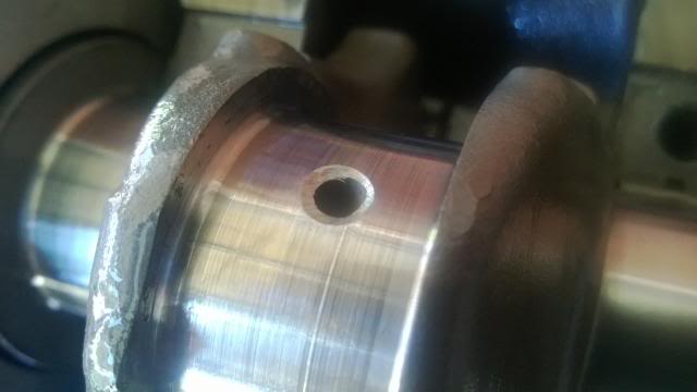

Ok well the plot thickens!

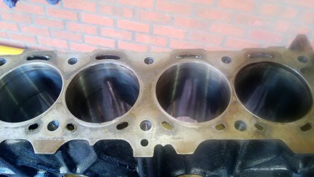

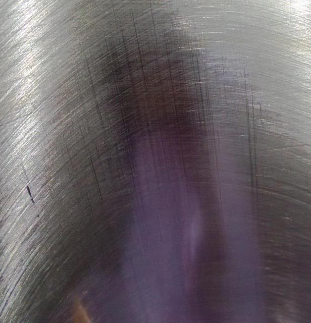

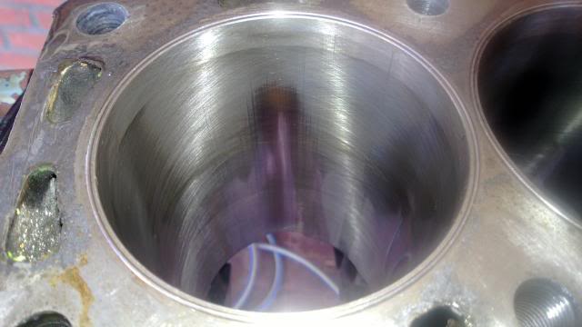

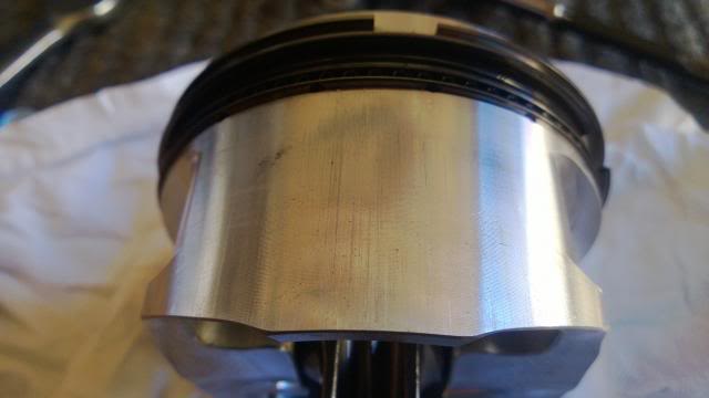

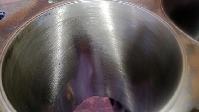

We used a boroscope down the suspect cylinder and found vertical score marks... so decided to do a re-ring. Engine was removed (I bought a leak down tester and was planning to test the motor but the owner removed the head before I got there, Doh should have told him) Anyways confusingly we found pretty much identical scuff marks on all 4 cylinders
#2
#4
Matching scuff marks on the pistons
Now im confused why #2 was down on compression when all bores were stuff... Can the fuel wash cause the rings to be damaged and not the bores? (none of the rings were actually broken, could not see any obvious signs of damage to #2's rings) I should mention these are forged pistons but side clearance is in the correct range AFAIK 3-3.5thou
The head gasket did not come apart cleanly so couldn't have a definitive look but was no obvious signs it had blown. (wish i got a chance to use the leak down tester)

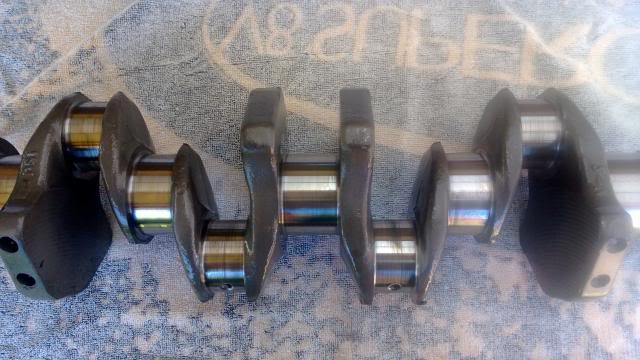

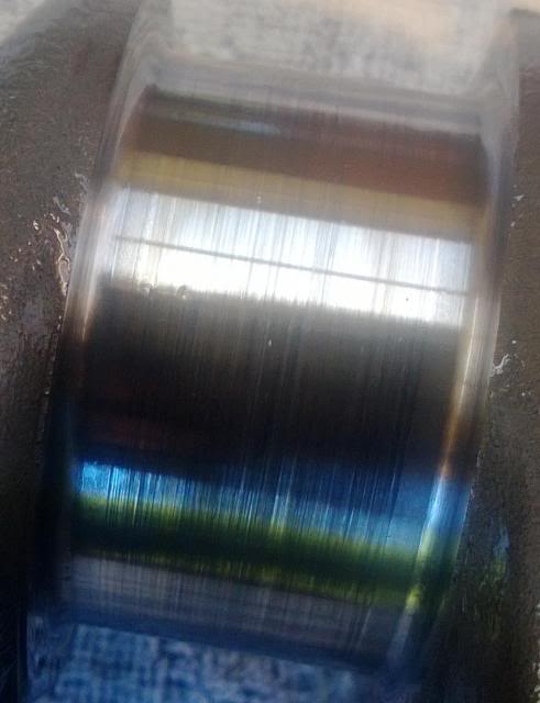

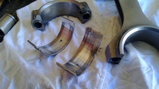

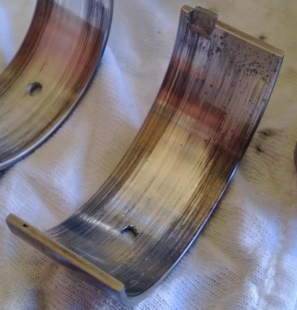

Anyway we wanted to go ahead with the re-ring but after removing the big end caps it would seem that the compression issues may not have been the motors biggest worry...
Matching wear on the cranks big ends
You can see the small particles imbedded in the bearings (lucky we pulled the motor apart huh!) that was after only about an hour or so of running... Correct me if im wrong here but this could only be caused by 3 things? either the builder was not very clean when he built the motor (altho its from a very reputable builder that runs 8 seconds with similar motors, but hey anythings possible.  The motor had been in storage for 2 years since it was built with no head or timing cover on it... so possibly it was not stored very well and all sorts of crap made its way into the oil gallery's or 3 something is wearing inside the motor and releasing particles... But if this was the case... say the timing chain was wearing alloy from the timing cover wouldn't these particles just fall into the sump, the oil pump pick them up but the oil filter uh filter them out before making their way into the gallery's?

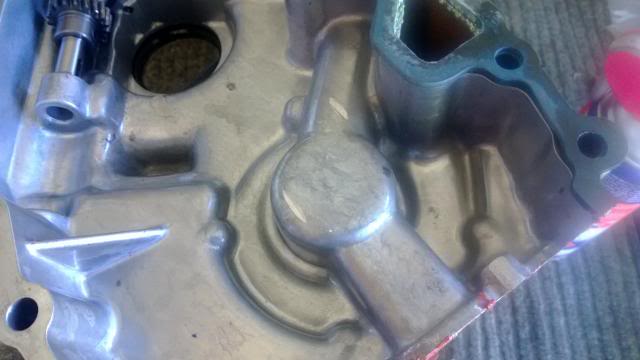

So I went looking and found these marks on the timing cover (2 marks from the timing chain near the center)
Thought maybe thats the cause but after talking to the owner he says those marks were already there...
Anyway to me it looks like it would take alot of particles to cause this in such a short time???
There was still some marks on the main bearings but nowhere near as much as on the big ends... does this tell you anything in particular? I looked down the cross drilled passages of the crank and could see a few particles inside... I told the owner to have  the oil filter cut open just to have a looksie.

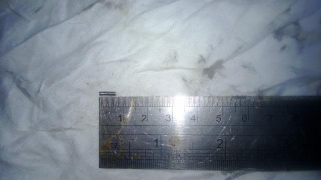

Pretty sure this is inconsequential but I found this in the sump:
I knew I had seen it before, took me a Minute but its off the timing chain tensioner, its a little tang that sticks out the side and its there so when you release the tension you can push it right back and this tab locks it in the open position, the owner probly snapped it off while sticking the screwdriver down the timing cover as I know this is pretty fidly... it made its way down to the sump where I dont think it would have caused any issues after that.
So just wondering what everyones thoughts are... atm Im leaning towards bad storage and the engine getting filled with crap in that time? But why the score marks on all the bores and not just #2, its a multipoint injected engine so unless the fuel was making its way back up the runners and into the other cylinders also... is that possible? but why only #2 down on comp... still possible head gasket I suppose?
looks like the big ends will need to be re-grinded... hopefully get away with a linish on the mains. Will make sure I give all the oil passages a REALLY good clean out.
I would like him to have the deck faced lightly as its got a few rust stains from the long storage but money is a issue, would have to remove the o-rings and Im not sure if they would need to be cut again as the grooves wont be as deep anymore?

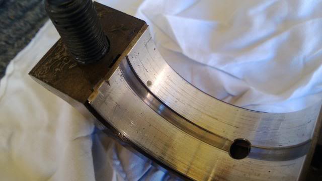

Oh forgot to mention the oil reliefs at the end of the crossdrillings in the crank look like they were down abit rough and their was burrs sticking out the edge of most of them, surely this isnt good?
And when I removed the big ends, the bearings had bugger all crush/spring to them and most pretty much just fell out... any idea what can cause that? (besides poor machining)
Last but not least I noticed a couple of the bearings had small dots where the alloy was completely gone down to the copper... what would cause this? Can see it just above the middle oil groove near top left corner.
#14 _Bomber Watson_
Posted 13 October 2013 - 06:29 PM
Looks like a 200,000km bottom end to me....Sure the engine builder actually touched it?
I can already see a slight lip at the top of the bores, correct me if im wrong though as pictures dont tell everything. I cant see any way that you could get a lip at the top of the bore after an hour.
#15 _Viper_
_Viper_
Posted 13 October 2013 - 06:58 PM
Nah no lip at the top of the bores, must just be the pic... I know the engine builder (by Know i mean ive had him on my facebook for a number of years and we chat often and has given me plenty of advice in the past), he has pumped out multiple 8-10 second gemini's and a few guys over here run his motors with success, Engine is filled with good gear, the hone marks on the bores are still very prevalent...
Not really doubting the engine builder, more likely particles made it into the engine after it left him... unless he happened to have a bag full of 80-grit he unknowingly spilt into the engine ;)

Are their scuff marks on both sides of the pistons/walls or only one?
And has it been running under load? A common cause of sprung bearings is detonation/preignition. It's really hard to diagnose with photos but it looks to me like a combination of contamination, fuel dilution and possibly excess spark lead. All or any of these can make a fresh engine look decidedly old in a matter of minutes. Some close up photos of the bearings, walls and pistons (including top and underneath the crown) might help.
#19 _Viper_
_Viper_
Posted 13 October 2013 - 09:12 PM
Owner has taken the motor and bits to the machine shop now so I cannot take pics but Ill see if he can take a few for me
Scuffs marks are on both sides, It spent about an hour on the dyno with only a few short pulls under low boost, Ive got kmon knock ears and was no signs of detonation as well as the owner keeping his head in the engine bay keeping an ear out for any bad noises or leaks... it was very early in the tune so timing was locked at 20 degree's BTDC just so I could dial the fuel in, and I only got to 4500rpm
Tops of the crowns looked 100% brand new as well as the bottoms altho the exhaust valve looks like it has just kissed pistons #1 and #4 (come to think of it ill double check it wasnt piston #2 that had the valve kiss... maybe the valve is slightly bent and not sealing properly hence the comp drop) so clearances will be checked before it goes together (the owner bought the short block and fitted the head himself but never checked clearances properly... I turned the engine over by hand before it was ever cranked over but that was the best I could do without pulling it apart) Brand new Eagle Rods with ARP bolts... The crank would of had to be machined to suit these rods so new bearings would of been put in... Even if you were to re-ring a engine surely you would throw a new set of bearings in anyway they are cheap as... why wouldnt you... Money for the build wasnt a issue... he has a set price for his engine packages...  its just now this is all unplanned cost for the owner so things are getting tighter.
if it was detonation doesnt it usually hammer the middle of the big end bearing on the piston side?

Normally I'd assume motor has been cooked or too tight clearance to score marks from the piston skirts like that.Looks bit suss if score marks were there when it got put together.
As for bearings etc looks like it had no oil for some time & was dry when turned over/started...metal on metal untill it got oil pressure.Might have been put together with just engine oil builder thinking it won't sit too long or would be sealed.
Sounds like a combination of errors made over time like engine not sealed properly,put together with oil not engine lube & sounds like head wasn't checked that had bent valve which showed up as cylinder problem.
