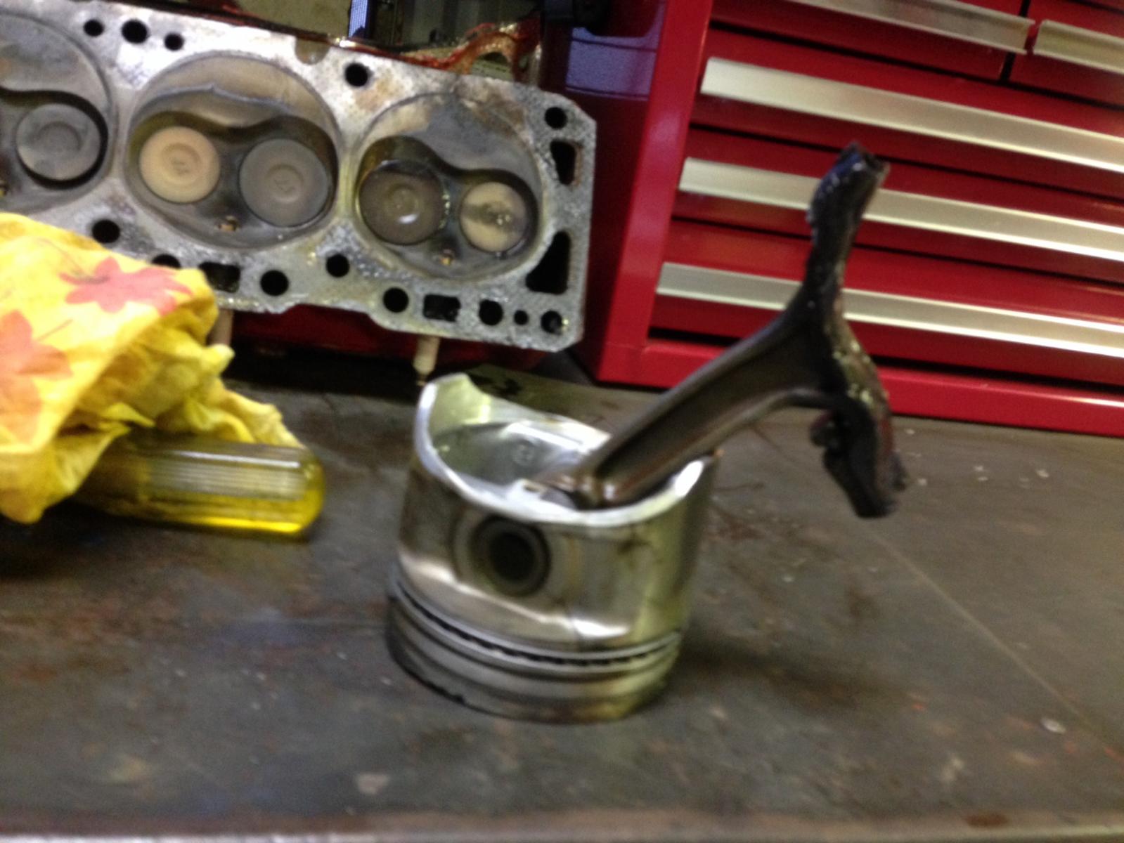

Col,
rod out the side of the block- punched a 20 cent piece hold #4
broke the cam in three pieces
bent two valves
punctured two holes in the sump
f#$#cked the crank
smashed the soild lifters
turned the big end of the rod C section into a T section
it's all over for that bottom end, it was like a bag of marbles in the sump rattling around.
it was the old motor that i go freshened up.
head needs another service and Valves replaced - but lucky it was not further damaged.
I needed a little bit of luck as we pulled it down my luck was running out.
it just ran out of oil when it needed it.
RIP the QL red engine.

Jesus Christ you must have given that thing a hiding Grant

and thus Grasshopper....we now all understand why its called CONROD Straight....as in, Conrod Straight out the side of the block!!

Sounds like it may have sucked some air, long run down Conrod(filled the rocker cover), on the brakes, then turn hard left(last of the oil runs away from the pickup) you know what sound it makes next. What sort of baffling did you have in the sump?

Warren - that's exactly what happened although prior to that race on the marshalling area i did hear some noise and then hopped out to check, I had my helmet on and it sounded like a exhaust leak it could have been the start at that stage.
It had a high energy one on BUT not baffled.
Anyway without further ado the end result - I now have a trophy for the garage and a talking point over a few beers !
thank god i never put the Dual Stamped engine in at ! LOL

dan - your not wrong - i really should have had a 30 psi pressure switch which would have showed how long the pressure was done or non existent.

Do u run a big 'idiot' light? Ie oil pressure? Was having this chat with another nc torana bloke here in wa.. he had a builder try suggest the higher volume/baffled/gated etc sumps were not required. .

I used to have the oil light come on under heavy braking. Basic baffle welded in and no more light.
