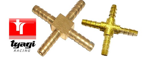

yeah im contemplating setups with the Holley pressure reg i have laying around mated with a 3/8 NPT-3/8NTP union to a bit of 40x40 alloy solid, about the same long, drilled through each way and threaded for 3/8 ntp in each hole to take the pressure reg and each of my existing fittings to the carbs.....See what i end up doing once the engine is back together and back in the car.

Try your local Gasweld or whatever, they'll probably have some aluminium 4 way blocks with 1/4" bsp ports for compressed air takeoffs. Pneumatics suppliers like Festo have some neat manifolds too. Or you can use a barbed cross, about as simple and as light as it gets:
