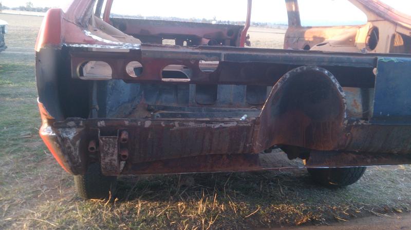

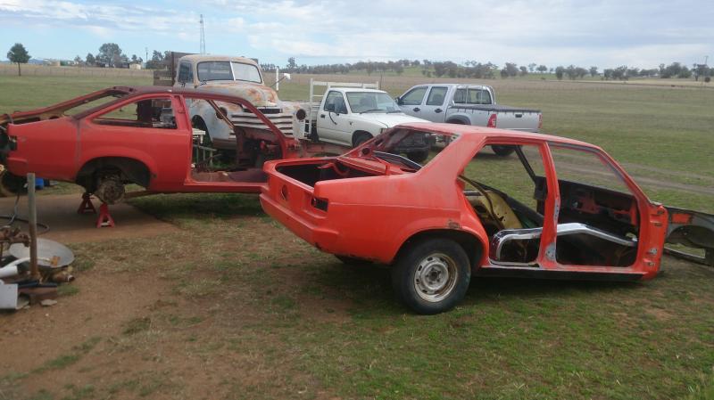

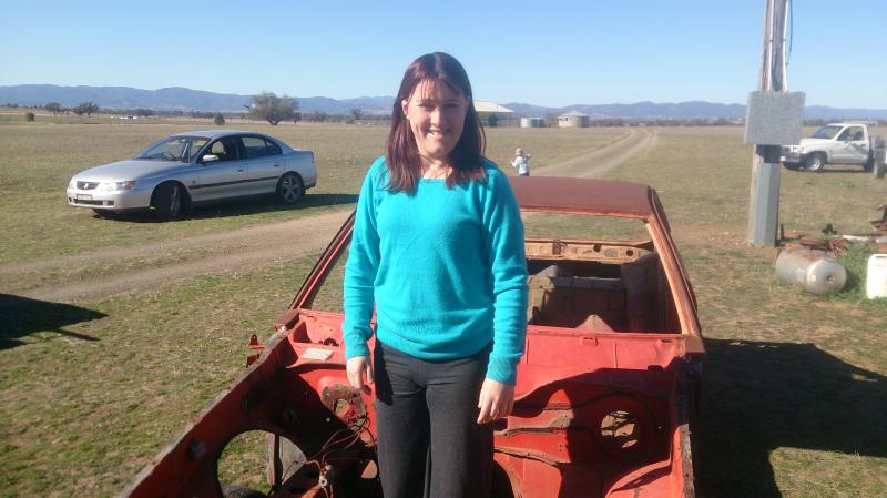

The first car that started off the idea
The second as had been left sitting for years unloved and no touched.
First job was to put a Kframe under front and make it a roller again
So after 17 year hip hip horay it moved
Lucky for me my wife is into cars :)

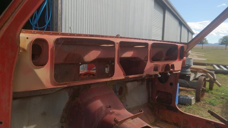

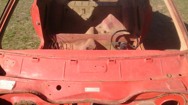

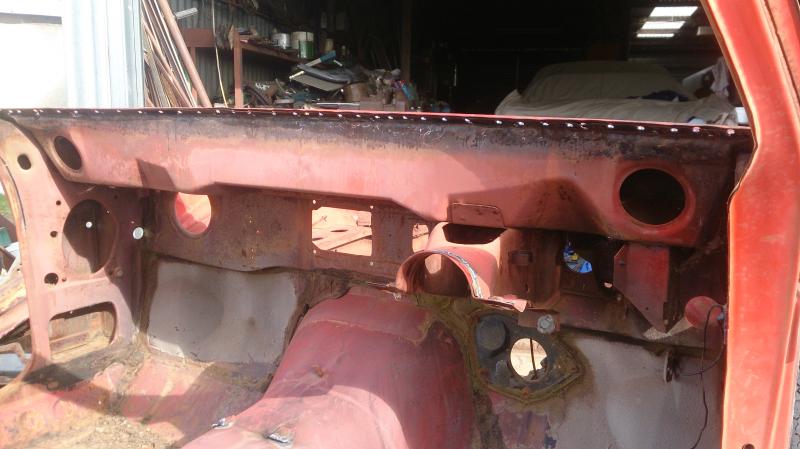

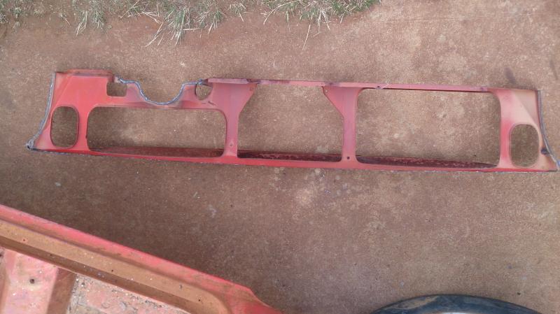

Time to start somewhere. UC dash has gotta go.
Drilling out spot welds
Ready for my Uncle (whos helping me out ) to cut out dash
Free UC dash anyone? FREE
How it looks with no dash :)
Big thanks to my Uncle for not only letting me use his tools but his a very skilled Boiler maker and theres no way i can do i better job than him with oxy or MIG welder. But im doing okay with grinding and drilling.

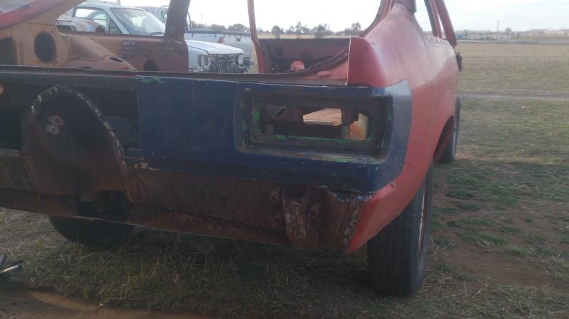

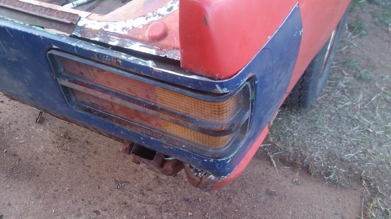

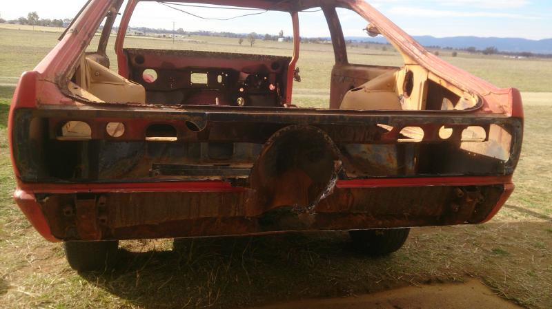

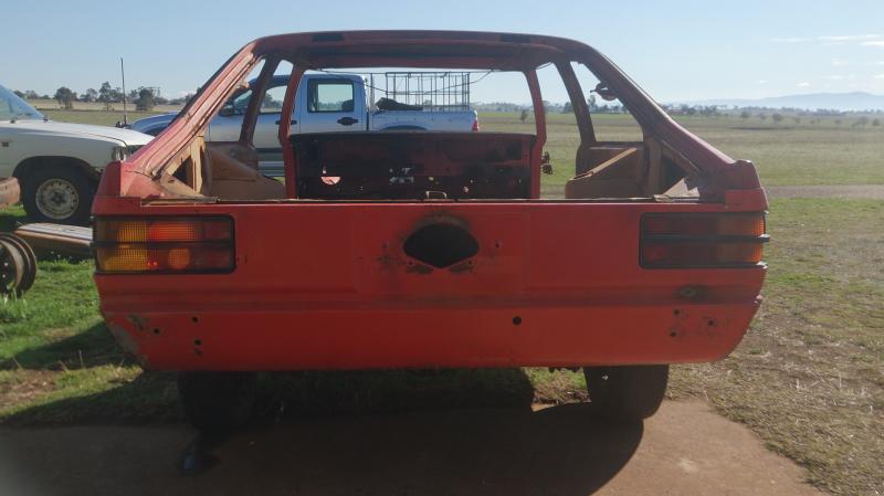

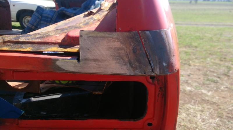

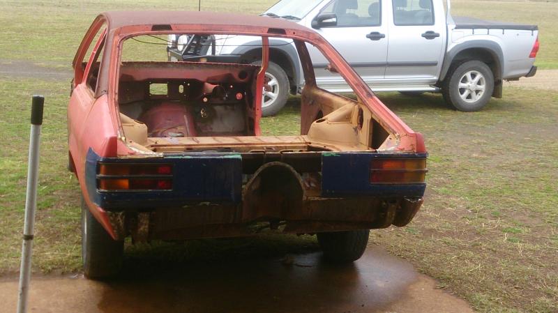

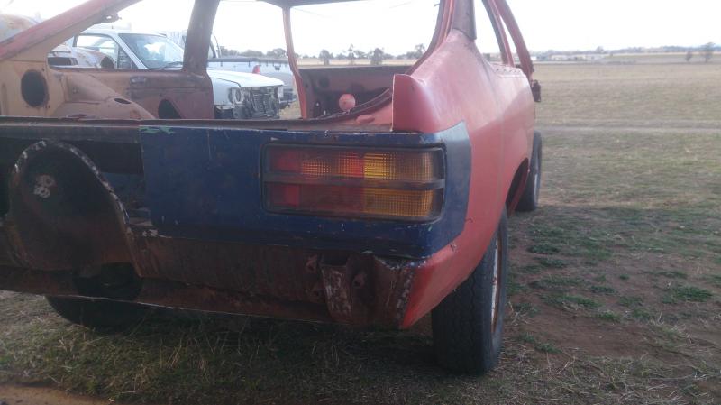

Plenty of grinding to do, it like an art. Body sealer not much fun but after heating with oxy does the trick.
I realy hate UC rear ends and cant stand them. Sorry UC fans maybe tinted lights and chrome trim helps but they still look ugly.
So after my uncle marked out where to cut i got into it with grinder, yee haa.
lower section dented and rusty so it came off too.
Got some rusty LX rear light sections to use as a kinda template.
Amazing looks a million times better already
Got late in the day but one side kind of sorted out

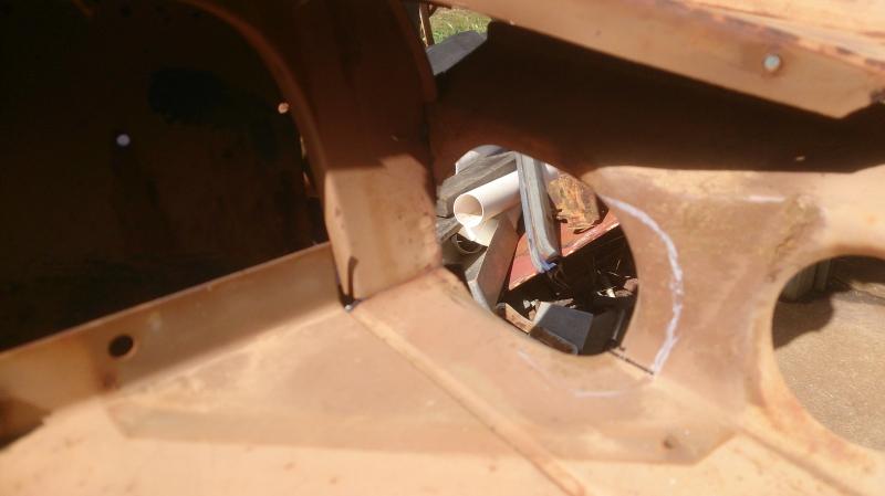

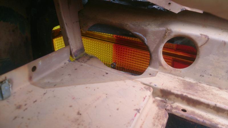

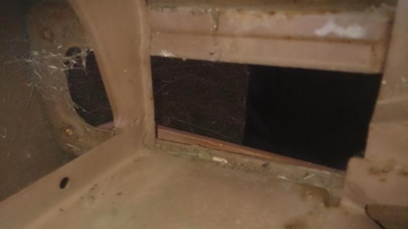

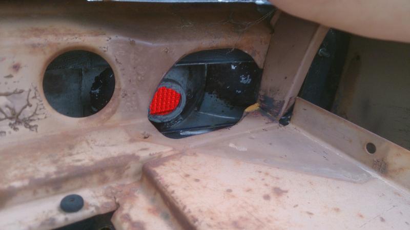

Not sure i have seen much information on tailight inner panels (iv looked but maybe not hard enough!)

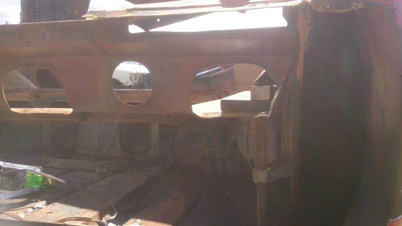

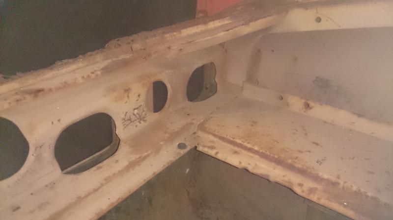

Anyway will have to look into giving them some attention so rear tailight globes can be changed.

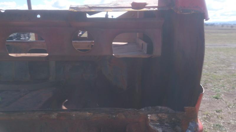

Inside LX Hatch panel
And now inside the UC tailight panel
The Hatch top floor also sits higher on a UC than a LX due to different spare tyre placement and fuel tank. I wont be lowering it like an LX thou.

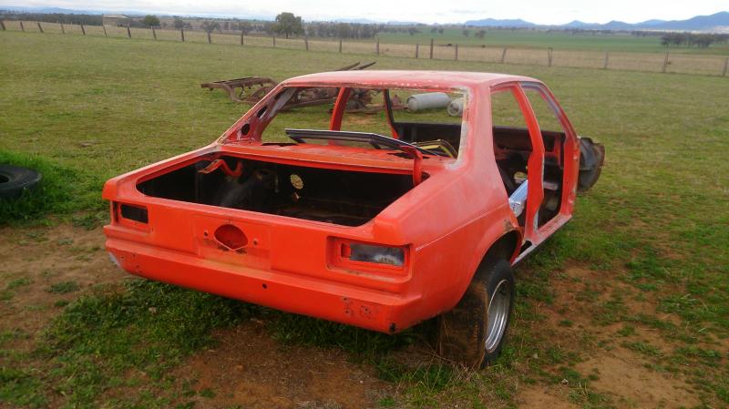

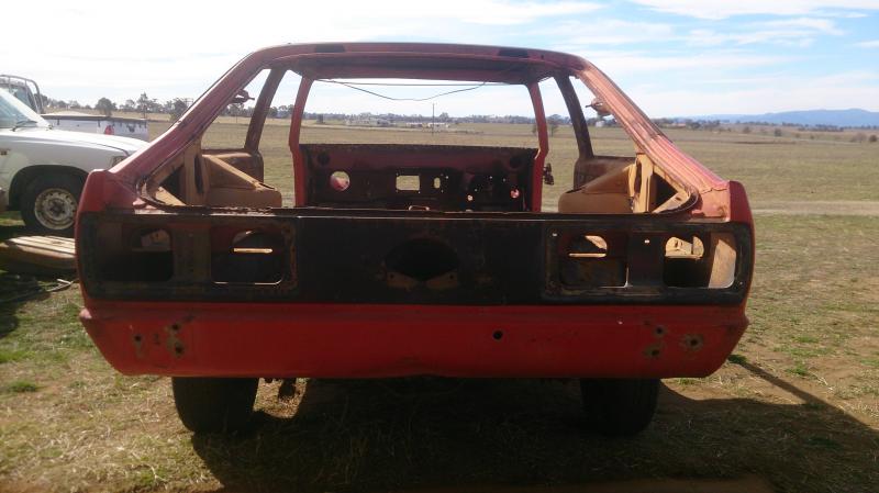

So Hands up whos made a mistake, Measure twice cut once hmmm. Oh well.
Everything here well to plan except accidently cutting to far into where fuel neck comes out (no biggy)
Took whole upper section inbetween tailight as wont be neading them.... well ummm.
Well heres a problem. The piece now sitting in scrap pile is now neaded back and other section will nead to be remade
So dont copy that idea lol. Is totaly fixable.
So thats with two tailights sitting in before donar section cut out to fit. And has fuel filler section repaired and pump up shock hole filled in

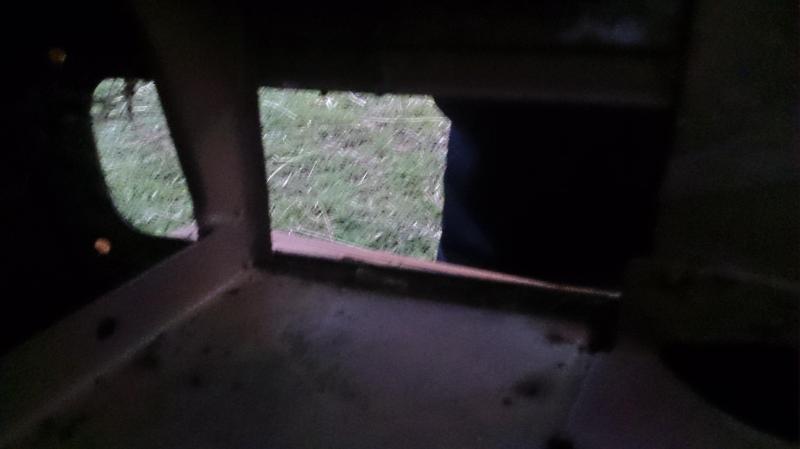

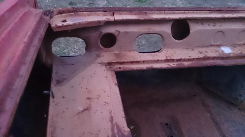

Just an update on how My uncle and myself got around the UC inner tailight panel so access can be gained to globes
How we started.
Changed the angle
One globe will fit now to make the other.
Now other will fit.
Same thing now done to passengers side.
Probably unexciting but a few people on Facebook were asking how to go about inner section.
Chears Neil

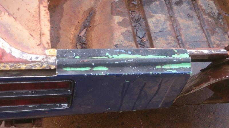

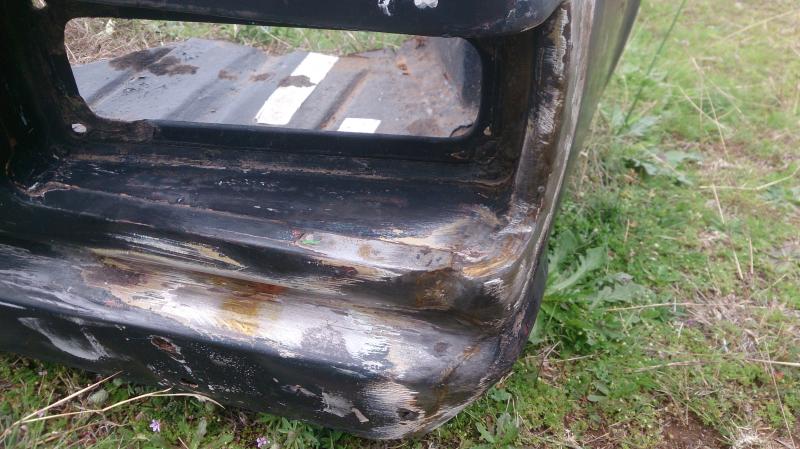

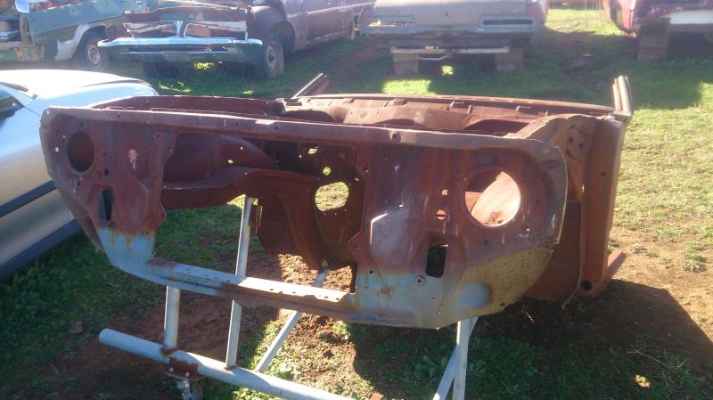

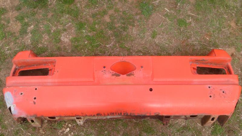

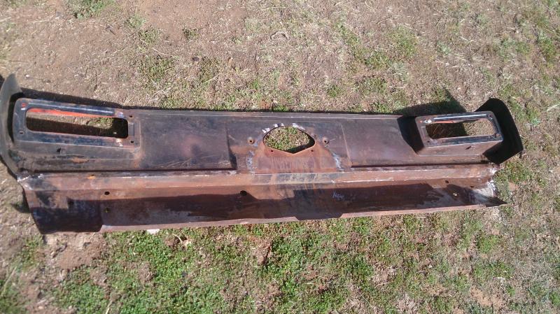

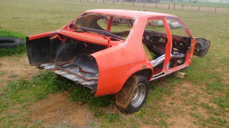

Next bit was to sorce some Donar Cars for the best parts to go back onto UC Body.
My mate Patto had a LH Torana that he bought that had been impounded and gone rusty after sitting outside a Police yard for god knows how long. He won it on an Ebay auction but after purchasing another car and trying to sell this one (had no tags) he made the decision to cut it up for parts.
As he got it.

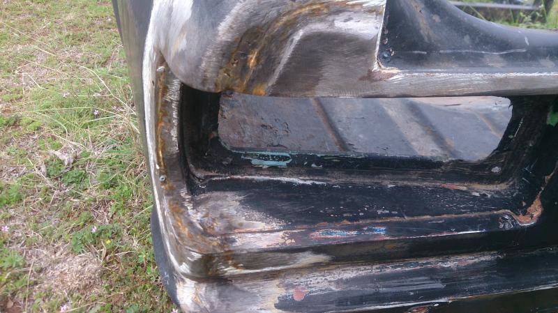

I bought front cut off Patto and while at my Uncles farm the Damm Cows have been rubbing against it but its fine to use
Had my old Torana BBQ i never finished propley and decided the rear on it looked to good to waste so decision was made to use it for rear.
After lead burnt off looked like it may of had a left rear quarter put on.
And after drivers side burnt off apart from dents it looks like a whole rear has been fitted. covered in bog and every time went to melt lead along boot floor spot welds kept blowing holes so decided to scrap that and find a better one.
Will update more on donar car tommorow
Chears Neil

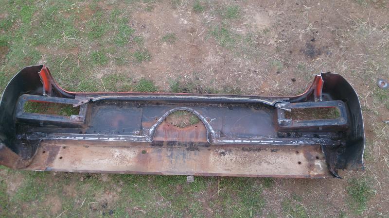

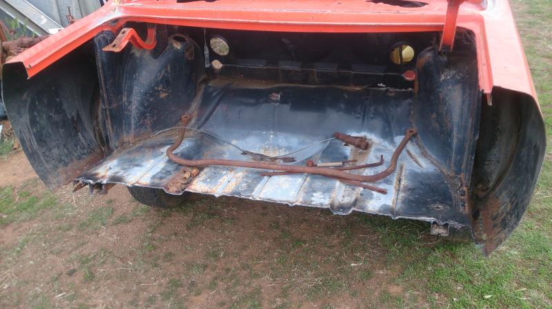

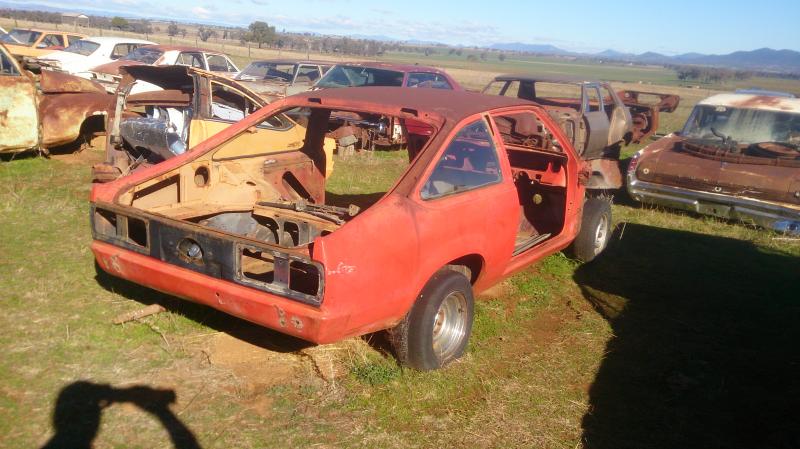

Next thing to sort out another rear donar.
I had also bought this LX rolling shell , not as a donar but as a spare body.
I had already borrowed the front k frame and wheels and had no luck selling shell on so as it had best rear it was decided to use it.
Before the chop, for one to live the other must die :(
Chop Chop

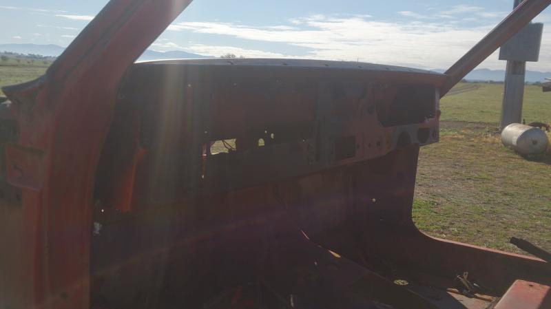

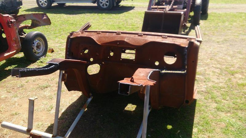

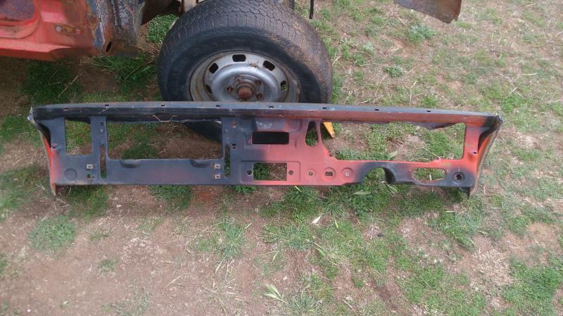

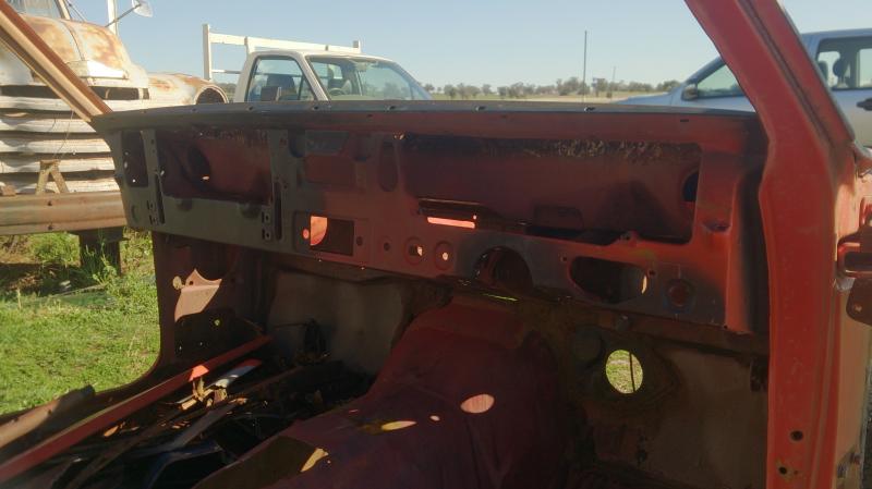

And now to cut dash out, rusty shell had a very butchered radio area.
One LX dash awaiting some work to make fit.

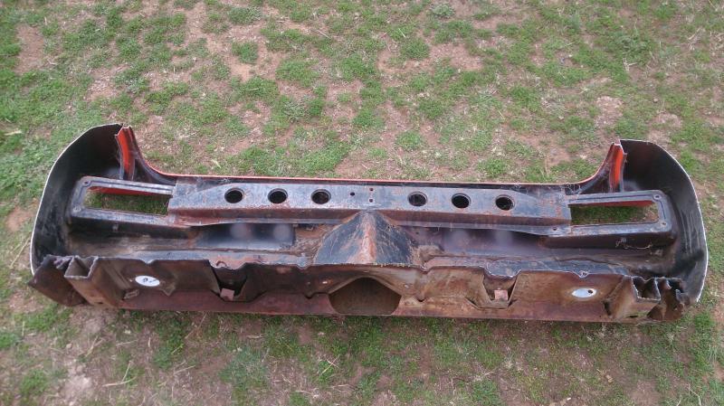

One LX rear awaiting trimming up
Not all LX Torana sedans have the inner panel inbetween tailights. Both my BBQ and 77LX Sedan i drive dont.
Sedan donar now a sad and sorry SWB Torana, can still use it for cuts so wont be throwing it out.
Chears Neil

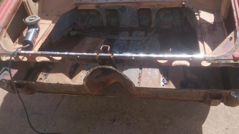

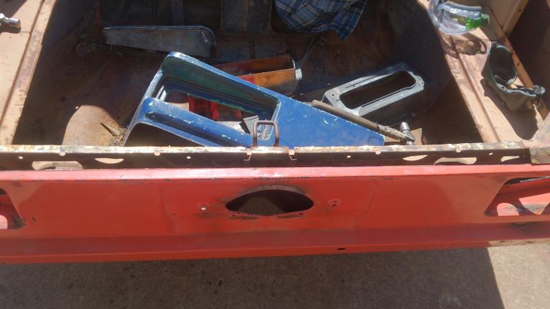

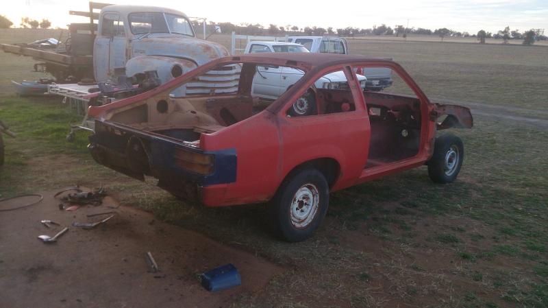

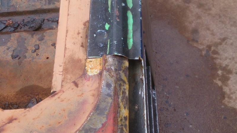

Next job was to trim up rear cut, grind down spotwelds (not drilling so can weld where want to) and get all the black sealer off and remove boot floor join.
Not much left so about ready to test fit.
Ta Da well better than looking at a UC Bum :)
Will still nead some work yet but getting there.
Will have to repair and replace upper panel that should have stayed on.
But all good as have another rear to copy off.

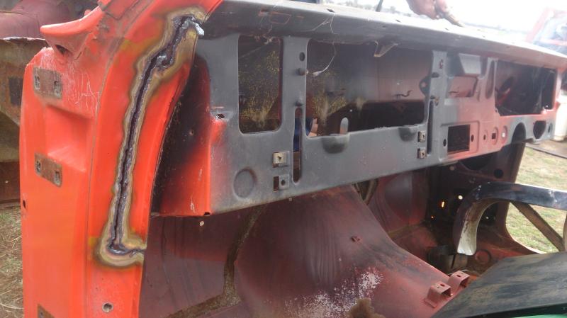

Next spot with some attention was the dash, trimmed up to test fit too.
Second photos bit shit but get the idea. Didnot realy take many photos as probably pleanty about.

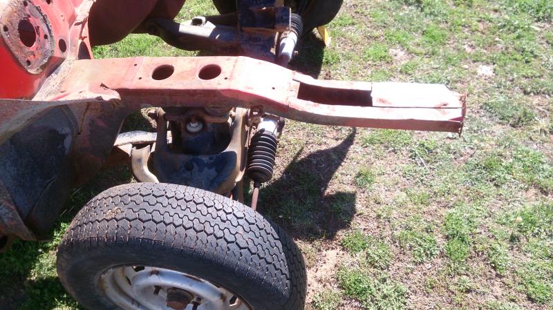

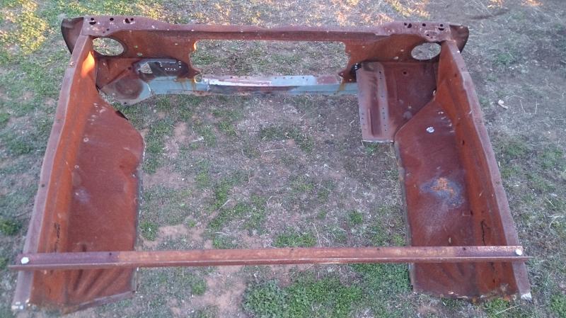

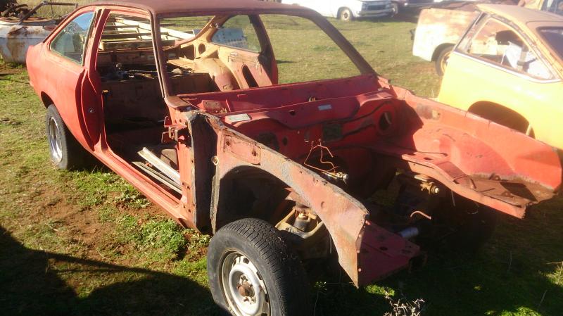

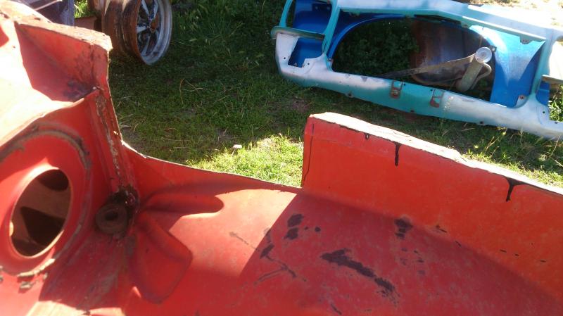

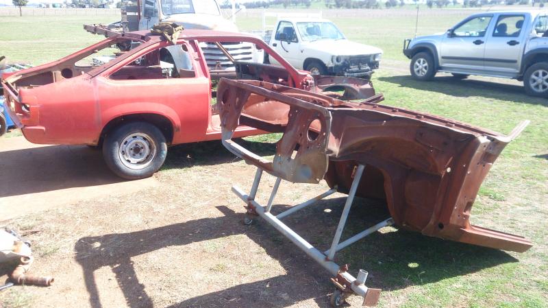

Time to have a little update, doing work on front now.

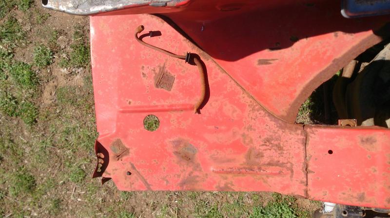

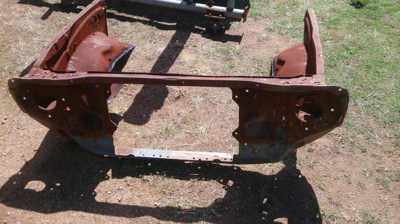

Bumper mounts are different on LX from UC and also inner section tapers down near Radiator support.
UC inner
LH/LX inner
So with a plan and some thinking its time to start on what to do with front.
Pop goes the gas axe and this bit wont be neaded.

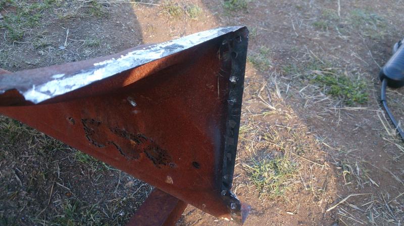

Which leaves this bit and a lot of spot welds to grind off.
Bit of reo to stop it flopping around
Grinding of spot welds and some bonnet hinge rust.
Bit more progress, lower radiator support will nead attention
Somehow Bonnet hinge section on UC was still ok so cut it out.
But ended up using fresh metal to replace LH inner section
Started on removing UC inner skirts
So will have to finish removing UC inner skirts, cut around Body number so its not moved or altered and replace rusted metal on lower replacement radiator support panel.Then might be able to fit up replacement front.
Also got some replacement parts from Rares
