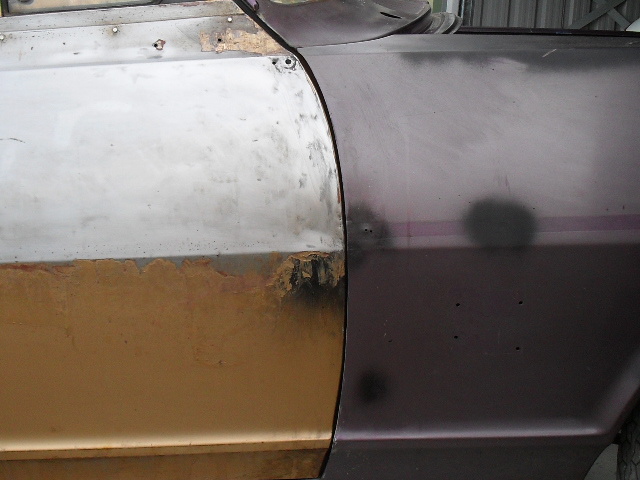

here's a pic.can see how much its drooping.and the gaps not bad at front.the pins lined up with hinges
real good.goes to show they are not made one fits all.never had it that much though.i think i will take the
skin off and put on other dr shit.ive just aswered my own question lol.good advice dj on using the orig drsAttached File  ljzedded 337.jpg   130.54K   2 downloadsAttached File  ljzedded 336.jpg   123.12K   1 downloads

Is the door black and was the picture taken in the dark with no flash ?

May need to bend the hinge hangers a little to get it right.

Posted 25 September 2014 - 04:29 PM
about 30mins ago blair.ive changed drs before and been out a mil or so .this dr is off an lc.
never seen one like this.

i reckon id have to take both the dr hinges off and reline.wouldnt have a clue how to do it.sorry blair didnt answer all ya question
no flash .stripped dr 4yr ago and ran out of stripper and just left it like that

funny pic did not show on my ipad, but i can see it on my computer, weird.

i forgot to put pic up so i used the full editor.that might be the reason why

The gap between the door and the fender is woeful above the body line.
The top hinge on the pillar needs to be adjusted forward and the bottom hinge needs to be adjusted rearwards to make that door sit right.
Seems that no two doors use the exact same hinge adjustments on these old beasts.

Quick dodgy to see where your at, put a trolley jack and block of wood under the back corner of the door, sit it on the inner shell not the lip of the skin.
Carefully jack it up and see if it wants to come into shape a bit.
