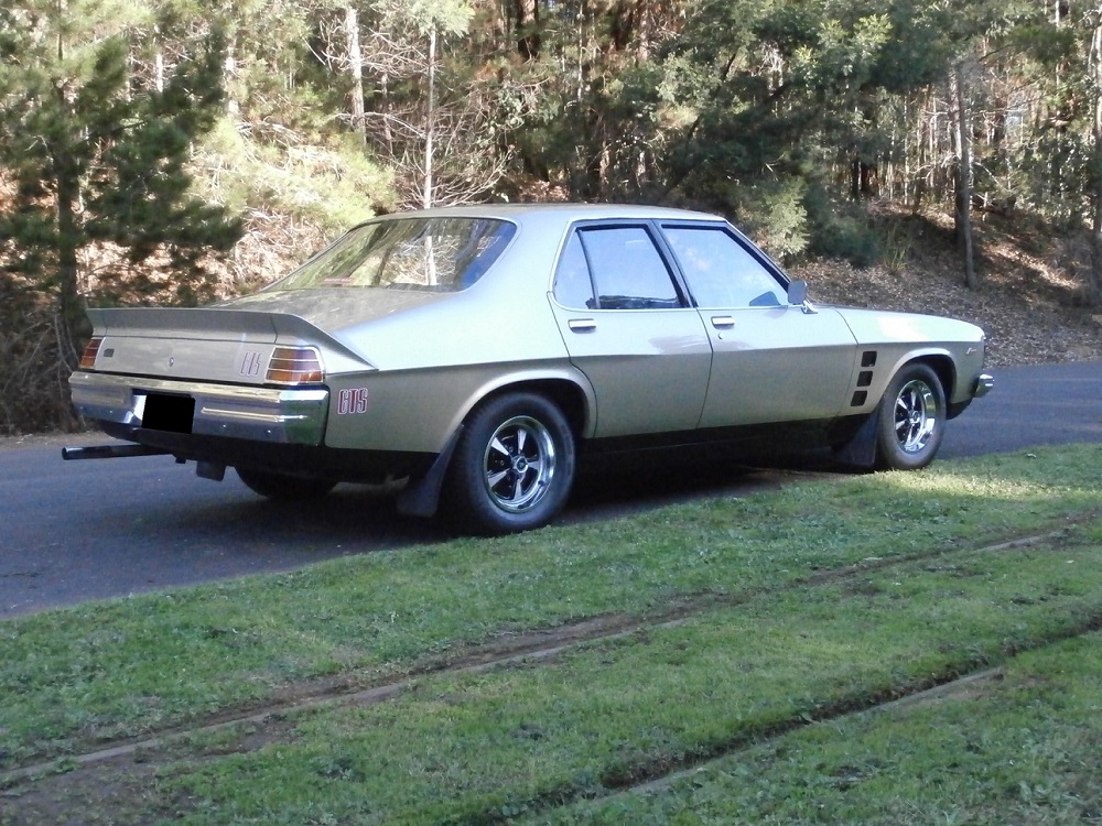

My car was painted with 2pac paint over acrylic about three years ago now ,the acrylic paint was sound,an isolator was applied and then the 2pac .I would have preferred  acrylic and would advise anyone to go this way,( acrylic over acrylic and compatible paints or back to bare metal)BUT having said all that my car shows absolutely no signs of cracking ,flaking or anything since it was done,maybe if its done right it should be ok.
