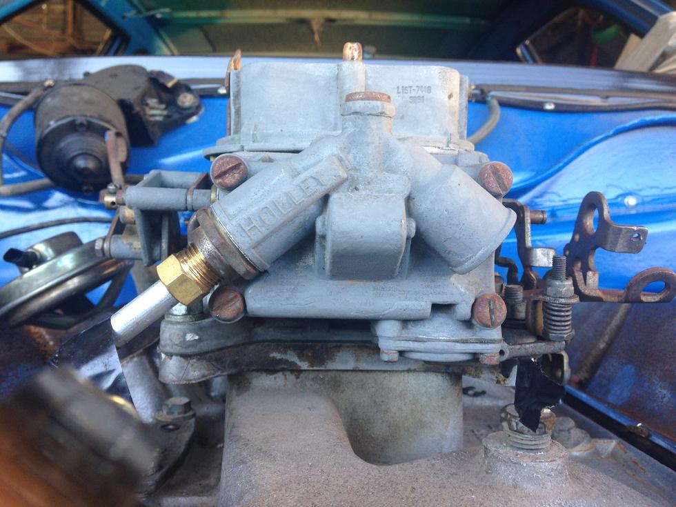

firstly, andrew.
"Hopefully there is another large vacuum fitting under the front of the carb too, where the purple arrow is pointing? You can connect this to the charcoal canister."
nope :(
has large one on rear, going to pcv as best i gather
going by your "hopefully"... that could make things tad more difficult
last pic shows the "to dizzy" you mentioned i gather :)

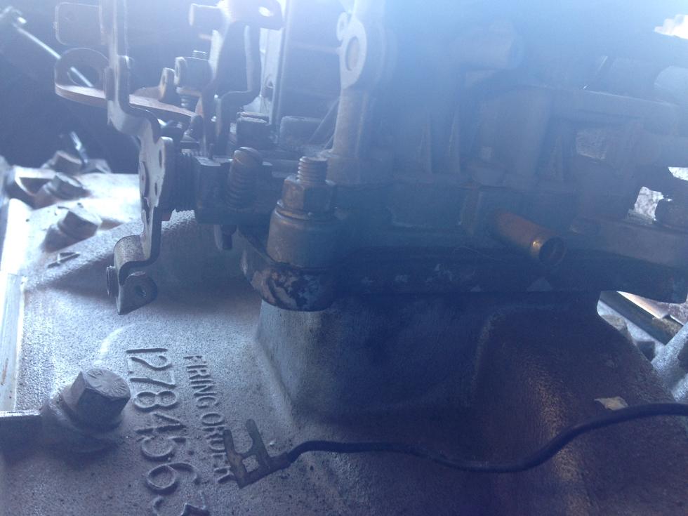

got the (in picture) left hand side plastic tree off
turns out it wasn't "bubbly" weld around it, but 20yr old ?? liquid teflon/locktite
cant get the larger one on right off, don't have a spanner big enough.   35mm?? or something
am leaving to soak and try with the multigrips
Edited by livo74, 26 February 2017 - 02:57 PM.

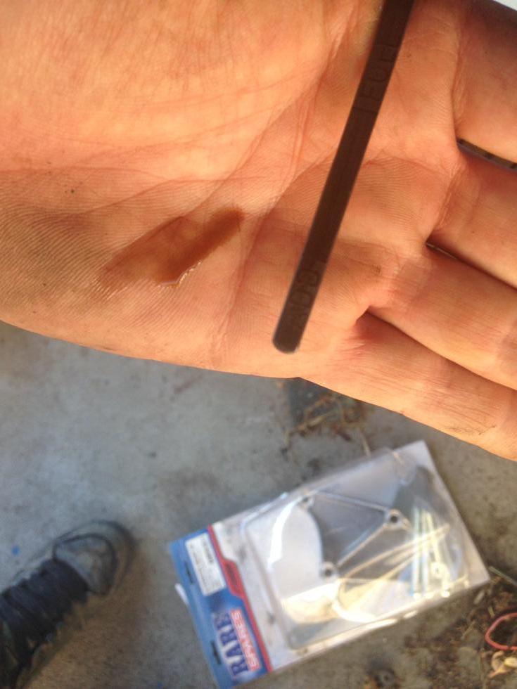

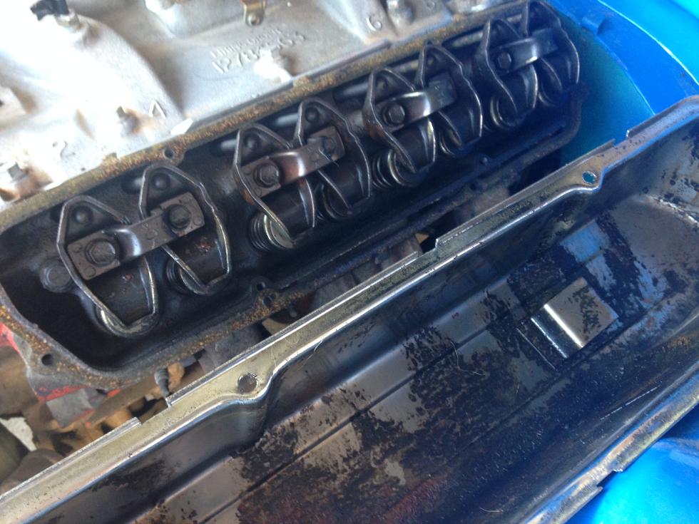

so, i knew the oil on dip looked like this
not bad for a car sitting unused for 10-20 years i thought
as "seemingly" good as that looked i was secretly dreading having a look inside the rockers
..as had researched vids on taking apart 253's... and theirs looked like this
and hence this
thick sludge and blocked drains everywhere!
 ...but i took mine off anyways just now,
and looks like this
can only hazard a guess is a good thing and very fortunate
____
(all stock parts as best i can tell)
Edited by livo74, 26 February 2017 - 03:10 PM.

Looks good. Make sure you find the thread on priming oil pumps before you turn it over Matt.

The crud on threads can be teflon tape or stag paste used for welsh plugs

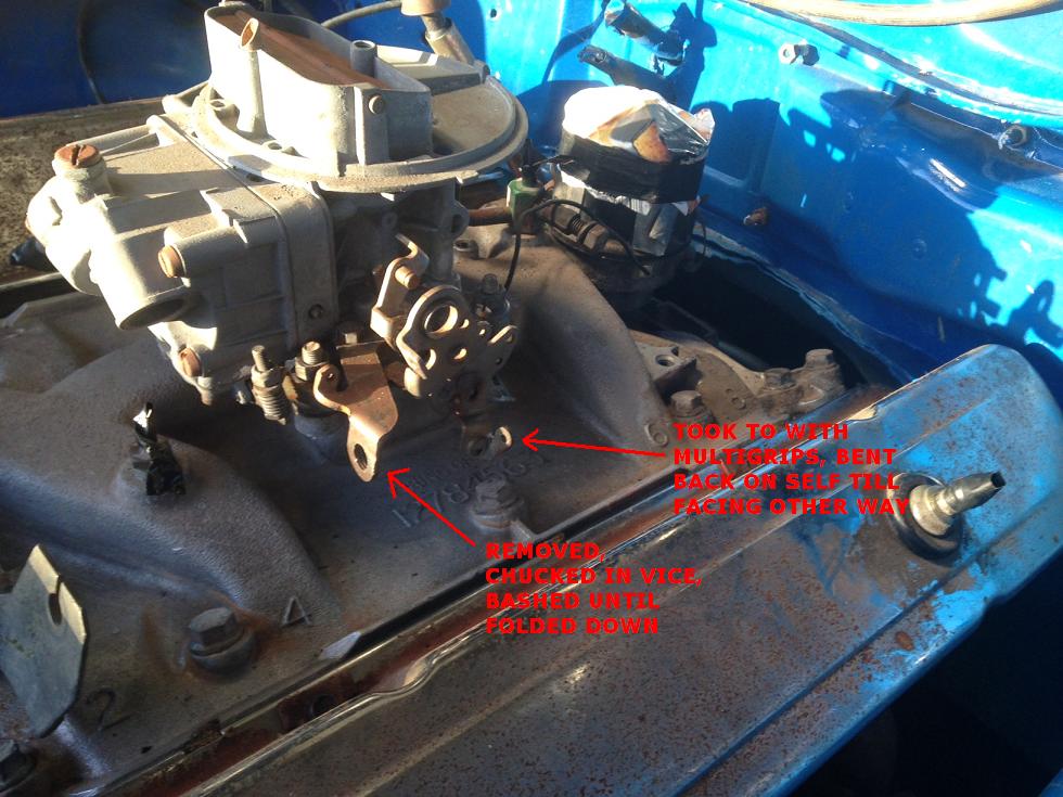

Check out this ugly accelerator cable setup & bracket.
It will work ok to get it running..hope pic not big.
#311 _livo74_
_livo74_
Posted 26 February 2017 - 04:44 PM
not sure what's bigger, the pic or the manifold;)
my cable has to come from behind though. (unless i work out how to disassemble and reverse mechanism.. which ain't bloody likely)

Have look at end of accelerator cable...the ball it clips onto bolts into one of the holes of throttle shaft.
Lowest hole = cable from front(as per pic)
Highest slot = cable from rear

Vac tubes from metering block to advance unit on dizzy as already stated, same with heater lines.
PCV should for all intents and porpoises come from the big take off at base of carb. via a tube to PCV valve to one end of a rocker cover
in which the PCV valve plugs into , there needs to be the other  rocker cover with another hole that another tube that leads up to air cleaner.
The air filter "can" usually had a fitting that was fitted inside the "can" that had a nipple to the outside world that a tube was connected
to from the rocker cover WITHOUT the PCV valve.That set up defines Positive Crankcase Ventilation ?
As said , the holley will probably be the problem because it has no vented bowl port or a purge port that lead to canister , block off
all the crap not needed , not sure , but you might be able to get brass bungs from the plumbing section in a hardware store ?
and i have a proper egr blanking plate if needed , frok all that pollution crap off bar the needed stuff for rego. because all it caused was pollution?
another edit , according to vic roads 22 ADR 27a was an addition to ADR 27 that defined CO emissions ,but 27a was a control of NOS emissions
along with the 27a , nothing wrong with a sweet smelling pipe , sure beats the the hell out of dioxins from an engine that was equipped with pollution stuff ? :)
Edited by EunUCh, 26 February 2017 - 06:46 PM.

" there needs to be the other  rocker cover with another hole that another tube that leads up to air cleaner."
damn. thought was saving money and just needing hose to connect from existing pcv/cover to base of carb.
as will be using (non factory setup) a washable 9inch x3in air cleaner, imagine have to drill hole in base and mount there.
but, so... no pcv valve on second hose running to cleaner?
and i will try plumbing as have one local, cheers!
thanks for offer of  blocking plate, but car came with one.. and bloke i bought car off 2 years ago said.. get hands on egr, so did.
as seemingly going to go the easiest of setups and test the waters when time for rwc/rego... may just block off indeed

so you persisted until got through my thick head... and this happens
original
ten minutes of work later
next,
fashion a cable mount that runs same line
cheers gtr!
edit...
or IS that brown piece THE holley cable mount?
Edited by livo74, 26 February 2017 - 07:06 PM.

That wiil work with that bracket in pic.Got ATF oil in eyes so I'm squinting.
Getting there just add 'return spring' & connect accelerator cable...try what you have,might be right length.

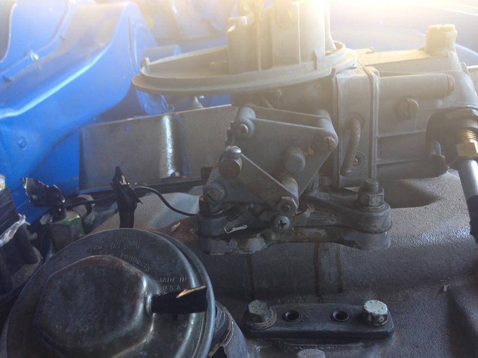

trying to look at 350 holley cable brackets/setups is ..difficult.
no one has quite same bracket as mine.
car doesn't have cable so will have to get new one, and just see how they attach to a car and go from there

one down,
get hands on pipe wrench to tackle other one now has been soaked to loosen. no go with the multigrips darnit
got bung at my small country hardware store, in their little plumbing section. whoda thunkit!
(not done up tight, waiting on liquid teflon or glue)
Edited by livo74, 28 February 2017 - 03:22 PM.

done well mate. stick with it, no need too pay people to do these easy jobs..
if there is a bunnings or supercheap store close, buy a spanner the right size it will be much easier.
also i think your water pump is missing its top left bolt???

With regard to the accelerator cable, I know Commodore cables run around and come in from the front but don't Torana cables normally come in from the rear (ie. Torana cables are shorter)?

No Andrew. LH and LX definitely had cable come around right side of motor, then cable tie to top radiator hose and on to cable bracket.
Attached File  New A9X 1.jpg   213.23K   5 downloads
I am struggling to find a close up of the bracket.
Attached File  IMGP2545.JPG   145.31K   4 downloads
