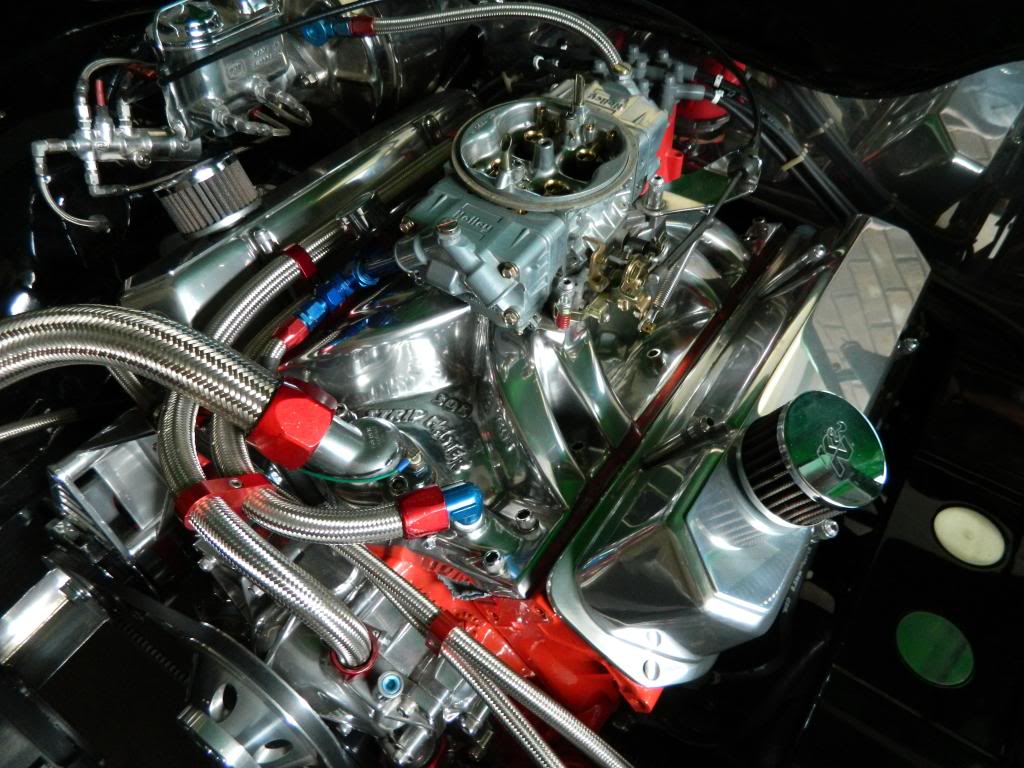

Sorry, not making sense, can you show some photos of the system you have for venting now?
Every motor needs to vent the crank case pressure somewhere.
#5 _LX355SLR_
_LX355SLR_
Posted 02 November 2015 - 10:24 AM
Current setup which is really nothing...have holes for original PCV setup and was originally going to put mini filters over these holes
Can't really tell from what you are saying, is the engine open vented atm or is the venting sealed?
Either way, fit the OEM style PCV or catch cans, you need to vent the engine but it has to be filtered.

yeah, from the pic it looks like you just have 2 holes vented to atmosphere. Thus Bombers concern.
The gases just get pushed out by crankcase pressure......by adding a hose to the inlet, you are sort of ""vacuuming"" the gases out, better way to go.
You could just try a test setup where the 2 tappet covers are joined by a hose, and then a T piece runs off to a ( sealed) hole/fitting on the underside of the air cleaner. i.e. get the inlet vacuum to do the work of scavenging the gases for you.
Use garden hose if you need to, just to see if it improves things....then make it pretty later.
