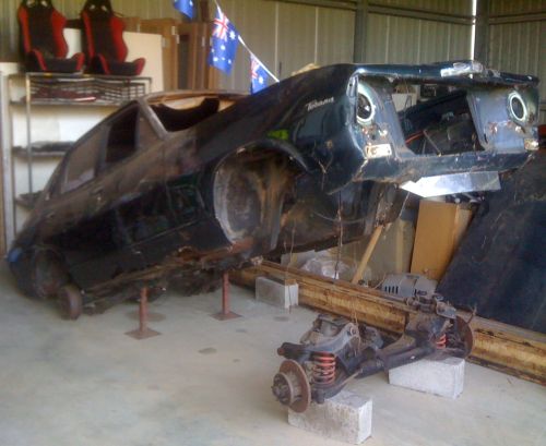

We never know what will happen, so a 4 hour change around using the tilt method:-
This tilt method works as a full component Torana too,
 just by placing the rear wheels in the boot,
 and the K frame with motor and box rolls out,
 then the spare K frame with motor and box rolls in.
( balancing act, just holding the end of the gearbox, you can steer it where you like )
