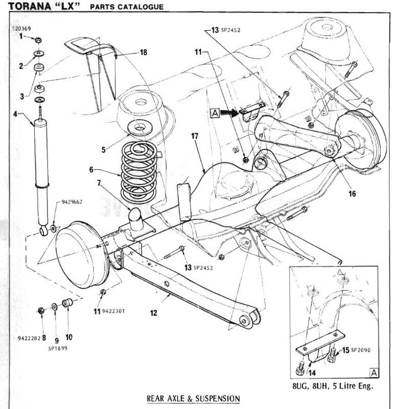

can anyone let me know where the bump stops go on the diff of an LX please?
There is a flat section on the body with 3 or four screw holes directly above the diff housing.
Is this for some type of bump stop, and if not what's it for?
Regards Mando.
#182 Bigfella237
Posted 11 April 2021 - 02:00 PM
The bump stops are inside each coil spring (No. 7 on the following diagram)...
If you're talking about a mounting plate in the centre of the car above the diff pinion then I'd guess it's for the illusive pinion bumper (see "A" inset above, item No 14).
EDIT: Also see this thread: http://www.gmh-toran...rana-diff-bump/
Edited by Bigfella237, 11 April 2021 - 02:02 PM.
#183 jeffblanco
jeffblanco

Posted 11 April 2021 - 08:39 PM
Thanks Andrew,
I'll see if Rare Spares sell the number 7 bump stops.
Being a different diff setup, I reckon it would be hit and miss to get
the rubber the right length to make it work properly.
Regards Mando.
#184 Heath
Posted 12 April 2021 - 09:29 AM
It's quite likely you can source the third "A" bump stop and trim it down if needed, to suit the nose area of your diff pumpkin. I may even have one spare... but I would need to check that out.
There should be a piece of sheetmetal with two captive nuts in it, to secure that bump stop.
Attached File  2016-04-10 13.04.12.jpg   365.65K   21 downloads
Nothing with 3-4 holes that I have ever seen.
The normal bump stops can be sourced from Superpro apparently:
https://www.ebay.com...GIAAOSw9fFf83oz
Or you can get your hands on an original pair and cut them down etc.
#185 jeffblanco
jeffblanco
  • 389 posts
  • Name:Mando
  • Joined: 29-October 16
Posted 12 April 2021 - 02:44 PM
Attached File  IMG_0609.jpg   236.25K   16 downloads
Attached File  IMG_0610.jpg   160.47K   15 downloads
Thank's Heath,
I've ordered a couple of the blue bump stops.
Thank's for the offer to look for the bump stop on the metal plate.
I'll take a look through my left over pile and see if I have one for the [diff pumpkin] as you describe it.
I took a look at my body and I do have three holes. Two are threaded, for the bumper stop and the other is just a hole.
Regards Mando.
