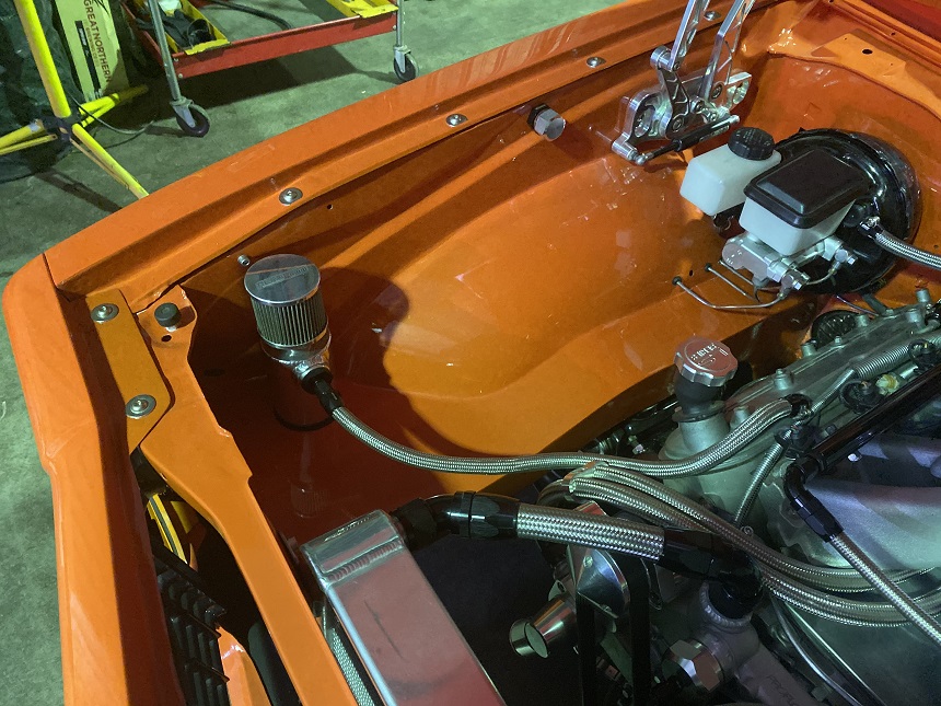

A quick progress report for the hatch, I've been putting in the hours where I can but some family health matters have taken priority. I'm waiting on the interior guy to install the roof lining so that's put a hold on the glass. The boot area is now wired and plumbed, I've fitted the coolant reservoir and the oil breather catch can in the engine bay and a lot of stuff like door rubbers, bonnet release cable, speakers etc... Only a thousand things to go

Coming up very bloody nice, Harvey! Bet you can't wait to get it out for a drive.
Sorry to be 'that guy' but do you reckon that upper radiator hose will have enough flex when the engine starts torquing around?
Especially with an alloy radiator. I'd hate to see you stuck on the side of the road with the fitting torn out of the tank.

That's a good question Andrew, Its a very short hose and quite ridged, with temp in the hose it should be flexible but I don't know the answer to that,,,yet

I'd be looking for a standard rubber hose with the correct bend. Even though the motor twists towards the top radiator fitting, if the hose isn't pliable it will cause trouble over the long term.
Unless you have Tuff Mounts or something similar. I can't remember.

another alternative would be looking at making the way the radiator mounts more flexible.

I have come up with a way to give the radiator some flexibility,  I have made some brackets to mount in front of the support panel and fitted anti vibration fittings between them and the radiator, then drilled out the existing mounting points. This will allow for expansion and rotation. The brakes and clutch are bleed (the worst job on any fit out) and today my glass man fitted the front and back windows, I had to wait an extras 10 day for a clear glass front. I'll keep filling it up with fluid and hope to try a start in the new year. The interior guy has been hard to nail down but I won't stop hassling him. Merry Christmas boys and girls !!!

The only other thing I might suggest is to run an earth cable from the body to the radiator, maybe down low where it's out of sight? Especially alloy radiators have problems with electrolysis.
See the thread here: http://www.gmh-toran...d-when-mounted/
