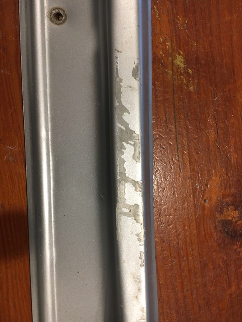

I have over a hundred photos of brand new Toranas, and not one shows the scuff plates.
This one is unrestored, and it is hard to believe that it was ever bright.
Yes thats how mine looked but not as rusted, I am sure mine are the way they came, I have had the garaged for over 20yrs and my mother in law cant recall the scuff plates ever being removed, at a guess mine are painted with a silver paint.

Brian, these must be painted or have some other type of decorative coating applied. Electrolytic zinc plating simply does not peel.

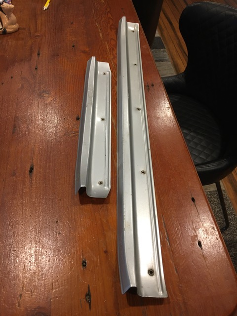

I have also now seen enough painted scuff plates to believe that at least the S model came with them.
Attached File  Scuff plates with silver paint over zinc 1.jpg   144.72K   3 downloads
Right hand one has been sanded back to zinc.
Attached File  scuff plate original with silver paint. Right one sanded back to zinc..jpg   121.28K   3 downloads

According to the parts catalogues, all LH & LX as well as UC Torana S only had what they called "Cadmuim Plated" scuff plates, while all other UCs had "Chrome Plated" scuff plates.
The Cad plated ones had the same part numbers for all those series.
So it seems if your LH or LX has chrome plated ones then the previous owner probably had them done.
Dr Terry
