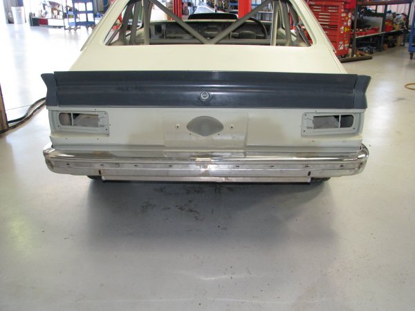

#11 FLY_LX
FLY_LX
  • 164 posts
  • Location:melb
  • Car:LX sedan
  • Joined: 30-December 08
Posted 03 June 2022 - 07:28 PM
This is what I was thinking on the front, tucked in tight.
Attached File  HHH_LX1.jpg   348.14K   9 downloads
Rear
Attached File  HHH_LX.jpg   341.07K   8 downloads
#12 Heath
  • 18,351 posts
Posted 04 June 2022 - 09:39 AM
I saw that car get revealed the other day. Look forward to seeing it in person and really interrogating it a bit more. Got some very nice features although the weirder shaped (more bubbly) flares haven't quite grown on me yet.
So that rear bar has had what I was talking about. I don't think it's tucked length-ways along the car, but it's tightened in on the sides. Very nice feature.
To my eyes, the way the front bars fit standard (assuming it's all straight and adjusted nicely) probably looks as good as the tucked ones. But I can appreciate the angle that people go for trying to get things to hug in tightly and improve the loose tolerances that Holden designed around. It is obviously more refined and improving it is not an easy exercise.
#13 Bigfella237
Posted 04 June 2022 - 10:11 AM
Yep, several ways of doing it.
As Heath says, if you just want to close up the gap at the ends then all you have to do is cut'n shut the bar and move/elongate the mounting holes (if the cut is in the centre, otherwise two cut'n shuts outside the brackets, but there's not much room to play with there).
If you actually want to close the gap between the bar and the body (across the length of the bar) then that requires surgery on the brackets as well, which is much more complicated.
Looking at the (standard) rear bar in particular, the ends don't really follow the shape of the body (they're kinda cut square whereas the body curves inward), and it may just be the shadow in that picture above, but it looks like they've extended the lower part of the end to better fit the body.
That's a terrible colour to see detail work like that BTW, it seems to hide the work rather than show it off, or maybe it's just the poor lighting/shadows.

#15 adrianh08
adrianh08
  • 219 posts
  • Name:Adrian Haynes
  • Car:1974 LH
  • Joined: 24-June 10
Posted 01 March 2023 - 09:55 AM
Ha ha ha Heath!! Weird bubble shaped flares? I'm not sure if I'm offended or just amused. Hopefully now you've seen the car in person you saw that the front flares are 140mm wide and exact same dimensions as the rear flares.
As for the tucked bars it is a LOT of work to do properly. I shortened on the sides obviously and had to modifiy the brackets to bring it in close to the body length wise as well. I re shaped the ends of the bars to suit the body profile which included extending them and putting a curve in as well to follow the body shape. This is different for front and rear but both were done. All bolts welded in and tops removed. A lot of people think they are fibreglass bars due to this but they are the original bars.
Agree with "Bigfella327" re these photos being quite dark and not showing off a lot of the detail. In fact the car is a nightmare to capture properly in photos due to the custom colour scheme. Looks 100% better in person and i have not seen a single picture that captures it properly yet.
Long story short, tucking the bars properly makes a huge difference in my opinion but it is a lot of work to do properly. To do it and then have them re-chromed would be even more work again.
