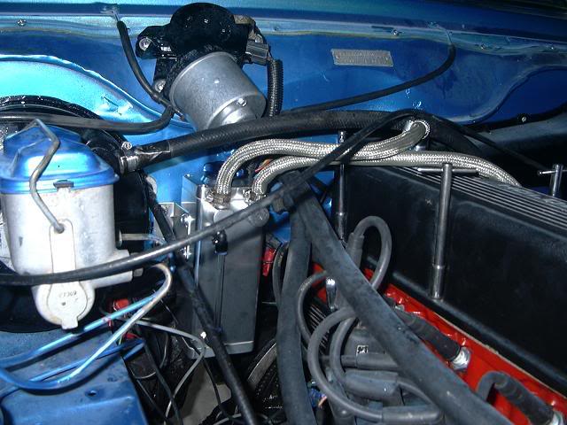

#20 _UCV80_
_UCV80_
Posted 17 September 2006 - 04:17 PM
I installed this baby today..
I havent driven the car yet... i so hope it solves the problem :D
:rockon:
#21 _Aquarius - LC_
_Aquarius - LC_
Posted 17 September 2006 - 04:43 PM
G'day Nathan,
Just caught up on this thread, That catch can should do the job nicely :clap:
This is such a common problem with aftermarket rocker covers in conjunction
with roller rockers. :banghead:
Just be prerared......you might get a shock when you see how much oil
was previously getting sucked into the engine. :D
#22 _UCV80_
_UCV80_
Posted 17 September 2006 - 04:55 PM
runs a dream now :D its beutiful :spoton:
i got a rude shock wen i cheked the dip stick earlier :rolleyes: from full to half full.. in 1 week:blink:
Thanx for everyones help,
cheers, :rockon:
#23 _UCV80_
_UCV80_
Posted 17 September 2006 - 05:41 PM
i undid the nut on the bottom to see if i cought any oil... and holy crap! well over a cup of oil shot out! bout 300ml for a 15min drive :blink: this was my frist drive with the oil catch can. definatly shoked... !
Anyone with a worked 6 needs an oil catch...!!!!!!!!!!!!!! the engine is running way better now :D
