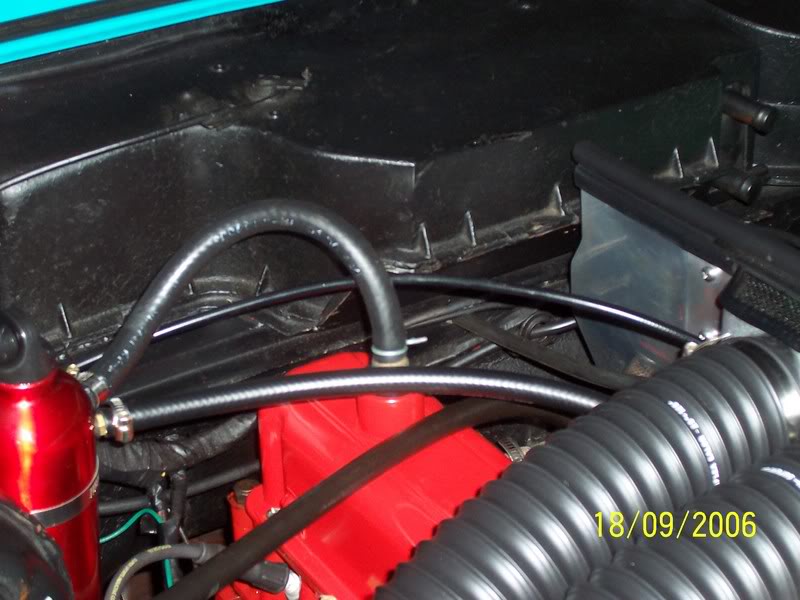

nice bay, see how the pvc tube goes vertical for a bit, could that stop alot of oil getting through? as it wouldnt wanna go up. mines an L shapped pvc.
Cheers,
nathan
The short answer is no, this small amount of vertical hose would make no difference. To see what I mean next time you have the engine running, pull out the PCV and stick your thumb over the end and give the trottle a blip and see how hard it sucks.
