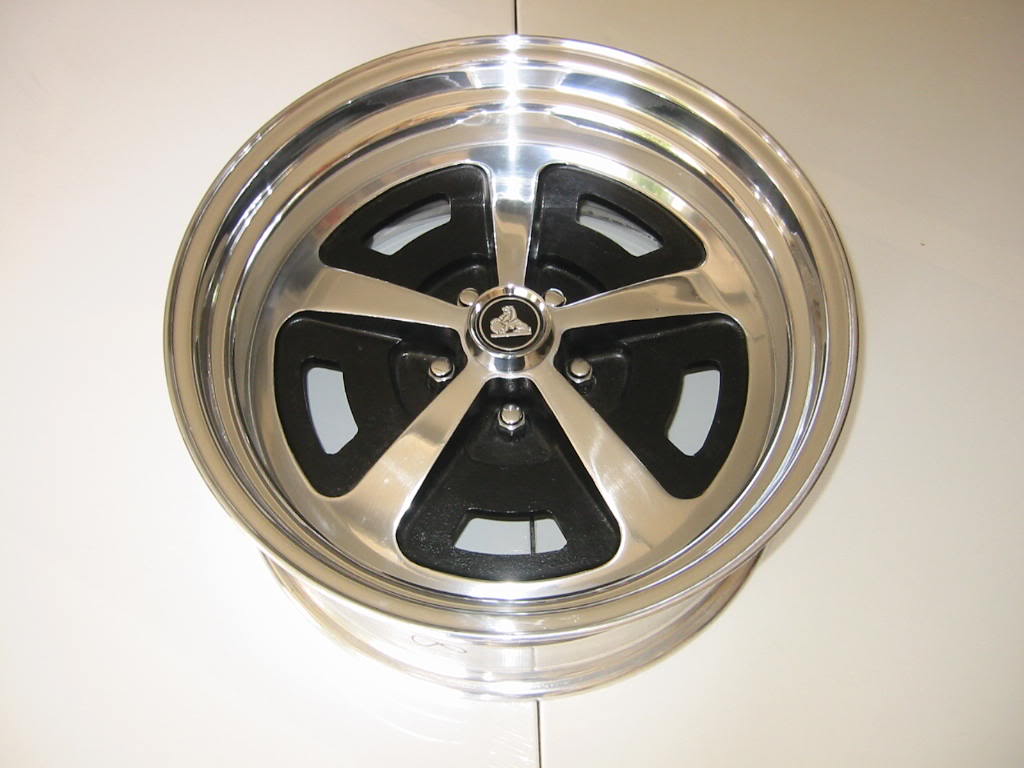

hey dattoman... How much did they set you back? i reckon they will look so F*cking hot on a Torana! I cant wait to have the money to buy myself a set!

Yeah Dattoman --where when and how much are they ,they look just like what i want ?

#36 dattoman
  • 16,488 posts
Posted 06 October 2006 - 10:40 PM
Hahaha...... you guys crack me up
Like I have the money to buy them
When the car is finally nearly ready ...... or started
Then I will buy me some
Prices though........ well they go something like this
All wheels are custom built to what you need in the way of offsets bolt patterns and centre bore,constructed with forged alloy outer rim with T6 alloy centres. Prices start at $450 per wheel for a 15 x 6 up to $650 per wheel for a 18x9.5� Note �OLDSKOOL MUSCLE� is only avail in 17� and 18�, priced at $525 for a 17 x 7 and 17 x 8 , $565 for a 17 x 9.5, $595 for a 18 x 8 and $650 for a 18 x 9.5. We can section our outer rims to achieve custom widths at an extra cost. Note .due to copy right we do not supply the holden sticker for the �OLDSKOOL MUSCLE� wheel, however it is available from Rare Spares. We are Melbourne based and we distribute Australia wide.

a guy here on the coast has these on a LJ and i must say, doesnt tickle my fancy all that much, just looked weird, i cant describe why but i think its the large chrome outer edge. again though each to their own. i think id rather a nice set of billet wheels in a nice old school yank style.
