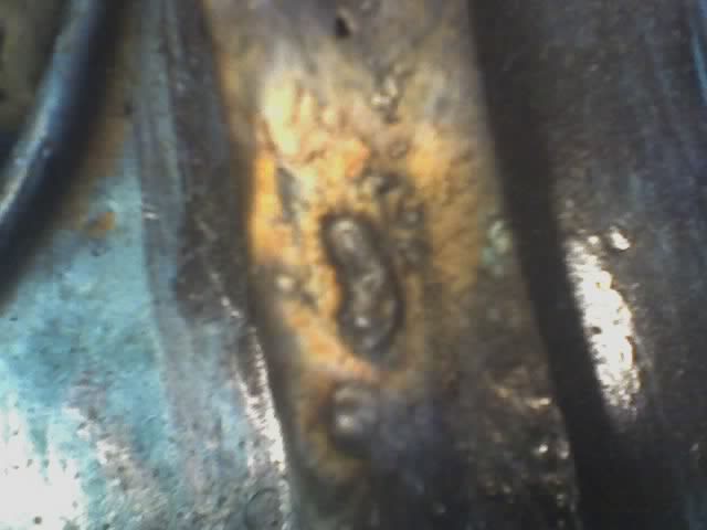

The tory is just about completely stripped.. Im going back to rip the gas tank and windows out now, then she will be bare as lol.. I'll upload pics when I get back..

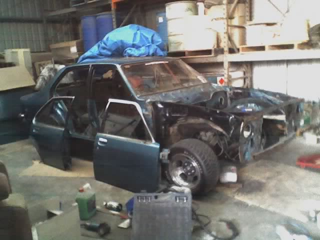

Didn't end up doing any more work tonight, got too dark. Will do it tomorrow..

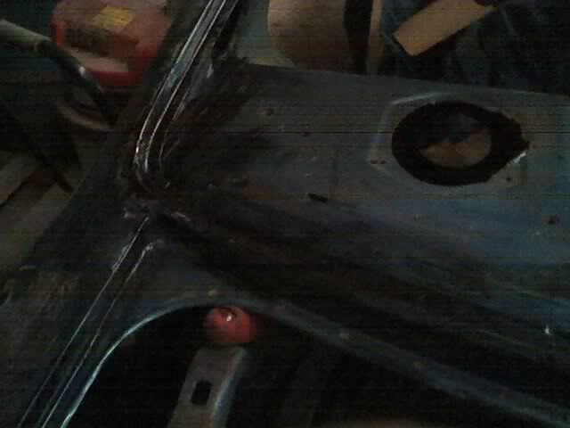

Heres what the tory looks like atm

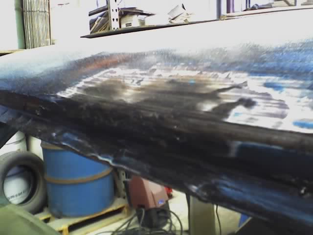

Nah I just got a wire brush drill bit and went spastic and took all the dirt off them. Then I painted all over it with that Wattle Kill Rust. It's gonna get some underbody tar put on it too..

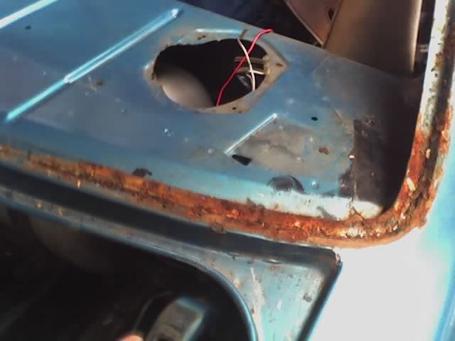

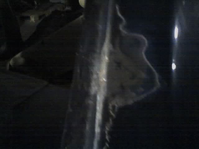

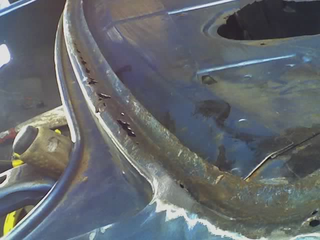

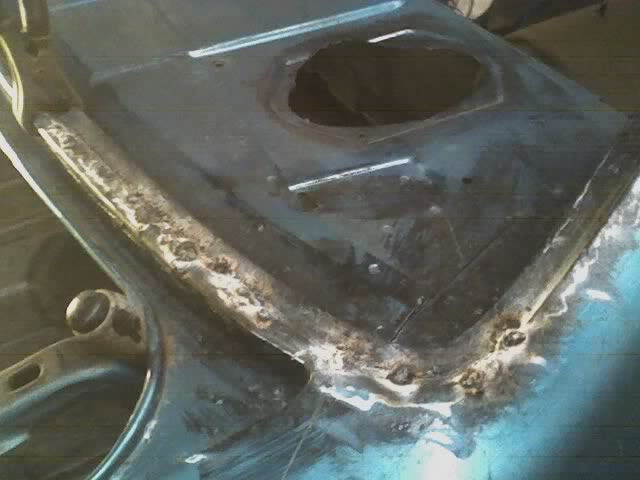

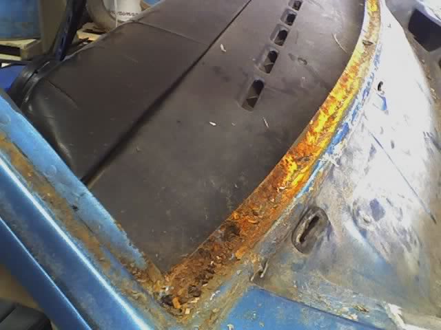

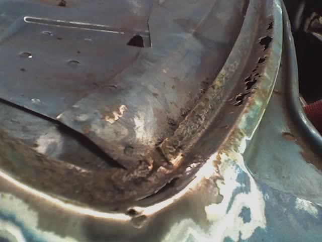

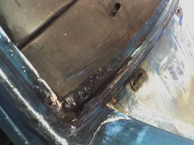

Well I got the rear window out today and this is the outcome..
It's reasonably good.. I wire brushed all of the surface rust off and it doesn't look to bad.. There are a few holes but nothing serious.. I am going to try to mig it all up. Might even cut out some strips and weld new bits in. Will see how game I get later this week lol..
The rust shown in the pics is the only rust, the rest is perfect..

Posted 05 April 2007 - 09:59 PM
Today I painted all the window rust with rust convertor.. Left it to dry over night, and I am going back early tomorrow morning to weld up all the holes.. I also bought some fish oil and went nuts in all the seals everywhere. Smells beautiful now lol..
I'll update you again tomorrow when I finish the window.

Got slack and havnt updated this in a couple days so I thought I'd whack all the new pics and info up tonight..

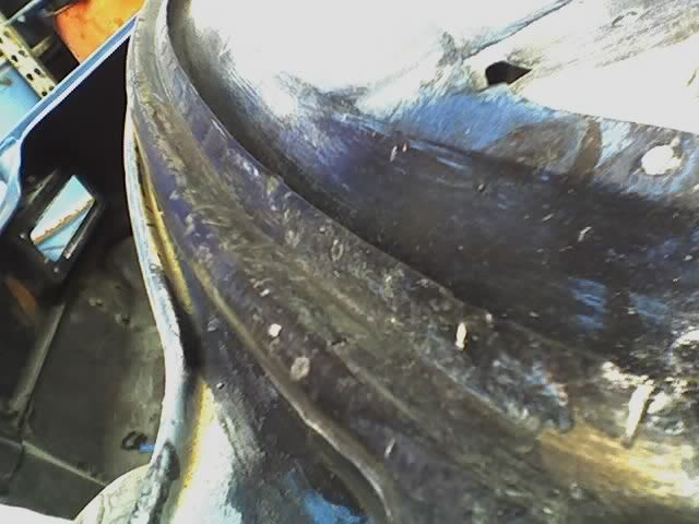

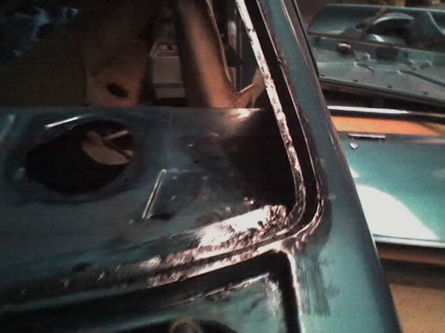

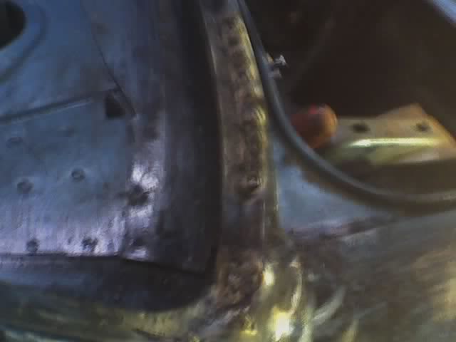

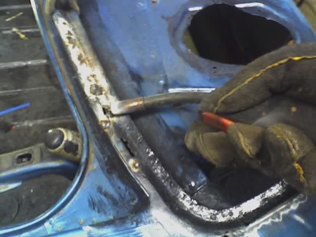

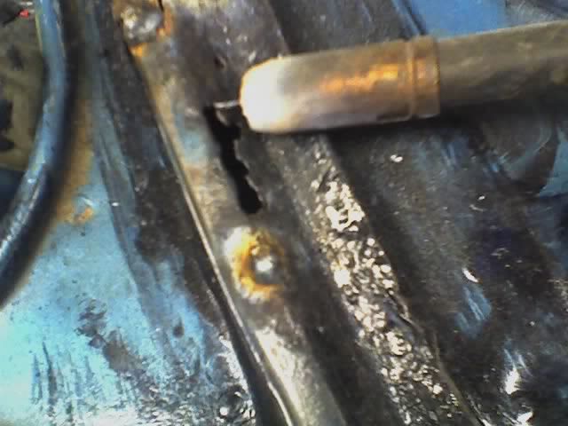

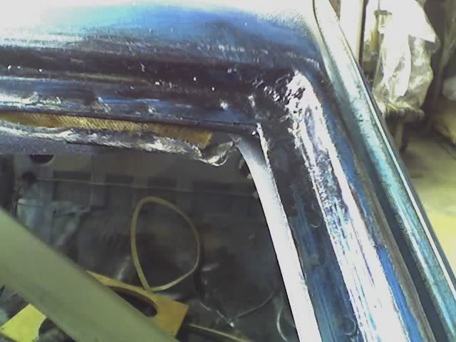

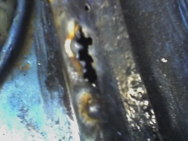

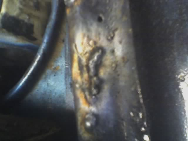

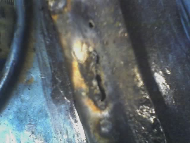

Well after pulling the rear windscreen out I found a bit of rust. It was to be expected however.. Heres a few million pics of me welding up all the holes. I found it easiest to hold the mig on an angle like the first pics is showing. That way you can just keep building up on the previous weld..
This is all the holes welded up.
All ground down and coated iwht rust converter :D Came up killa

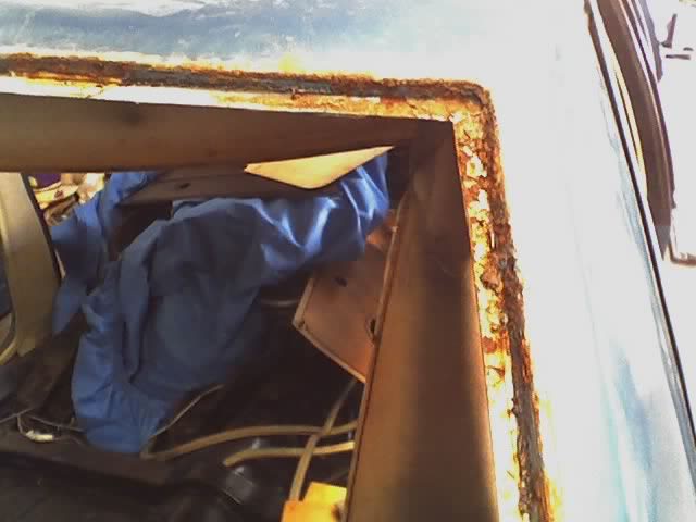

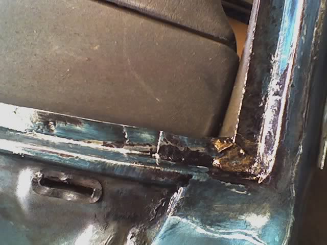

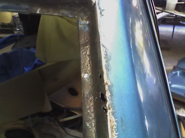

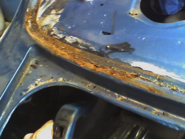

This is the rust that was in the front windscreen. Only a touch of surface rust, no holes :)
Ground it over with a wire brush and a bit of rust converter and she was like new :P
