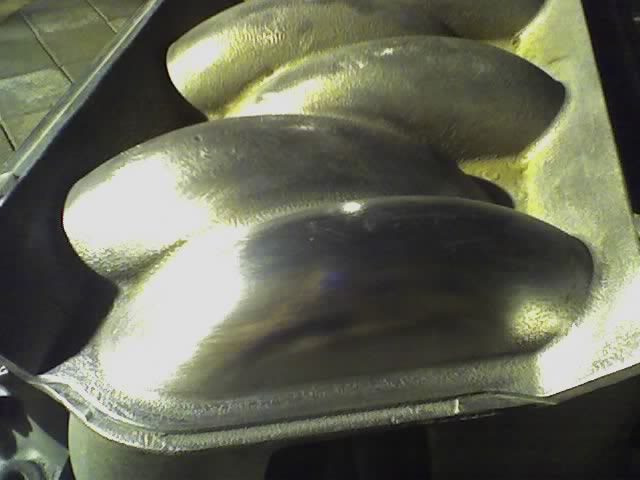

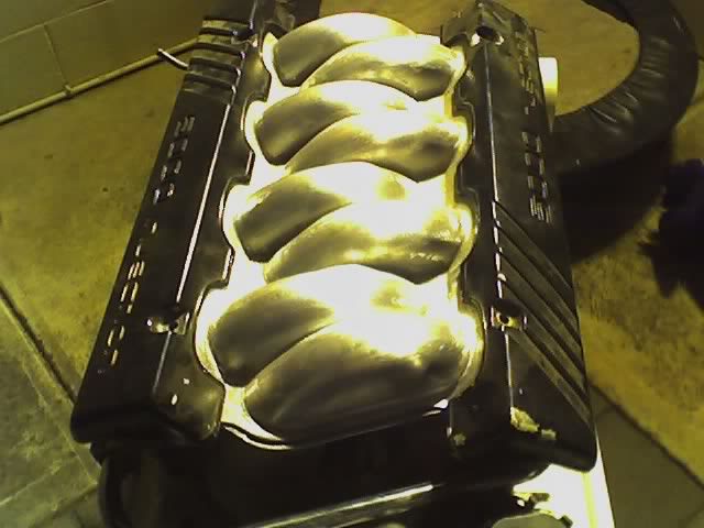

I have also started to pollish my manifold too. I'll get pics in a minute coz I brought it home.

Heres a few pics of the manifold. Its going to be a very, very, very slow process...

Posted 19 April 2007 - 11:20 PM
Ok went nuts tonight with the Ozito dremil type drill I bought last night. 40 bucks, bargain.
Was using 80 grit wheels in it to get rid of all the shit casting look. Then I started rubbing it back with 120 grit sand paper.
Starting to looks pretty good.

#120 Toranamat69
Toranamat69
    Forum R&D Officer
  • 2,117 posts
Posted 20 April 2007 - 08:53 AM
Those manifolds look like a bastard of a shape to polish - heaps of hand work down in the corners.
Have you ever tried the scotchbrite surface conditioning belts? For the accessible bits, you go straight from the rough cast finish to the 400 grit in one go - they are majic things.
M@

#125 _Azza_
_Azza_
Posted 26 April 2007 - 01:14 AM
Heres what it looks like atm. Just started with 240 grit.
Hopefully be finished by the end of next week.
