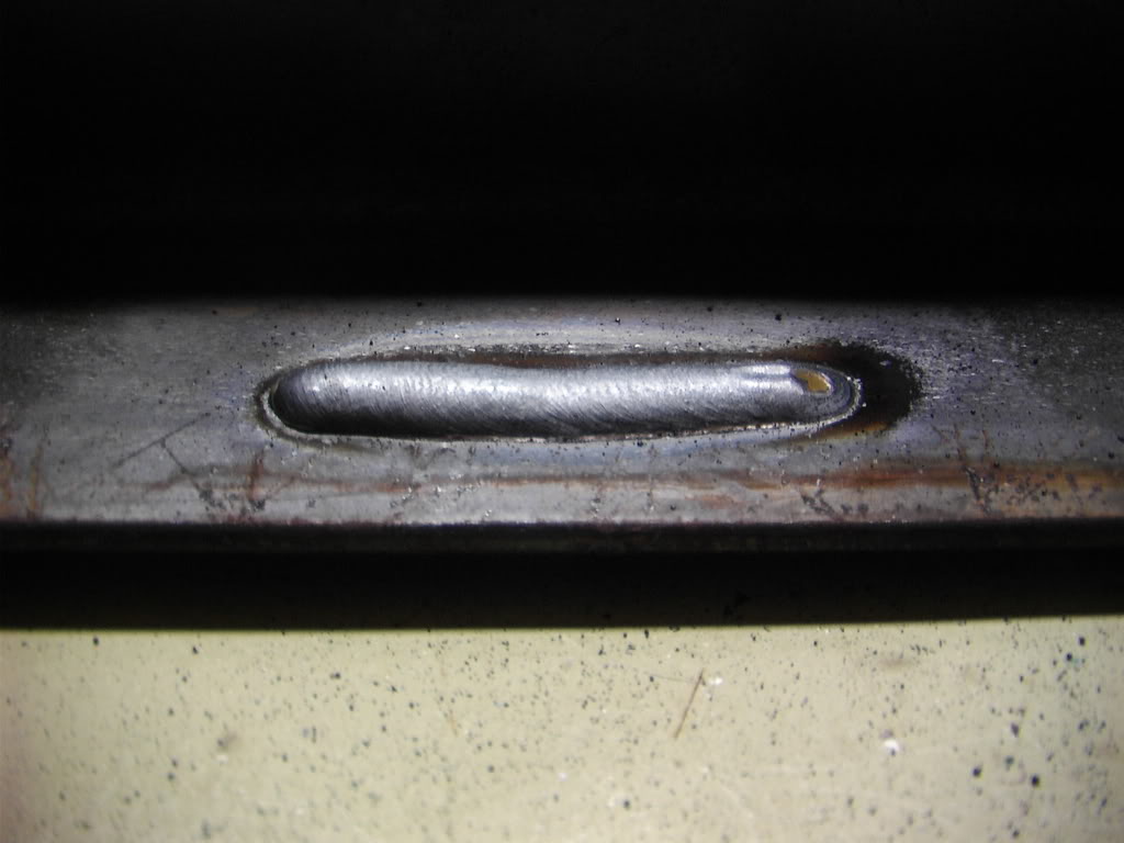

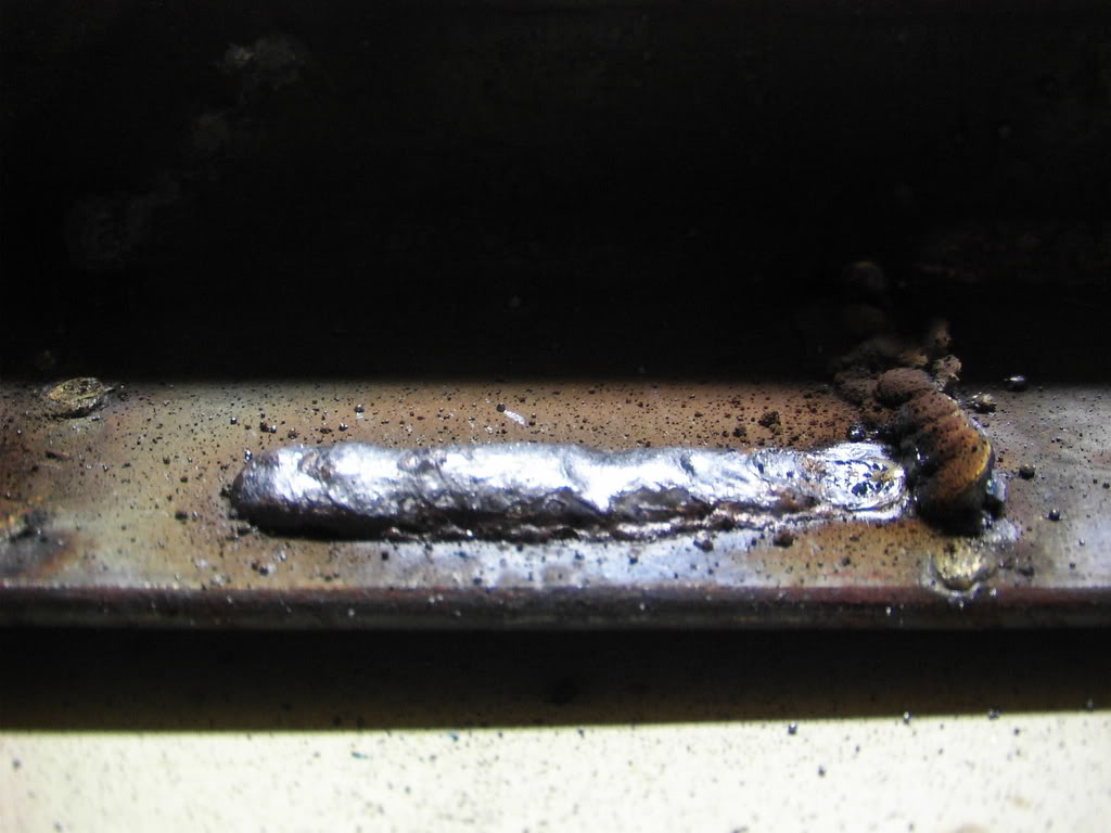

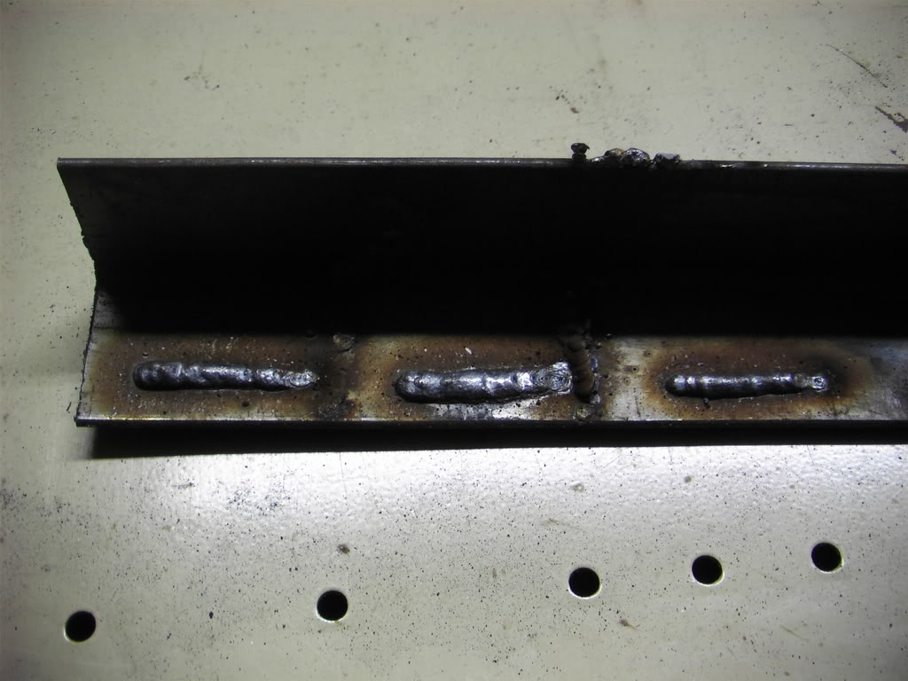

Had a bit more of a play tonight (no I wasnt pulling, I am a pusher :D )
Anyway, I checked the gas and although it wasnt really audible through the end of the torch I did manage to poke a hole in my ear with the wire feed :blink: Nah, not really, but could easily have happened.
I did as suggested and turned the gas off to see how the weld would work.... it didnt. I ended up with a wire spaghetti mess. So I suppose Im getting gas.
I paid more attention to the tip to work distance and I also cleaned up all my surfaces. I took a bit more time with my weld speed and concentrated on the weld pool instead of the arc.
End result from all of this was better than my last efforts. Im still getting a bit too much wire but its getting better.
Here are a few pics from my efforts tonight.
Me in the traditional Gangsta Welda pose. Dont dis me homies or I'll bust an arc in ya eye !!
My gat
After about 15 mins practice
Close up of above. Why does the weld "crater" at the end?
My last three welds. I took a bit more time with these and got decent penetration. I didnt go through the steel but could see where the welds were on the underside.
Close up of my last weld. The weld on the right was one of my very first efforts.
So a couple of Q's.
1.Does it still look like I have a lack of gas issue?
2. How can I avoid the crater effect when I finish my weld?
Still got along way to go but Im feeling a bit more confident than last time.
Cheers fellas,
T

Does the wire seem to 'stab' ouy of the torch? I reckon too much wire mate
For ya crater,
Pause at end of your run and just give the weld a quick dab of wire with out moving , but the less wire will help ya crater also.

Defenatly gas issue personally, without stating th obvious it doesn't still have the "demo" spool of gasless wire in it does it? The welds look like they are done using gasless, note the burn marks and splatter around the weld. BTW I am new to these aswell.

Still having gas issues i would say. The weld looks like it has a "porous" finish.
Looks like you are getting more confident with technique.
Not long now and you will be welding up exhausts with your arm wedged between a tyre and a wheel arch, and your head stuck up between the diff and the floorpan, in thongs, shorts, and due to the lack of space for the helmet, closing your eyes to avoid the arc! :tease:

i reckon luv the uc is probly right, it looks like gassless wire.

Check the polarity the MIG may have left the factory set up for gasless welding. If that is the case just reverse the ploarity. On cheaper machines instead of having a switch on the outside of the machine you have to open the cover where the handpiece goes through the machine and just switch the two wires around. Ive always been told if its got slag let it drag.

OK...........here is my two cents worth in no particular order.
Check the machine, check the machine, check the machine.
1.Read book on polarity of welder. This is obvious, but should be negative ground.Also note that at different times of day, welder may be getting less than 240 Volts which is very common in some non industrial areas, so just note that at 7pm etc dinner time, welder will drop a cog if you are in one of those areas. SERIOUSLY !!!
2. Check tension on roll of wire and make sure that wire is mounted the right way around so it is pulling wire from bottom of roll "through" the rollers rather than from the top with a lot of effort required. With small rolls, make sure it is not so tight that rollers are slipping as they try to pull wire through. THIS IS IMPORTANT!!!
3. Gas pressure and type. I used to simply use a "hot" gas like Corgon 52 or similar, but with general welding , just about any GP will do the trick. You really must be able to hear the gas from the end of the nozzle, and dont be afraid to wind up the gas until you can hear it OR see the difference in the weld.
4. Listen to the welder and hear the stages of weld develop as with modern machines they have several helpful diodes and solenoid adjustments set at the factory.
Start up is always a bitch with heavy plate or cold steel , so just give up on using RHS and find some scrap plate that will have an even temp after u have done a few welds and not get too much pre heat into it. With thin RHS you will be welding like a star with the base material so hot after a few welds that when you turn around and start on a cold piece, you will be disappointed.
With the welder running on your current setting as you run a small line on a plate , get a mate to start turning up the wire speed while you are welding. It will no doubt start to bounce while you are welding , but at that point yell out and tell him to back off until you can literally see the wire melting just away from the job and be careful not to grab the tip and melt it solid!!!!. Ok these are your two extremes of your welding range, so depending on your welding angle, work in between these extremes and if working with cold plate , just dial in a touch more heat to overcome the start up issue. You will "hear" that sharp crack when it is right and NEVER forget that sound , trust me.....I hear it in my sleep after running a welding shop for 15 years!!
I cannot stress enough that the job has to be clean, once you get established, you will develop techniques to overcome dirty or rusty steel , but initially when trying to develop a style, just keep it very very clean.
I am guessing you are using 0.9 mm wire?? It is easy to run the 0.9mm but I am out of touch with the common small welder situation and what is practical. I hear about ppl using 0.6mm and just think this would be more trouble than its worth with any medium ( non panel work) fabrication.
It also goes without saying that you will become an artist quicker than you think, with a calm start up arc and the ability to really feel the end of the weld and know when to just hold it that fraction of a second before you stop welding.
Looking at all pics, I can see a HUGE improvement mate and this is the only way to improve and you would be excited about the improvements. It is a skill you have for life and I hope what I wrote just gave you some more things to consider.
If I had to set this welder up, I would be really looking at the gas and just make some notes on settings, but remember what I said about building up too much heat in a test piece, so alternate between pieces so you can simulate a cold start and settings that mean something.
But...........good on ya for wanting to learn. I had a fab shop with 5 welding stations and a heap of workers doing repetition work for government departments. We mainly had WIA 325's, 400's and one 600, so we got pretty busy and I had a job on my hands keeping the welding plant in good order !!! I hope this helped and sorry if I overlooked anything in set up of machine.
Am convinced that wire used is a flux filled or super core wire, looking at micro spatter and edges of weld.....but again, my humble opinion... Cheers

Thanks for the tips there Pat. I am now at about the stage to start fine tuning the settings for that perfect "Crack... sizzle" because........... drum roll..........
I'VE GOT GAS !!!! :D
I took heed of the advice posted and checked all my fittings. I re-seated the torch hose connection to the body of the welder and (I think this is the kicker), opened my gas valve fully.
Pulled the trigger on the torch and lo and behold I could feel and hear gas coming out.
I ran a few beads and I admit I didnt clean up the steel before doing so but I was keen to test. The end result was this....
Underside
Needless to say I am very happy and oh so appreciative of everybodies help. It is one of those things I wouldnt have picked up on as I didnt know any different.
Now that I have the gas issue sorted I can concentrate on all the other tips given. I'm feeling pretty good about this welding gig right now. I've got heaps to learn but seeing a nice clean bead of steel is cool.
Im going to run around on the weekend and see if I can pick up some thick plate to practice on.
