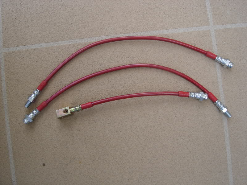

New braided lines!! Sexy RED! Hmmm...

See those pretty red rubber bits at the end of the braid that goes under the steel fitting and crimps
When they get hot enough the rubber goes soft and the hose pulls out of the crimp
They are NOT recommended for motorsport applications
Been nice knowing ya

I am fine with them...Brakewest in Melb have the same style on Ebay,,,as do 95% of the other listings...maybe they have moved forward with design?..All ADR approved..Good enough for me.Pretty sure if they were that bad they would have been banned by now....or we would have heard about the deaths.

The ones with the rubber insert... not recommended for track use cause the ends pull out
Their new ones with what looks like a steel or aluminium anodised insert... I haven't handled one physically... they say they are OK for track use
Just cause everyones doing it doesn't make it right
Just cause its a piece of braided hose doesn't make it the right thing for the job
But hey... its your car... do as you please
An ADR standard means nothing on a track... we all know that
Ring John Margharetti at BQ Melbourne if you want clarification... tell him I said so if you like
I'm just thinking of you mate...I'd hate to hear you lost it cause a brake hose pulled out at the track

Still comfortable...I am not doing 300 laps at a time..or getting 140C on the brakes....reckon it might take a tad bit of heat to melt them...if that is the case....still never heard of it and I have been around the block once or twice...in fact..never heard of a bike braided line failing...or any other for that matter.

A standard brake hose is rubber and uses exactly the same end fittings without the rubber bolster insert in the end
Its got a stronger hold cause its not 2 pieces and doesn't soften like the insert... yet rubber hoses can fail in high temps too of course
Goodridge hoses have a barb on the shank to "grip" the teflon section of the hose... Then the sleeve is metal crimped onto that and there is no way it can move
I have never seen a Goodridge hose pull out... they can break at the crimp like any hose under whip situation ... but never pull out
And you obviously don't know much about this particular brand of hoses and the way they are made
Bike hoses don't get very hot at all
But thats cool... if your not getting them hot you won't have an issue
But I've seen them pull out of at least 4 saloon cars after 3 laps and less on tuning days

Hmmm...interesting...might revisit those bits then.
#313 _rorym_
Posted 15 April 2010 - 09:26 AM
Bugger Datto....just cost me $240!!...Threw those lines in the bin....have new Goodrige ones coming from Comp Friction in ACT.

OK..Tool says I didnt tell him it was a race car..like only 12 times...he is redoing the ends with correct barbed fittings with no rubber sleeve.I will eye ball first...havent ordered the ACT ones yet. Just want them right.Thank you to Datto for the info.XXXXXXXXXXX

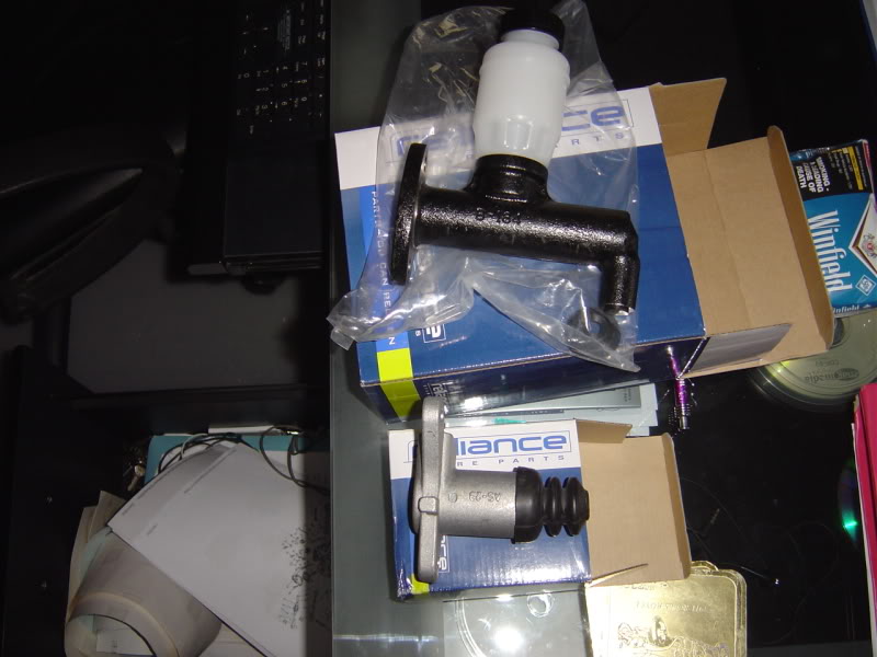

Cooling system finished, put the hydraulic clutch slave cylinder bracket in...cant get the SC until I fit the crossmember to lift the engine.Fitted the dipstick...that took an hour!..bastard!!

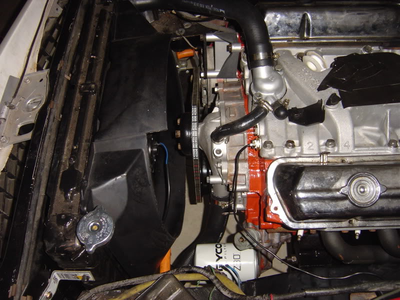

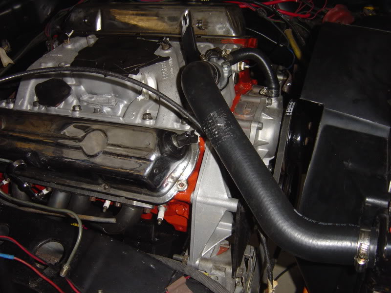

Cooling system finished and correct alternator bracket fitted.VS V8 Commodore radiator.

That's the second pic I've seen today of a Commodore radiator in a Torana, they seem to fit really well, how come this isn't more common? Is it harder than it looks?
#321 _rorym_
Posted 22 April 2010 - 11:37 AM
Nope...2 top brackets...one bottom..
New PROPER brake lines have arrived...with braided hydraulic clutch line as well...brakes and clutch finished this weekend.
