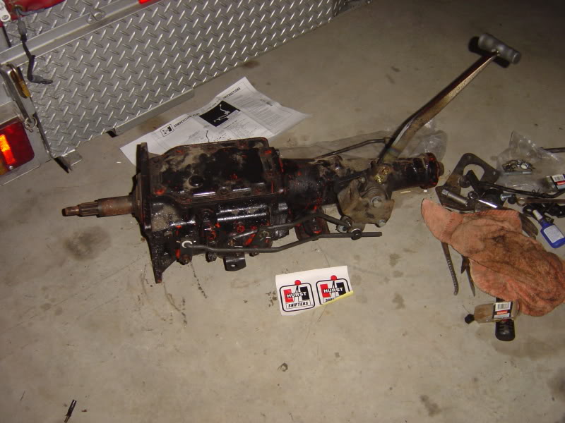

#261 _rorym_
Posted 28 March 2010 - 08:52 PM
FINALLY!!...The motor is ready...pick up this week...ordered the sprung ceramic clutch...bolt that to the box and in she goes over Easter...then just the small hook up bits to do....tailshaft,gauges,electrics..exhaust...

#265 _rorym_
Posted 31 March 2010 - 05:45 PM
Hmmm...clutch might not be here in time..plate has to come from WA..no worry...will fit the engine to the subframe...bellhousing to the box..starter motor, extractors to the engine...and get it ready to drop back in..do all the hard bits so its just a bolt up then back in...nothing EVER goes to plan...ordered the clutch a week ago.Will give the engine another coat of holden Red then stick up some pics of it and the old parts.

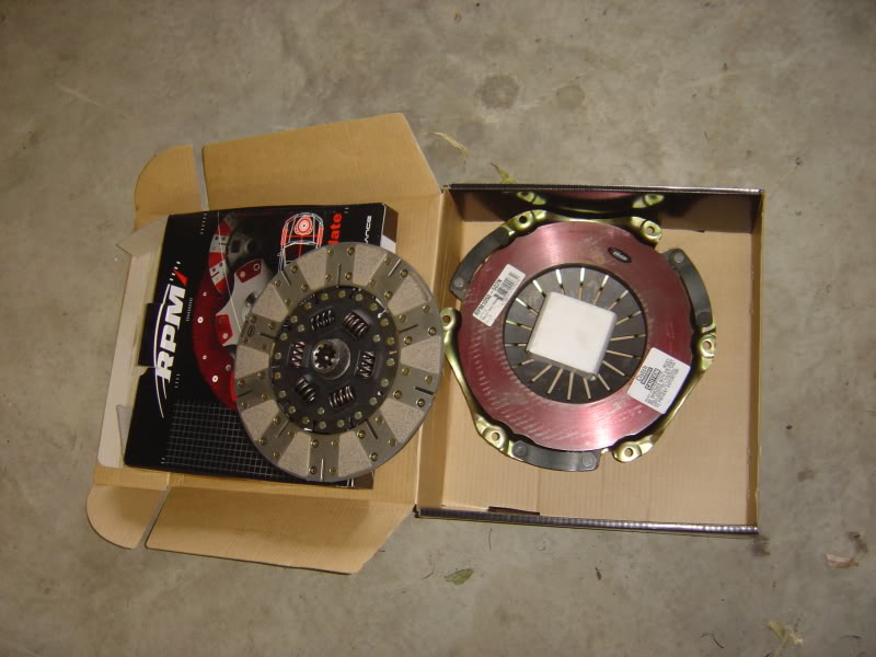

CLUTCH JUST ARRIVED!! WOOHOO!!

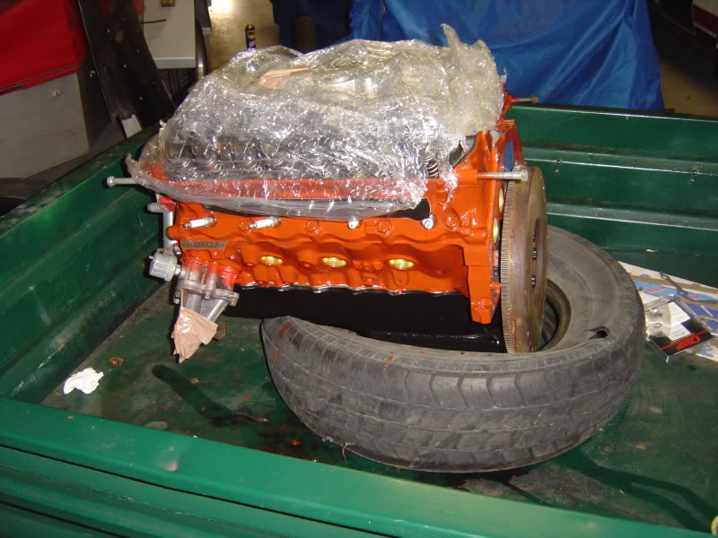

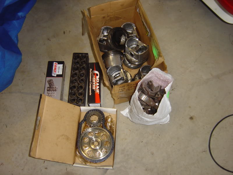

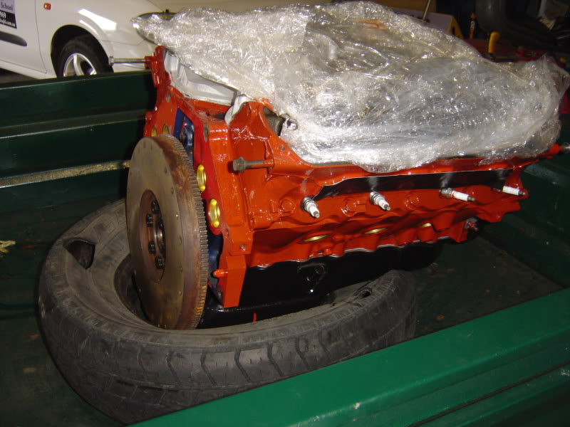

#270 _rorym_
Posted 01 April 2010 - 05:00 PM
Baby is home.
The old bits...some of them..
The ceramic clutch..Jesus have these things gone up in price or what?

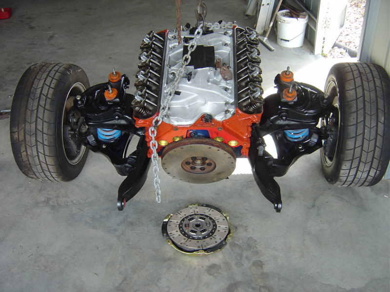

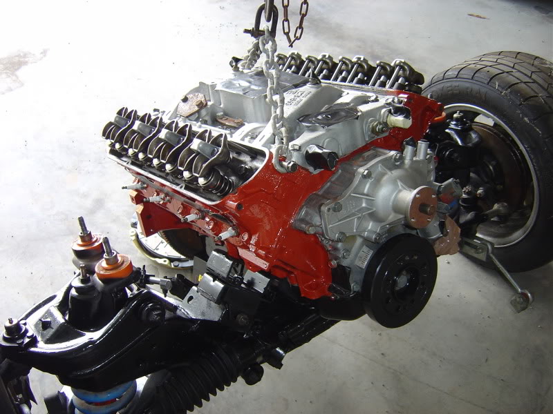

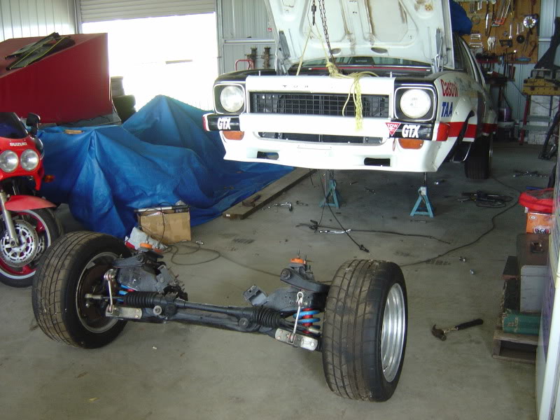

#274 _rorym_
Posted 02 April 2010 - 01:22 PM
Out she comes...subframe had some overspray so I gave it a nice new coat of gloss black.
Clutch and box on next..then starter and extractors..then back under.
Noice! as Bomber would say!
