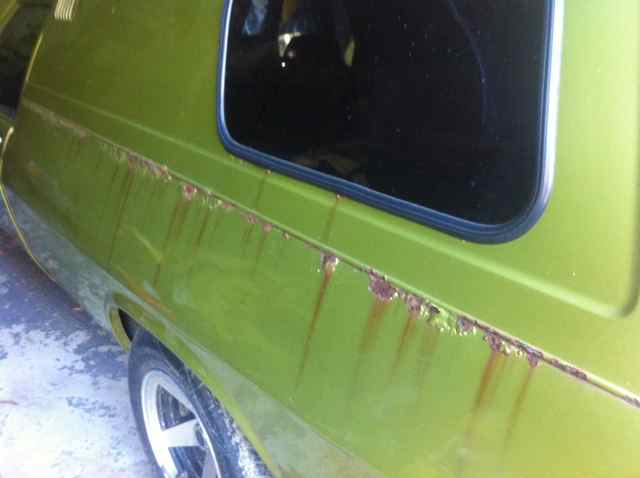

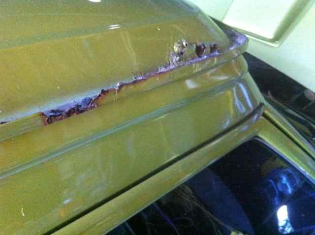

Question : have you ever folded up the section where a panelvan roof meets the ute tray sides (if u know what I mean...), how bout gutters? Ever folded em or just graft?
Here's some photos of my dilemma.
Love ur choice of work'n music. Bit partial to the heavier end of the spectrum myself.
Cheers, Metal up your arse \m/

G'day Scott. Bugger about your collarbone mate! At least there's plenty of good threads on this site to look through. Random picture thread is a good one : )
As for your rust issues, folding up the new pieces isn't a problem. For roof gutters that are really stuffed it's usually easier to cut the gutters off, fix the rust then make and weld on new gutters over the top.
Where the van roof sits on top of the ute quarters was just a giant stuff up on holdens part. If I ever get another van and it has rust there, I'd cut the whole lot out and make a new strip that goes from the panel under the windows to the top of the quarter and be rid of that seam altogether. But that's just me : )
Good luck with it. Post pics!
