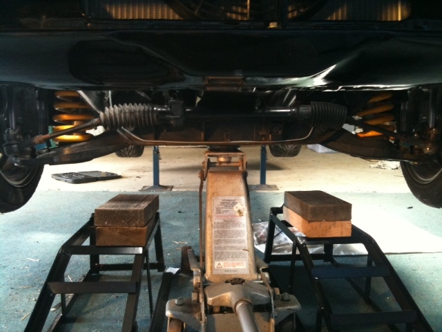

I reckon the ball joint in the drivers side LCA appears to be sitting at an unusual angle in comparison to the ball joint in the passenger side LCA.
I'm thinking the ball joint end of the drivers side LCA is bent up which is causing the drivers side of the chassis to sit lower.
Does anyone else see this or am I just seeing some sort of illusion because of camera angle or lighting or something?
http://www.gmh-toran...-1316940681.jpg
#30 Potta
Posted 26 September 2011 - 04:01 PM
The lower control arm(think that's what its called) on the right hand side in the pic is upside down.
The wishbone thingy's are opposite to each other.
The one on the left has the straighter edge at the top, the one on the right has it at the bottom.
Could be the pic or I could be an idiot, but that seems to be the problem to me.
Hey Potta
What you are describing about the LCA's is normal on an LC/LJ. Because the LC/LJ uses one lower control arm that fits both sides what you are actually seeing is the different sides of the same part. Have a look at your own Torana and you'll see it looks the same.
Dave.
#32 Potta
Posted 26 September 2011 - 04:49 PM
I'll check but I'm not convinced.
The profile looks different, and the right hand side has the lip at the bottom, the left hand side has it at the top.
It could just be the pic, and I have to admit, it's been quite a while since I've been under the front of a torrie, so I'll believe you for now.Posted Image

I am still not convinced this is my only problem?? See the photo's below. I have shimmed the drivers side with about 15-20 mm where as the passenger side has about 10-12mm. When you look front on at the drivers side tyre it sticks out a long way compared to the passenger. No doubt the bent up lower control arm would push the top of the tyre out but it seems the entire wheel sits much further out than the passenger????

That is a pretty bad bend in your LCA, worse than I originally though it might be.
I wouldn't expect you'd need a new upper arm as it isn't subjected to the same forces as the lower arm.
I would just replace the bent arm (or it may be possible to get it straightened) and see how it goes. Looking at your pic the bottom of your drivers side wheel is going to come out a fair bit with a straight LCA and this will enable you to remove some upper arm shims.
Also replacing the bent LCA will affect your toe in setting on the steering rack tie rods. Maybe the drivers side tyre seems to stick out more at the front because you have actually got toe out instead of toe in.
BTW, personally I would throw those blue urethane lower bump stops and get rubber ones. The rubber bump will be a bit softer and won't transfer as much sudden shock to the ball joint area of the control arm if the suspension bottoms out. If that makes sense.
Dave.
Edited by S pack, 26 September 2011 - 11:14 PM.
