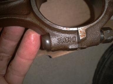

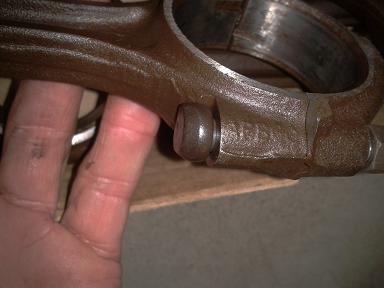

This rod looks like cast date could be G0 = July 1970
This rod looks like cast date is K2 = October 1972

Hi Dave. Im not using those rods.. the engine builder has got me some better after market rods with better/stronger bolts/studs.. cost was $500.. The original engine was thrashed, rebuilt a few times by the look.. was at very worn 60thou.... The oct 72 seems right as from my research..it probably was the last time it was rebuilt.. ill check the rest when i see it again...
Hey Mike

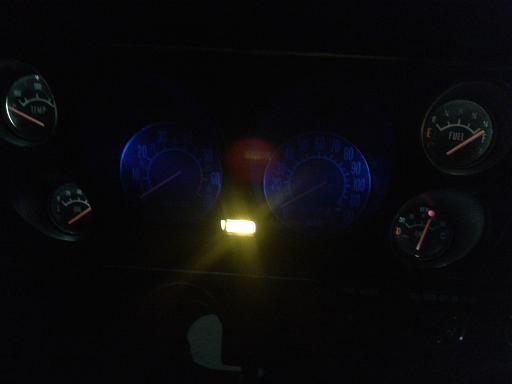

Dash bits are in and working.. The guage post aint blue enough or the speedo/tacho is too blue.. Ill put some blue LEDS in guage post and see if that helps.. are they ment to be VERY blue????

Way too much blue in the Speedo & Tacho Mike. The lighting in the 2" instruments looks about correct.
Thought so..
Dave.. In the speedo/tacho there are only white LEDS, not blue, mounted in the original "blue" plastic cups on the back... I have white LEDS in the small guagers as well??????? and the small guagers have the "blue" plastic ring in there....using all the same whattage LEDS.... in ALL bits. As you can see, major differnce in colour?????

That is interesting Mike. Do the speedo & tacho lights appear that blue to the naked eye or only in the photo?
LED's????? The original bulbs are incandescent.
they are "blue" as per pic...Does the type of bulb matter? The leds are not the cheap directional ones, they a throw the light evenly. Seem to have a more even light than the original bulbs.
I chose LEDS as they burn cooler... Most dashers Ive done have burn marks form the original globes on the blue plastic bulb holders.

If you want the original look you'll need to go back to the incandescent bulbs or perhaps remove the blue bulb masks from the speedo & tacho lamps.

Mike, have you checked the voltage going into the LEDs for the different gauges? In my experience differing voltage can change the colour of LEDs slightly.
