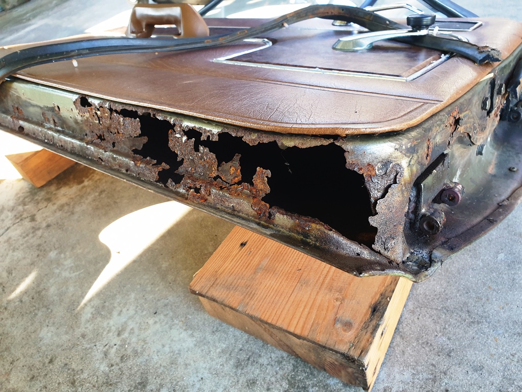

I had a go at getting the door off.  The top pin moved with the first tap which gave me great confidence.  The bottom one just bent for about 3 hours and I ended up ruining it but it conceded in the end!
So the door came off and along with it went any hope I had of a few quick rust repairs and a roadworthy car in the near future...  I'll admit I'm in way over my head here with respect to my previous experience but I reckon with a good few stuff ups along the way I should be able to get a half useful result.

#257 sibhs
sibhs
  • 2,724 posts
  • Name:Martin
  • Car:LJ Coupe S
  • Joined: 27-July 12
Posted 11 April 2022 - 07:23 PM
Wow Steve. That door is RUSTED! If that's the worst of it I'd try fixing it.
Bend up some new steel and weld it in. Easier than it sounds I know.  If you fail, you have learnt something, I hope.
Marty
#258 stevemc32
stevemc32
  • 324 posts
  • Name:Steve
  • Car:LJ 4 Door
  • Joined: 14-September 12
Posted 12 April 2022 - 05:27 PM
Yeah I reckon I'll give it a go.  There might be a couple of attempts but lets wait and see.

#260 Heath
Posted 19 April 2022 - 10:47 AM
We all start in life with no sheet metal & welding experience.
It's nothing that can't be overcome. :)
That is a pretty nasty corner of that door. I hope they aren't all like that, lol.
#261 S pack
  • 15,754 posts
Posted 19 April 2022 - 02:33 PM
I'd be inclined to look for a better door instead of attempting to fix that.
Even if you could get a door that the skin is stuffed but the frame is ok that you could use as a donor to fix yours
#262 stevemc32
stevemc32
  • 324 posts
  • Name:Steve
  • Car:LJ 4 Door
Posted 21 April 2022 - 01:10 PM
Cheers fellas,
I believe this door is the worst of them, the other front door is similar but the rear ones seem to be ok so far.
This one is kind of at the point where I guess there's no harm in attempting to fix it and see how it goes.  If I stuff it up then I can always look for a replacement but there's plenty of other rust to fix on the car so I've got to learn how to do it sooner or later.  Going to pick up some steel and a bender soon to get it underway though I might look at replacing the sill and cleaning up the A-pillar before attempting the door.
