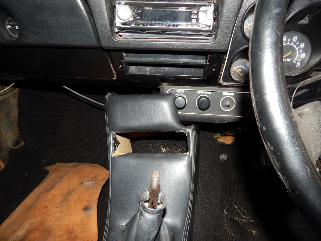

Modified my console so it fits better. It is an LC console and I have an LJ lower dash like much of the car.
It used to sit like this
So I decided I may as well modify it while it was out of the car.
This is how it started
Attached File  IMG_2055 (Large).JPG   187.06K   1 downloads

I carefully removed a heap of staples from the back so that I could get access to trim the wood and foam.
I was originally going to use my jigsaw but it was only very thin plywood and it would have ripped it to shreds.
So ended up using some "Power scissors" and a stanley knife to get the job done.
Sorry about the picture rotations, computer is being a d!ck.
Peeled back the outer cover to reveal plywood and foam
Attached File  IMG_2057 (Large).JPG   160.81K   1 downloads
Trimmed the foam to suit
Attached File  IMG_2058 (Large).JPG   143.76K   1 downloads
Trimmed the wood then put the cover back on using a staple gun.
Attached File  IMG_2060 (Large).JPG   189.63K   1 downloads
Now fits way better and more forward which helps with the gear stick, hand brake and mounting it so pretty happy with the result.
There is a bit of a gap but i'll sort that out later.
I also put some velcro on the bottom so that the carpet will stick to it and not expose the tunnel where I have cut out the hole for the shifter.
All in all a good days work, and hopefully going over the pits again this week.
