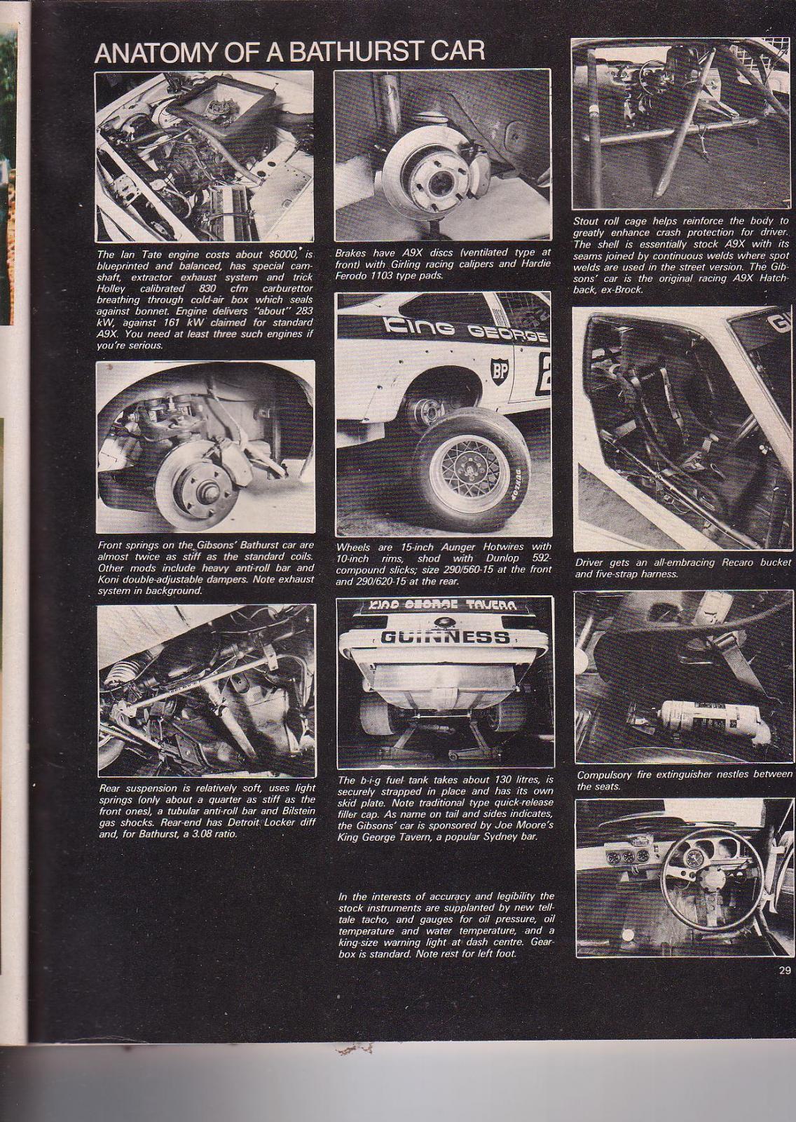

In 78 Wheels mag did an article on the King George Tavern A9X driven by Gibson. Although they used Dunlops whereas 05 used the taller wider Bridgestones it gives you a clear answer to the speed with the 3.08 gearing. Nobody used more than 6500rpm down Conrod in the race as it was hard enough (in the era) getting the plastic motor to last a sprint race let alone Bathurst. The old plastic during this period was a very marginal race motor and it would hand grenade at the drop of a hat let alone exceeding 6200rpm for any long duration. During Hardies Hero's Brock was pushing it and would have been doing 270-273Kph but in the race he would have been 8-10kph less. Unlike modern 2013 Bathurst it was a 50/50 race (survival vs speed) and was far more biased to survival of the fittest.

If you look at the story on the Gibson car it says they are a 620, 620mm rolling diameter equates to 24.4inches. The HDT tyres in 79 are bigger than that. Remember HDT were on Bridgestones exclusively in 79, no other team was allowed to use them.

In rough round number speak the fronts are about equivalent of a 30 profile the rears 50. Race tyres are width, rolling diameter, rim size. So for instance on the Gibson A9X above in wheels mag its rears 290/620 -15 and fronts 290/520 -15. Divide rd by 25.4 for height.
Peter%20Brock%20Holden%20Dealer%20Team%2
At the end of the day 260-265kph in the actual 79 race was about it. You could obviously push a few more revs out of the plastic motor but you have to get to the end of 163 laps and the old plastic never liked sustained revs over 6200-6300rpm without it wanting to throw a leg out of bed.  The taller tyre would have been more about saving the plastic from a melt down by having to pull less revs down conrod. Have to remember 400hp was max and most 79 teams probably only had 380Hp. The Frauds had about 100hp more but no Fraud attended jenny craigs and so carried about 350kg's more.

6500 rpm / 3.08 diff x 26.6" rears = 268.8 kph
Well done everybody as this is the exact speed Brocky did down Conrod from Information available so far. Dave I
