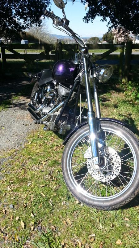

Im starting to think the front end needs to be lowered because i just hate looking at it from that angle.
How can i go about doing this? Cheap vs properly?

Your's doesn't look that bad from the last pic you posted, do you have a later pic showing it side on?

Looks fine from the side (thats the latest), But i absolutely HATE it when i see it from the front. Is it a harley thing? Just looks like it has forks that are too long even though they look ok side on.
I was hoping to sort of reduce the rake and length but i didnt want it to bottom out and crash me into a gutter.
It could well be a harley thing... those with more experience with harley's may know. I went the other way when I built this thing, raked trees 5 deg & 6 inch over forks cos I wanted that look. These are the only pic's I have prior to changing the pipes to V&H long shots..
Front:
Side:
As long as it's done right it shouldn't be bad on handling. My understanding, & you probably already know this, is that reducing the rake & shortening the forks will give quicker steering & handling into corners & stuff. Not the kinda thing I worry about riding this thing of mine around...lol

I know the handling will be better, i was just thinking i have to make sure it cant bottom out under heavy braking or bumps. But then again the brakes are so bad i dont think they have the bite to compress these forks! Do i just loosen the clamps and let the bike move down?

You could try sliding the forks up but I would move them up more than 1/2 - 1inch. I don't have first hand experience of doing this sorry, maybe someone else could recommend if this works well or not. Guess it could be a cheap way to see if you like the look of a lowered front end  B)
Did a search & this seems to be done by others as well, & there is a good tip on how to check how much you can slide the forks up too:
http://xlforum.net/v...hp/t-44254.html

Is it the cable tie trick? Ill give it a go an " or so, see how it turns out. Thanks
