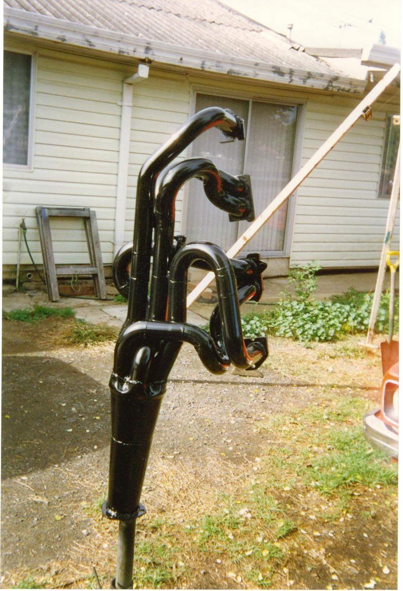

Great Job Dave,
 Daniel ( Datpsi ) is going to do an extractor change on a dyno sometime soon,
 where other extractor types will be changed to see the differences.
Anyhow, keep up the great work.  :clap:  :spoton:
Like button for your 6 into ones. :)
p.s. you could change your collector length to 12 to 15 inches to see if there is an improvement.
 just saying what we have learned so far in the greatest forum ever.  :driving:
This 6 into 1 set, Rich ( rich243 ) put up in the 202 extractors thread:-
http://www.gmh-toran...e-3#entry955770
I did a little altering to his photo up there ^:-
Attached File  Rich HM9yc.jpg   47.59K   1 downloads

The best fancy pipe work goes into the little torana.
Warren ( warrenm ) has a beauty too. :)
 not 6 into 1, but nice and fancy work to fit:-
http://www.gmh-toran...rs/#entry826428
 and notice how we have to accommodate for the access space,
 in all the extractor designs, for where the starter motor is.  :furious:
