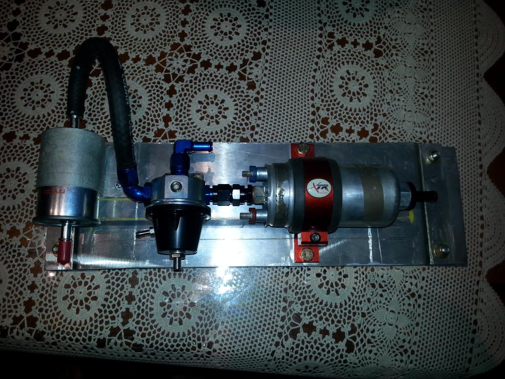

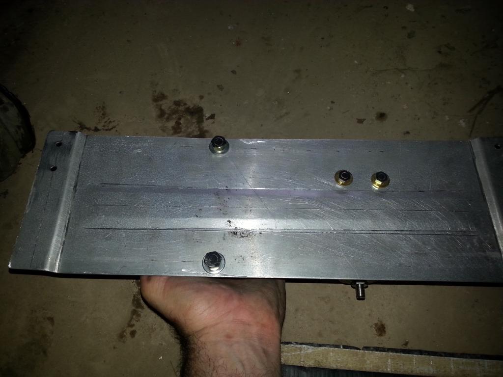

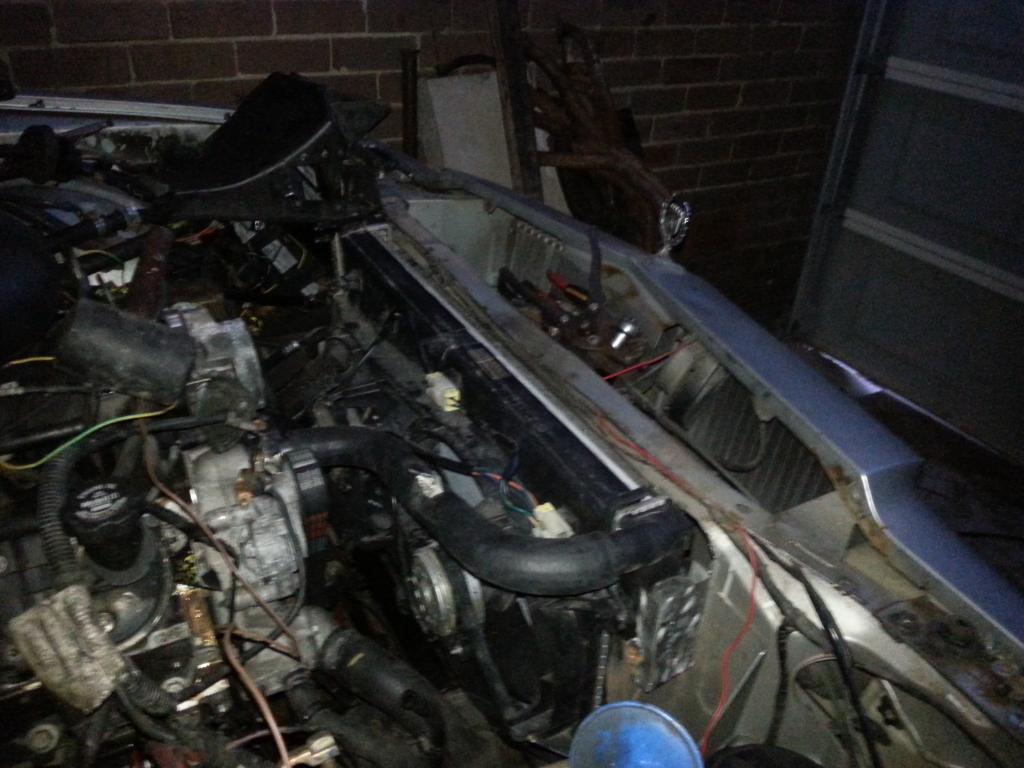

Nothing too fancy. Pretty basic setup with a return-less fuel line for simplicity, and laziness as I didn't want to make up a return line (Even though the fuel does return from the regulator to the surge tank.
Also got the radiator trial fitted in
Just a shot of the beading in the middle of the aluminium plate to stiffen it. Done with the bead roller.

Thats the radiator from the Commodore Senator, decided to go this way as this radiator is pretty much off the shelf if it ever goes wrong as opposed to custom stuff. Plus all the gearbox and water hose fitting screws and plugs in no worries including the fan/shroud

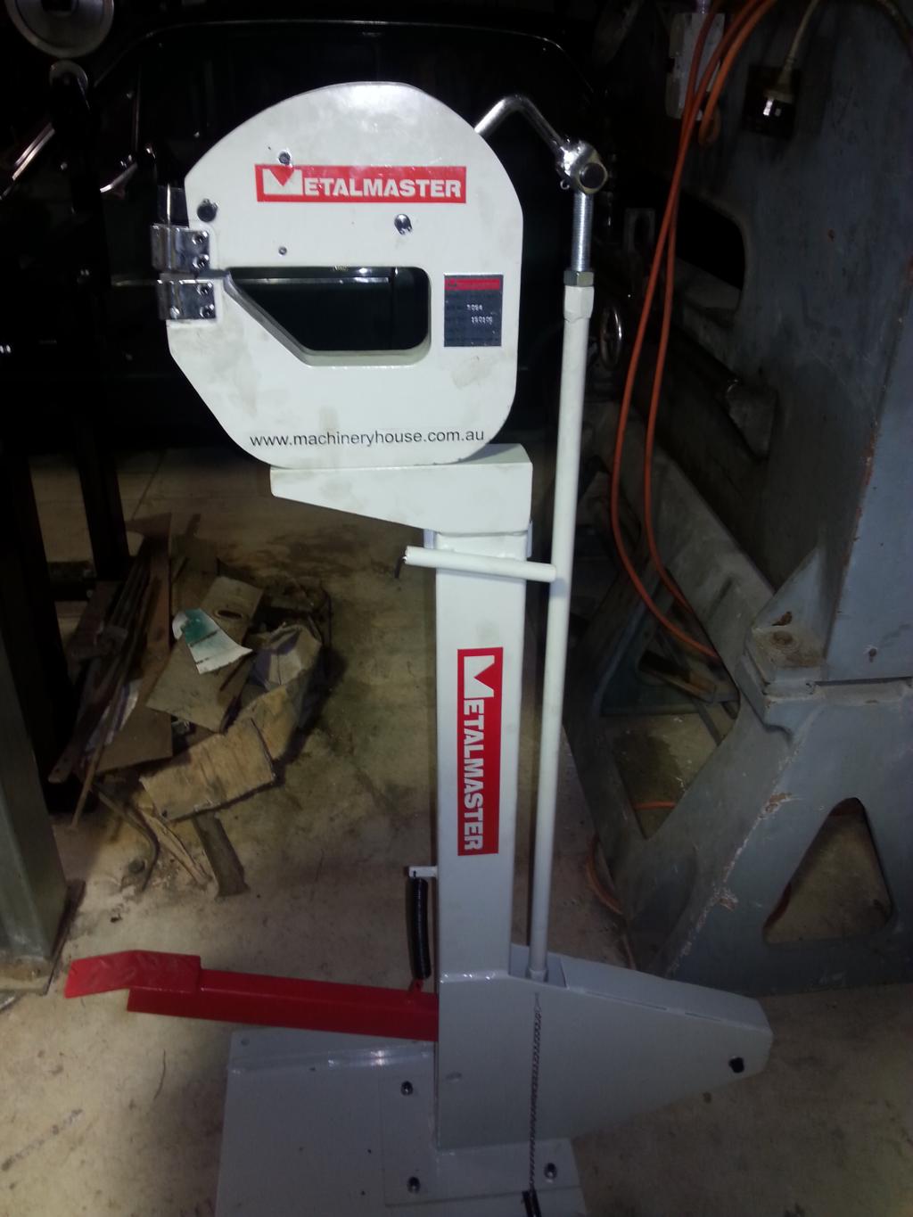

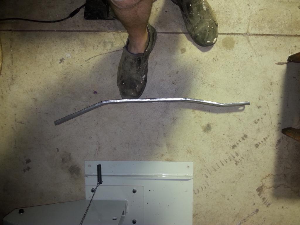

Making bottom support panel for the Commo  radiator, with my new toy.
