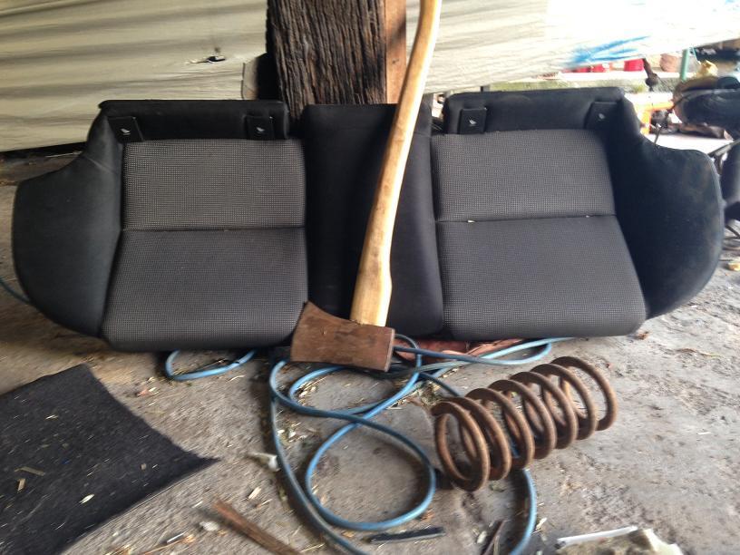

Posted 06 October 2016 - 09:24 PM
off with it's head
3 pins removed and material folded back
chop away, and with angle grinder, that metal had to go.
test fit
and now lower seat anchors meet footwell, bonus
20 pins and a quarter of a tube of araldite later, waiting to dry
_____________
and the shoulder skin, removed off the liberty's plastic moulding.
bottom perfectly moulds to tory hub, top need to be recreated.
bought some firm foam from clarke rubber to make the two shoulders.
Edited by livo74, 06 October 2016 - 09:25 PM.

cheers andrew:)
#246 _livo74_
_livo74_
Posted 07 October 2016 - 01:44 PM
far from finished.  more padding out, patching (read: glueing) missing sections, anchoring seats etc etc to do
but gives me good idea of finished product, which i really like.
(hmm.. camera pics give idea of "dark grey and light grey" seats", when really almost "black and dark grey" in the flesh. odd)
Edited by livo74, 07 October 2016 - 01:45 PM.
