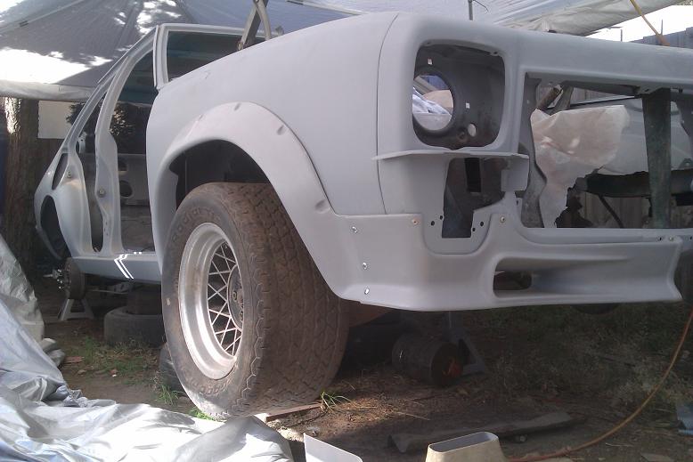

Posted 22 September 2016 - 05:26 PM
taking ..just a little longer than initially planned...
anyone else had that problem?
fitting flares is not as fun as i hoped. friggin need to be chopped/shaved/yanked in every direction
chopped much? yes.
bent inwards to remove sharp edge
Edited by livo74, 22 September 2016 - 05:30 PM.
#204 _livo74_
_livo74_
Posted 22 September 2016 - 05:36 PM
never going to fit. (forum members warned me was going to be the case.)
followed other peoples leads,
..only not as well.
got there in end prettymuch.
welding, metal filler and primer later, as good as i'm going to get it.
on to other one.

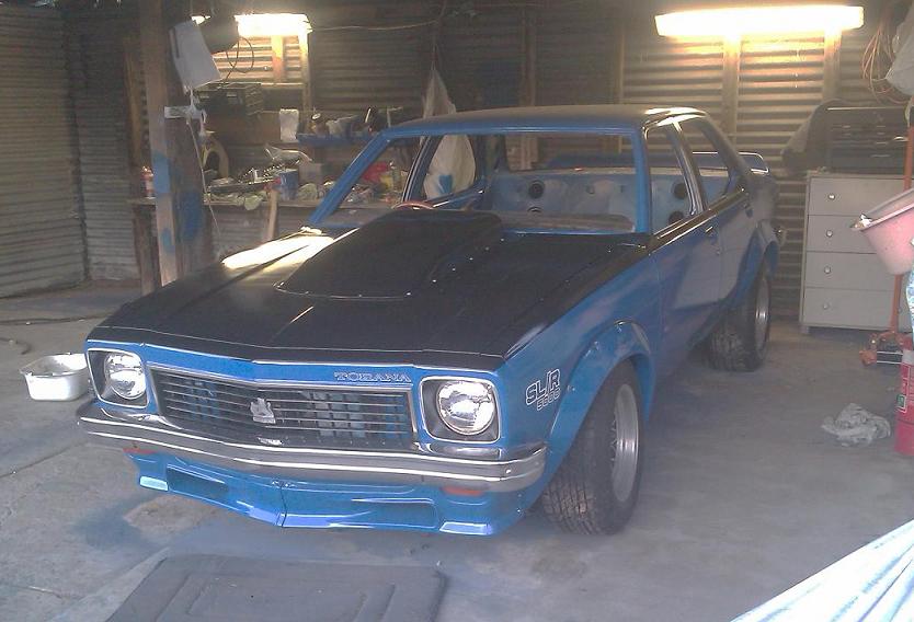

#205 _livo74_
_livo74_
Posted 22 September 2016 - 05:41 PM
sikaflex to stop(??) rattles
(had a pic showing pop rivets then added. cant find it.)
made to fit 9 inch filter. has 11 inch sides
(now think should of gone bigger in retrospect)
starting to look a lot like MY torana.
a very happy day, can tell you!
#206 _livo74_
_livo74_
Posted 22 September 2016 - 05:50 PM
am rapt. am very lucky.
(won't ever be a show n shine though, i can assure you!)
but if anyone was wondering can it be done on a budget of a pauper, it can. don't let that stop you having your childhood dream can in the garage.
and serious thanks to everyone support and advice in the threads!
