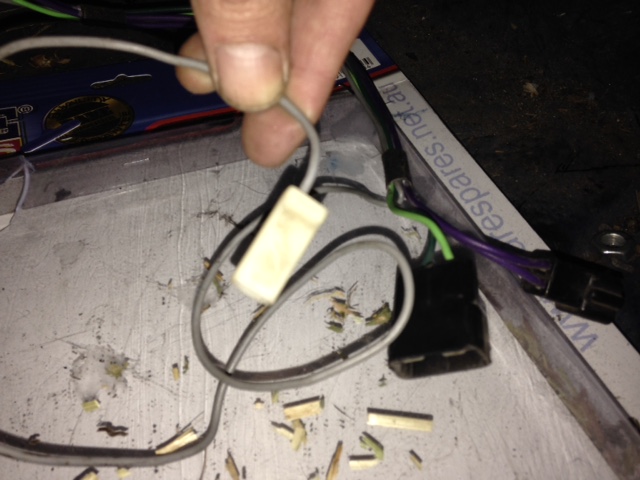

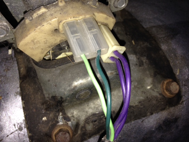

Posted 30 April 2017 - 10:54 AM
can't read wiring diagrams for shit. darn it.
tried googling images of peoples shifters to see if plugged correctly
as for these.. i don't have a clue where they go.
do they go here??
"Reverse switch", i believe it's called.
connections don't seem to match up from what i can tell
Edited by livo74, 30 April 2017 - 10:55 AM.

#489 gtrboyy
gtrboyy
  • 3,241 posts
  • Location:SYDNEY,NSW
Posted 30 April 2017 - 07:36 PM
Purple for inhibitor/starter
Greens for reverse lights
Orange is kickdown -pedal to probe thing side of auto,shouldn't need to tap wire...I'd leave4 it alone!!! Later on can check with test light if got acc power then push pedal down both will power test light.
Grey is illumination light globe for selector panel

#491 gtrboyy
gtrboyy
  • 3,241 posts
Posted 30 April 2017 - 10:55 PM
Should be simple plug change from auto to manual...usually manual cars have small bridged plug for purple starter wires you unclip then add small auto harness that has purple wires to inhibutor on tbar,the revers light wires & grey wire for indicator light.
Kickdown wire + earth thing are usually left clipped to auto,rarely taken off.
You got some more searching & parts tracking to do methinks to find out what's needed.

#493 _livo74_
_livo74_
Posted 01 May 2017 - 08:53 AM
"small bridged plug for purple starter wires you unclip then add small auto harness that has purple wires to inhibutor on tbar,the revers light wires & grey wire for indicator light."
that would be sweet! will do some searching
and guessing.. kickdown feed can come out of anywhere, just has to be an "ignition on" constant power source.
Edited by livo74, 01 May 2017 - 08:56 AM.
