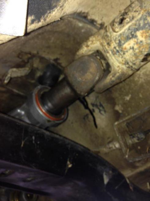

#434 _livo74_
_livo74_
Posted 05 March 2017 - 01:25 PM
latest endeavors
 so.. the vac mod to auto tee  on manifold plugs into here?
how does it stay on? (doesn't seem long enough to attach any clip/clamp)
and, andrew,
it's....  green!    green???
added info, the old cable one was... white
what's green and my red in the kph matchup..?
or..
any chance the green internal to white cable.. is the "hundred k's/spot on" matchup??
(as the tops just pop off and can change. well, mine do at least)
Edited by livo74, 05 March 2017 - 01:29 PM.

#436 Bigfella237
Posted 05 March 2017 - 01:52 PM
Disregard my concern over the torque converter bolts, I can see at least one nut and bolt is done up (and there's only 3 of them) so assume the other two will be done up as well.
Hmm... a green drive gear, well that's different! I've never seen any mention of a green drive gear for the Aussie boxes before, the only ones I have listed are:
Red - 7 tooth
White - 8 tooth
Blue - 9 tooth
Yellow - 10 tooth
The only green one I have listed is a 9 tooth gear for the American boxes (Muncie / Saginaw / Powerglide / TH350), I wonder if they fit and somebody has been playing with it?
Can you see in there well enough to turn the slip yoke by hand and count the number of teeth? You're counting the number of new teeth that start on one edge, you will need to mark one of the teeth with a texta or similar so you know where you started from.
If it is a 9 tooth drive gear, use your red driven (cable) gear, that should be close enough (works out to a reading of 103 when you're actually doing 100).
#437 _livo74_
_livo74_
Posted 05 March 2017 - 02:15 PM
not a chance seeing in there sorry
camera jammed up into crevice to get that photo!
if am correct, going by the photo it's a ??6 tooth gear?
to get access to attach trans oil line.. i can put jack under yoke and remove crossmember and lower/drop trans a few inches can't i?
a good idea to install the missing engine mount bolts before i do? or not.
be hell getting to the return one without lowering, am suspecting.

#439 gtrboyy
gtrboyy
  • 3,241 posts
  • Location:SYDNEY,NSW
Posted 05 March 2017 - 03:32 PM
Clean that tailshaft,slip yoke in THEN pull back into diff...after that check seal groove worn in slip yoke lines up...main difference between 6cyl & 8 cyl is size of universals.
Those cups for rear uni will be ok as long as pins didn't fall out.
Green gear most likely commodore probably sle with 2.60 diff...will look it up if can remember where info is.
https://www.google.c...jJTTphx3JMnENew
Above link on right punch in tyre size,the drive/driven gears & diff ratio.
Yep looks like missing flex plat bolts too
Modulator hose has to be tight fit so no vacuum leaks
Edited by gtrboyy, 05 March 2017 - 03:34 PM.

#443 gtrboyy
gtrboyy
  • 3,241 posts
Posted 05 March 2017 - 05:55 PM
Eunuch it's missing fair amount of parts,likely vb 253 mixed with odd bunch of parts parts
Most trimatics have 3 bolts + nuts,high tensile things.
Hose to modulator apparently same size as vac advance on dissy but practically force the the on it's tight fit...will be ok temp fix,same as transmission hose looped around to bridge those cooler lines
TBH always used 6cyl shafts to get driving cars driving although been years vaguely remember majority parts interchange so should fit when bolted in
Yoke probably goes in further than you think dont forget with suspension travel & drive movement it slides further in.
Could be engine brackets/mounts bolted in wrongly....usually something simple like lift & reset...who knows yet.
Bit annoying at amount of simple little parts missing or just what previous owners did to it.
Think green gear is same 9 tooth as blue not much info found on them think green 253 sle trimatic(reason 15" rims) 308 sle(yellow gear) BUT not much info out there.
#444 gtrboyy
gtrboyy
  • 3,241 posts
Posted 05 March 2017 - 06:06 PM
Cant tell 100% untill clean up & bolt tailshaft in.
My guess is if green gear 9 tooth you'll need yellow 24 tooth gear with 3.36 diff & 245/60/14 tyre means 1% underdriven(slow) speedo
I'd say with quick guess  all bolt ons missing off auto from those pics
modulator pipe
flex plate bolts
trans cooler lines + new hose
crossmember bolts/mountr bolts + spacer
talishaft u-bolts

I think the metal tab was only a "lock tab " that went under the nuts and was bent up over a flat on the nut that held the U bolts to the yolk to stop those dreaded little factory lock nuts coming off for safety reasons ?
Edit, i think you will find that the 6 cyl. universal j's will be fine on a 253 with 336 , there are 202's out there making more than a stock 253 and they don't seem to have too many problems ?
Edited by EunUCh, 05 March 2017 - 07:55 PM.
#449 _livo74_
_livo74_
Posted 05 March 2017 - 08:21 PM
gotta admit, you guy's are braver than i !!!
first, if movement is only 15mm ish either way, that leaves about 3cm left in shaft..??
now, this car setup is never going to supped up.. but is that enough grab?
and second.. if it pulled back 2 inches... and say.. fell out..
i am going to go ass over tit and on a heck of an exciting adventure.
will ponder.
will see if can get better look for the other 2 flex bolts
cooling lines not plugged..
don't  jinx me eunuch!
(and yet, not optimum, for sure! blocked would of been better to see for sure.)
____________
re: ."just pop cups back on that universal joint"
and
"only a "lock tab " that went under the nuts and was bent up over a flat on the nut that held the U bolts to the yolk to stop those dreaded little factory lock nuts coming off for safety reasons ?"
i'll say safety! cus at the moment they just fall off! can't be right can it???
fear needs to be "pressed"?? out and replaced??
________
and will start putting a wtb list together, ( wanted to have some money before did)
as always, help and advice/thoughts much much appreciated fellas!
i'm getting there, slowly!
