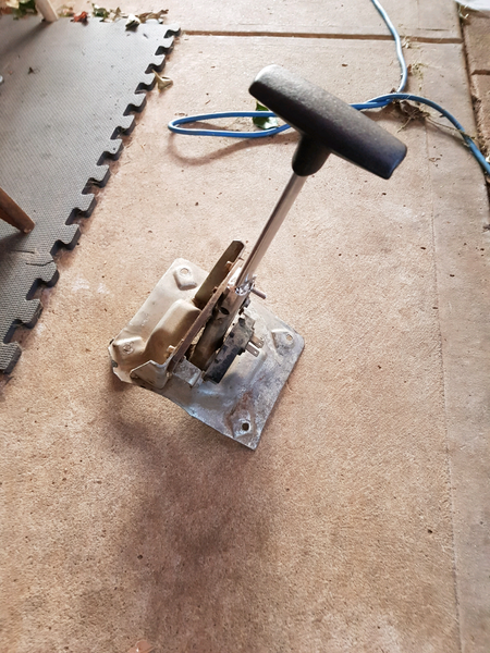

whilst looking for shifter, cam across this of a couple for sale.
hoping that when buy one i bloody get the correct one this time.
anyways, one on car "appears" to be a long "arm"/tag? like the one on the left.
suspect need the one on the right.
will try to buy off someone who knows for sure is standard trimatic shifter, thats for sure

#904 gtrboyy
gtrboyy
  • 3,241 posts
  • Location:SYDNEY,NSW
Posted 13 August 2017 - 08:17 PM
Consult one of the square guru's for confirmation...you'll probably have to track down info & double check for a solution.
Commodore trimatics have selector rod on passenger side I think just maybe uc torana trimatic shifter is passenger side & lh-x driver's side????
Vaguely remember old timer's saying you could tap shaft out of shifter & re-assemble it so bracket goes other side????
Commodore shifter plate etc won't suit torrie tunnel
Do know earlier model trimatics were different with selector on other side,cable or linkage kickdowns too.
#905 _livo74_
_livo74_
Posted 13 August 2017 - 09:07 PM
hoping to consult. have been trying to research too.
here is my trans details that i found
"K O" transmission prefix
===VB Commodore (Series 3 Trimatics):===
KO 253 (4.2L) V8
hmm, series 3.
believe became used when new adr's came in.
so i need a 4.2L trimatic shifter from about late 76 onwards. (th350 and 400 from 5.0L's i THINK have just learnt)
will ponder some more.
comm shifter no good then, cheers
and yes, have to make easy on self and get pass side one.
#906 Bigfella237
Posted 13 August 2017 - 09:42 PM
Yes "KO" is a Trimatic from a 253 V8 VB Commodore.
Only the 304/308ci Holden V8s had the Chevy transmissions, starting with the TH400 from 10/74 (HJ Holden) until 05/79, when they were replaced by the smaller TH350 in WB and Commodore until 11/81, after which all V8 autos were Trimatic again until the end of the VL Commodore.
I can't remember exactly when (Torana-wise) that the Trimatic changed from right to left side selectors, I *think* it was at the end of the LX but don't quote me on that?
So you're probably looking for an auto shifter from a 6 cylinder UC Torana, but with a rod from a V8 Trimatic Commodore? Or if you have a welder just modify what you have now!

#908 gtrboyy
gtrboyy
  • 3,241 posts
Posted 13 August 2017 - 10:03 PM
Uc shifter with your selector rod should do the trick.
If rod is too short just weld extension piece on to it.
#909 _livo74_
_livo74_
Posted 13 August 2017 - 10:38 PM
??suspect rod will be fine.
can extend/weld if needed.
uc's seem the go as you and andrew say. (also wb's from what have been reading.)
guess with a uc there is no guesswork..as only came in the 6cyl, and therefore no 308/th350-400 version to mistakenly buy.
will look into :)

#912 _livo74_
_livo74_
Posted 14 August 2017 - 07:05 PM
a short armed shifter, cheers ron!
brackets don't interfere with console hopefully. if do.. out with the angle grinder! and not for the first time lol
got it! cheers ron!
