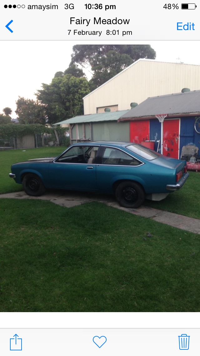

This is only picture I have of if, btw it is fully legal and meets the required departure angle ( in pic. It dosnt look like it but we pumped up wheels fully and bolted it on more and is legal :)
