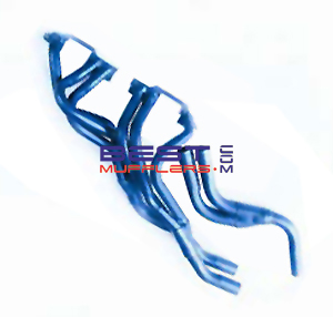

I've used these Hurricane beauties:-
https://www.bestmuff...roducts_id=2448
#61 _STRAIGHTLINEMICK_
_STRAIGHTLINEMICK_
Posted 13 June 2015 - 01:36 PM
These look about the same length as the pacemaker but i think they are press bent compared to mandrel bent for the pacemaker.
