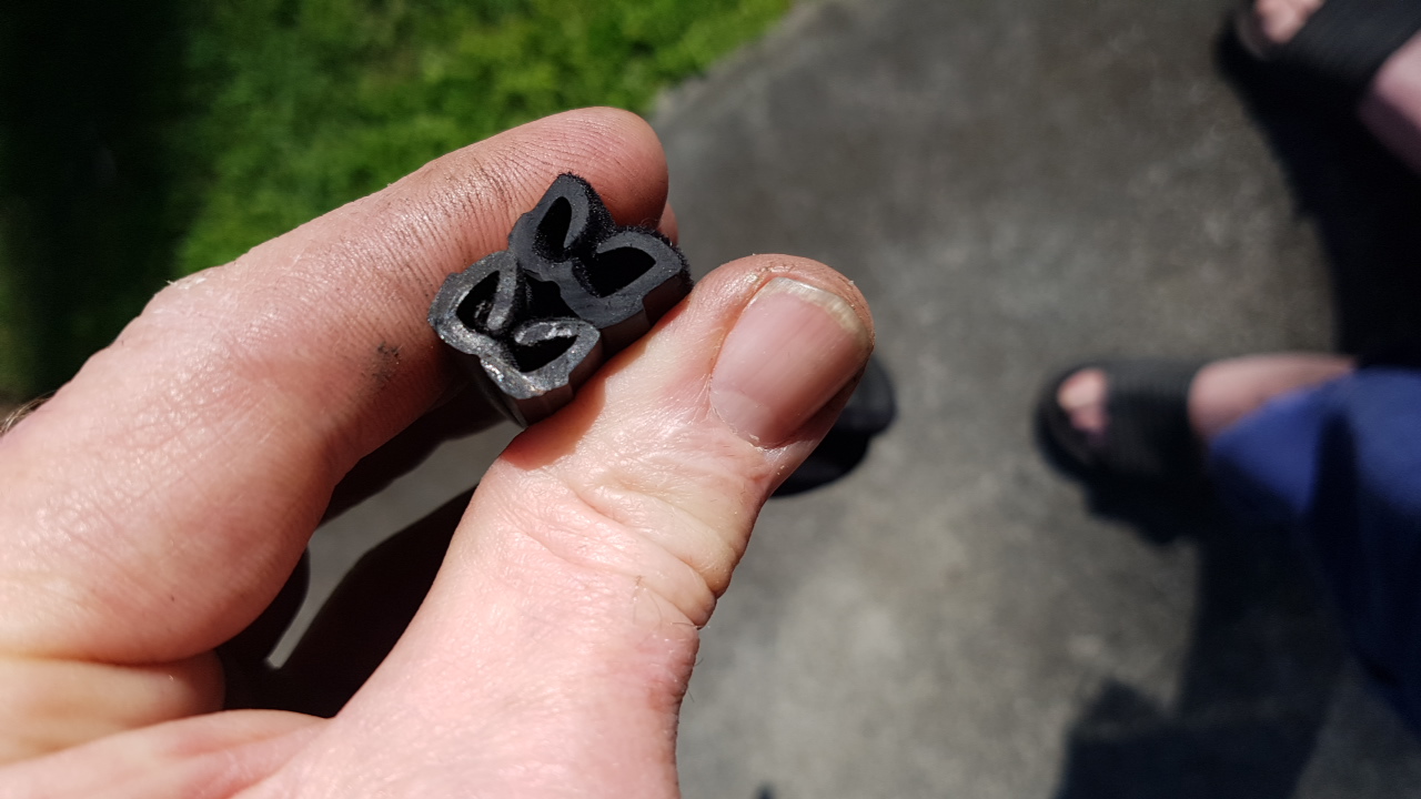

Hi all,
bought new Bailey channel from rare spares for my LJ.
When fitted, window was as tight as "F", just to push up/down by hand (no regulator fitted yet)... even with all quater glass frame screws loosened to bump it forward as far as possible, still tight.....sprayed with silicone dry lube, still tight... dont even mention Graphite powder..still tight :(
To the point pushing up on the window, literally rocks the car. Crazy.
So going back to Rares with my samples tomorrow.
The new (tight) bailey is closest to my finger tips. The older looking bailey appears thinner in Xsection.

Rares refunded my bailey rubber $$ acknowledged that what i had sent them photos of was
"Yeah mate looks different for sure bring em back and we'll refund you "
So in store Brisbane, looked at my sample to their oversize product....and opened another new bag which still appeared same oversize...
So I am just refitting my old stuff back in.

Thanks Dave, for sharing those images.
Just looking at them, i can see the used OEM piece has the outer side ridge to lock under the channel lip, and the bailey rubber does not appear a real tight fit in the channel, even though used.
Then with the repro product image, it does not seem to have a distinct outer side ridge to lock under the bailey channel lip, and still appears a loosish fit to the channel too, not excessively loose but not tight.
