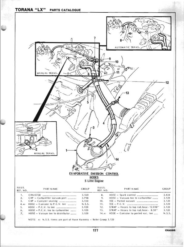

can anyone let me know where the two hoses left and right of the centre hose get connected to please.

The fitting you've got the hose connected to (not "TANK", the other one) just goes to a vacuum supply. It's supposed to draw any fumes out of the canister and burn them in the engine.
The other one ("CARB") is connected to the fuel bowl vent on anything except 5 litre cars, on Quadrajet equipped cars (ie 308's) it's blocked off.
As you don't have a carby you can safely and legally block it off as well.
Evaporative-Emission-Controls-LX-4-2-L.j
Evaporative-Emission-Controls-LX-5-0-L.j
