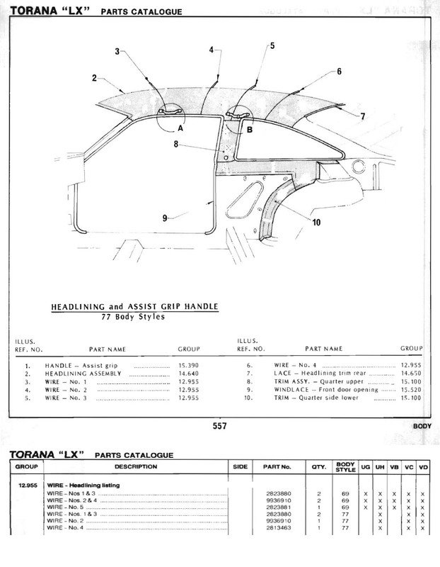

Hi Guy's,
could anyone let me know how many bows are there for the roof lining please.
One of the bows I have is about half the thickness of the other bows I have.
Would this be one of the bows or just a piece of wire.
Regards Mando.
#331 Cook
Cook
  • 1,531 posts
  • Joined: 27-February 15
Posted 02 October 2022 - 08:33 AM
Hi Jeff. I only had 2 rods and some wire in mine but I also had a sunroof. Check the holes in the inner side to see where they can be located. That should give you clue. I'm not sure but I think the "wire" runs along the very back and fits under the two tabs. Cheers Ron
#332 Bigfella237
Posted 02 October 2022 - 10:56 AM
According to the cattledog there are 4 "Wires", the first & third (counting from the front) are identical, and both the second & forth are unique...
Unfortunately I can't tell you any more as it's been decades since I've physically looked at the wrong side a Torana headlining but I'm sure somebody here will know which are which.
Edited by Bigfella237, 02 October 2022 - 11:00 AM.
#333 claysummers

#335 Heath
Posted 02 October 2022 - 04:18 PM
You should have three rods, two match and one odd one (the different length one on a hatch is not common with a sedan headliner).
The rods reach between the holes in the cant rails.
Then there are spots where the roof support/s have the row of sharp little triangles punched out, this is where the thinner wire goes.
