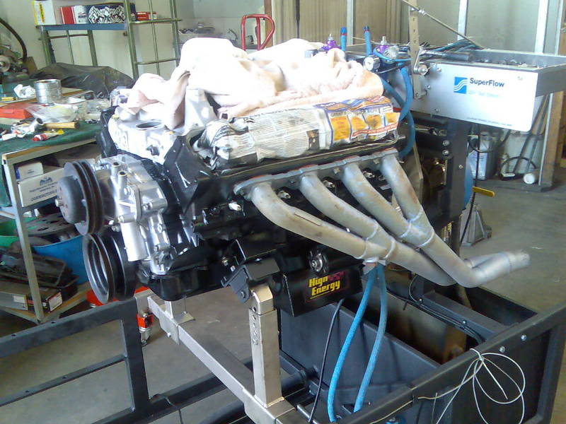

Just finishing off getting some extra bolts and stuff...Didnt have to shave the inlet..it fits perfectly...Looks like we run with Rays extractors...TNT have lost mine!!..Of bloody course!!..We should..with no more hiccups..have the HP and torque figures by Sat arvo.

Welby..Pacemaker PH5002...actually for VN with 1 3/4" primaries but are the same as my new ones which clear the sump.....if they ever get here...actually if they arrive Monday we will fit them...

Posted 14 January 2008 - 04:26 PM
They arrived...finally..
We stripped out the electrics from the Accel dizzy, recurved it,checked the weights and will use all the MSD box to drive everything.
Edited by rorym, 14 January 2008 - 04:27 PM.

443.6hp @ 6500rpm
411.9 ft/lbs @ 4600rpm. (average 396ft/lbs 3500-5000rpm)
