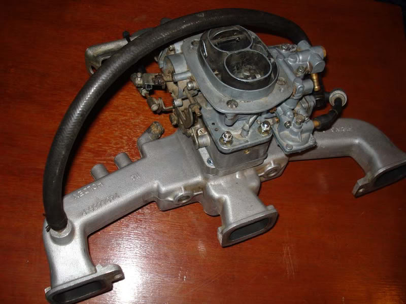

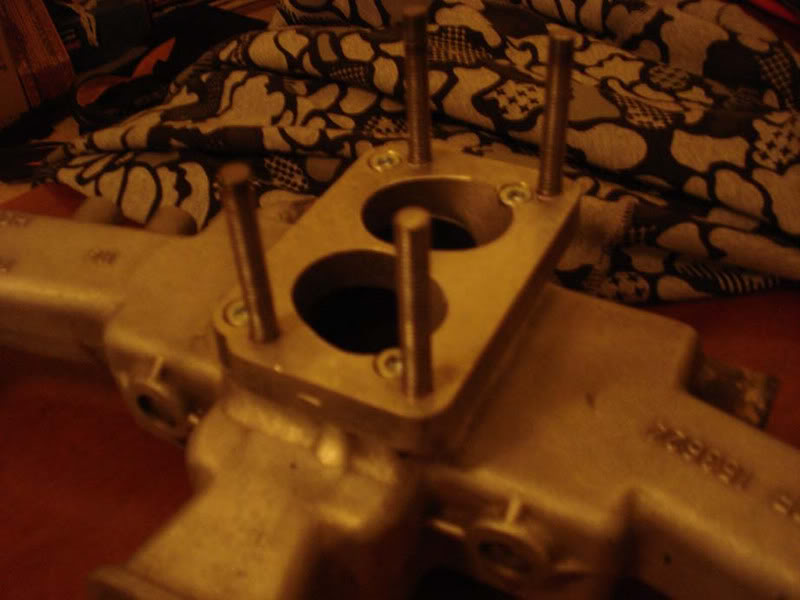

putting this on the lc over the next couple of weeks, its a 34 ADM Weber of an XF falcon, im using the 186S manifold and a redline adapter plate.
also put in a 3.55 LSD in to replace the 2.78 single spinner and added an XU-1 booster a while back to.

the weber is now all fitted up was a pretty easy conversion, changed from the old glass top petrol pump as well as it was leaking petrol a bit, also fitted up a different fuel fitting on the outlet so it would accept the fuel hose and look a bit neater. fitted up a commodore pedal and fabricated a stop for that, and a shiny new aircleaner.
anyway it goes pretty well now the single barell was really holding it back. still have a bit of work to do on the cable setup and also have to find another carby with the electric auto choke fitted and swap that over and wire it up, this carby has been converted to manual choke but it doesnt work with the torana choke cable so its easier to just fit the electric one.
anyway back on the road which is the main thing plenty of time to sort out the gremlins!

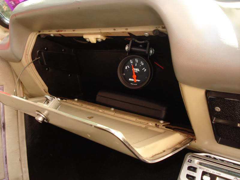

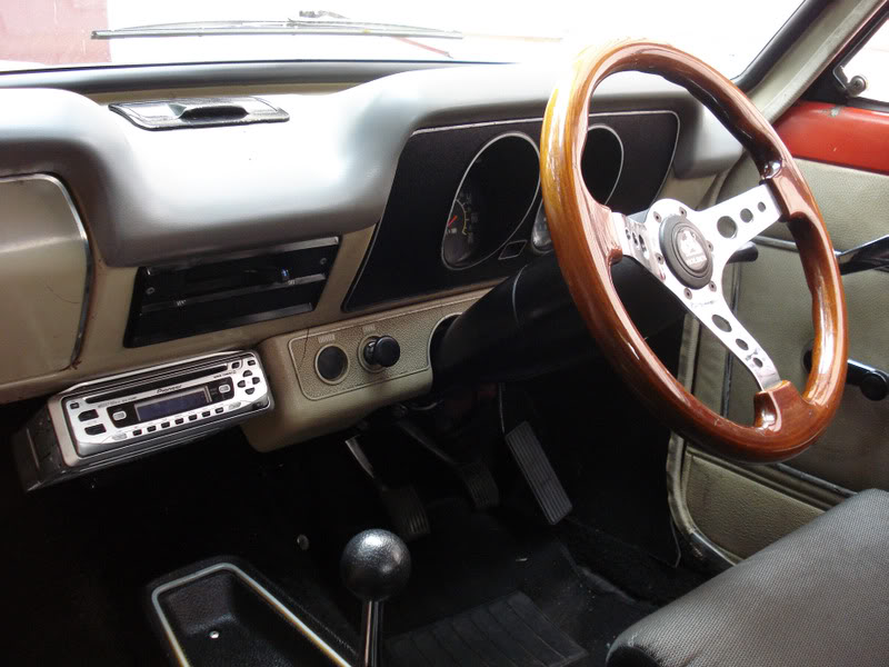

heres some pics of my new dash set up, im now running a lj gtr tacho and a kmp/h speedo.
had to cut a section out of an lc circuit board i had lying around also weld in the provision for the plug into the back of the instrument cluster so i could retain the original wiring loom.
which left me with no fuel gauge so i relocated it to the glove box and picked up a little autometer z series gauge to do the job
planning on ditching the column shift steering column as ive got a floor shift one the way from a forum member :spoton:
will be pretty much the end of interior mods for now.

nice work on the dash mate, I did exactly the same with mine.. fuel gauge in the glove box. Had to completely butcher and re-wire my original loom cause my cluster was from an LJ.
